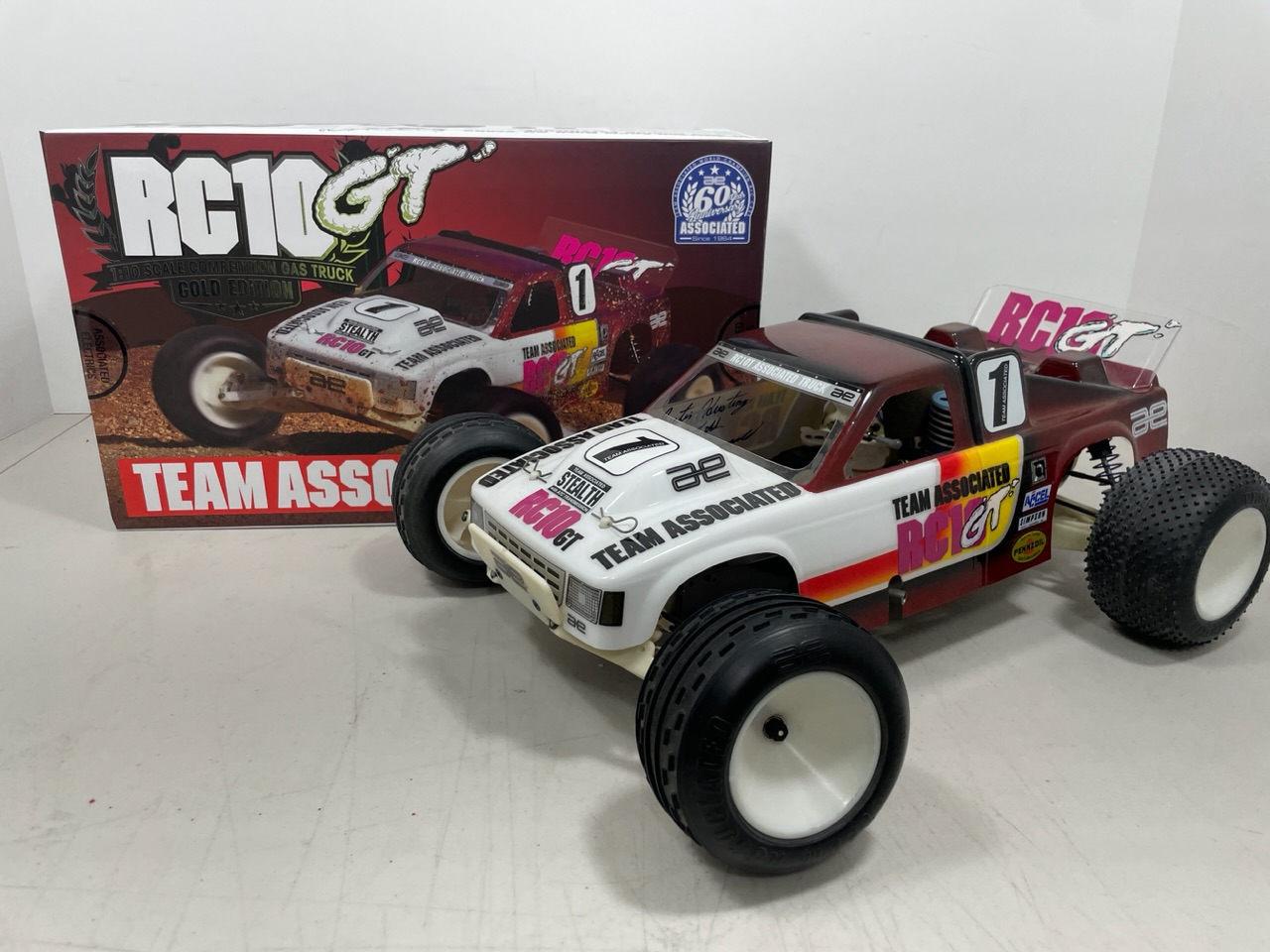

Some build progress...
And shout out to member romulus22 for hooking me up with pull start engine mounts.
