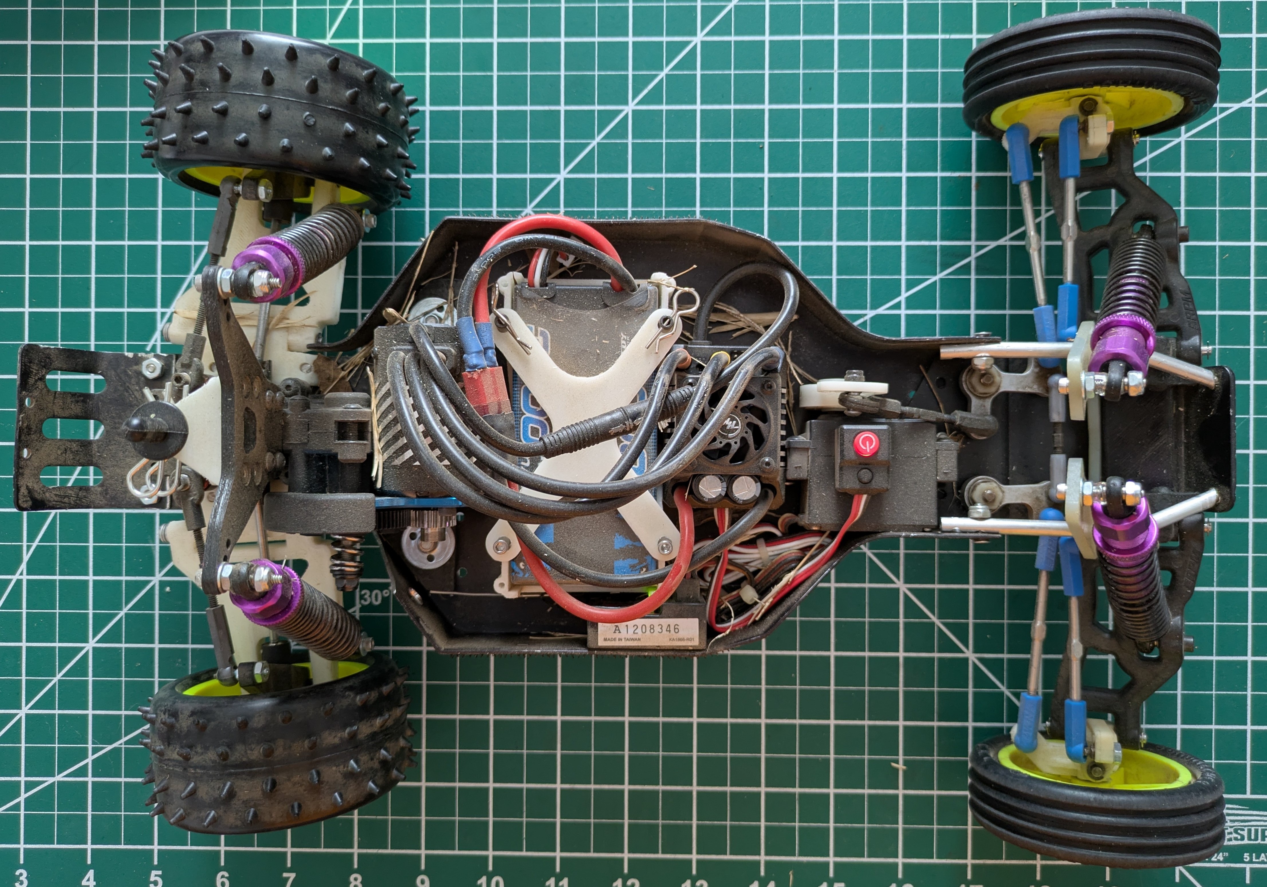

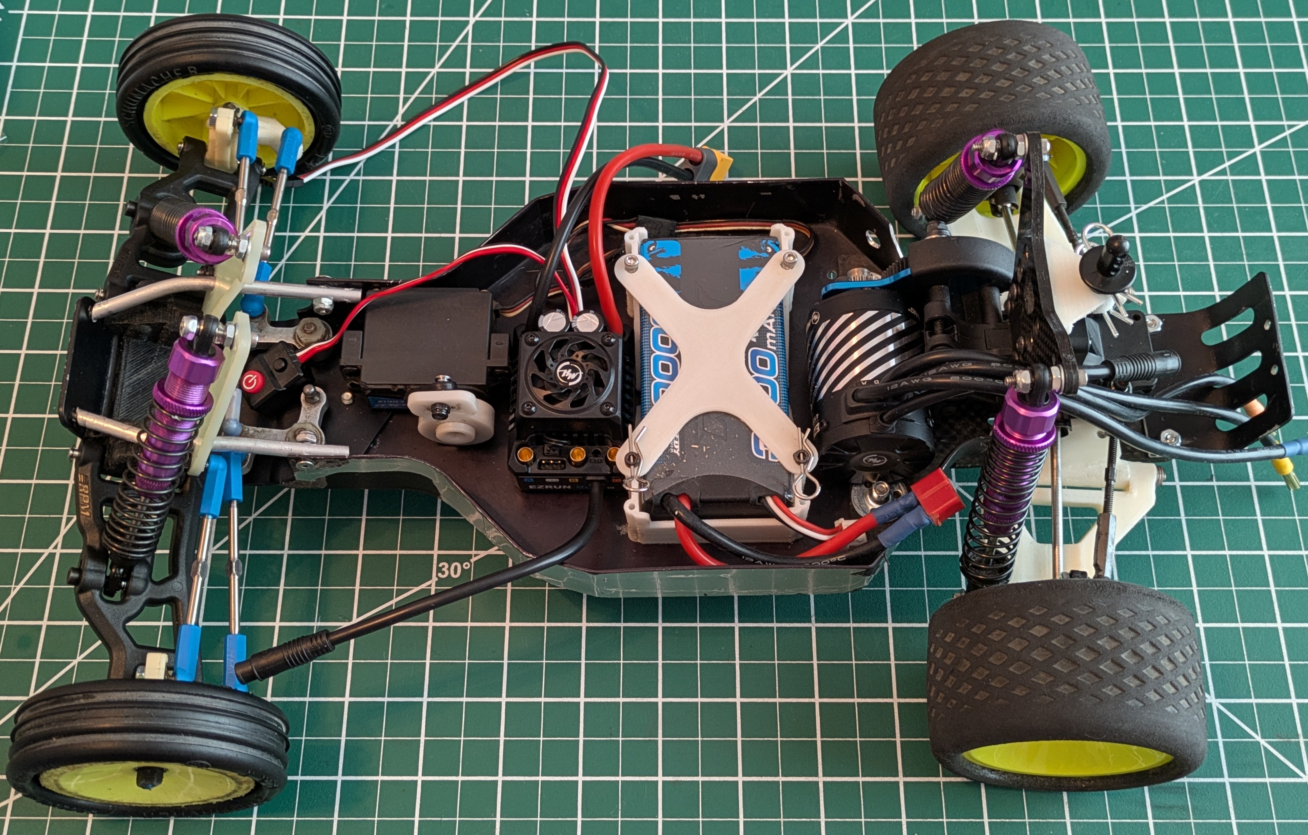

No runs yet. Need to wedge this ESC in there somewhere. If I had stayed with a brushed motor I could have easily fit the electronics but I got this deal on the brushless and I had a coupon.
- Posts: 1290
- Has thanked: 1782 times
- Been thanked: 859 times
Re: RC10 B1 Mid Motor Laydown Buggy
Doesn't that partially defeat the purpose of moving the motor forward?Frankentruck wrote: ↑Wed Mar 05, 2025 6:24 pm
Or, I could put it on a shelf back where a motor used to be...
- Frankentruck
- Posts: 3810
- Location: Texas, USA
- Has thanked: 2605 times
- Been thanked: 2979 times
Don't bother me with your logical arguments Mr. Spock1911Colt wrote: ↑Wed Mar 05, 2025 8:06 pmDoesn't that partially defeat the purpose of moving the motor forward?Frankentruck wrote: ↑Wed Mar 05, 2025 6:24 pm Or, I could put it on a shelf back where a motor used to be...![]()

If you had an "X" shaped battery hold down you could try mounting the esc to that so it would be placed over the battery, or maybe mount it on its side between the battery and servo?
- Frankentruck
- Posts: 3810

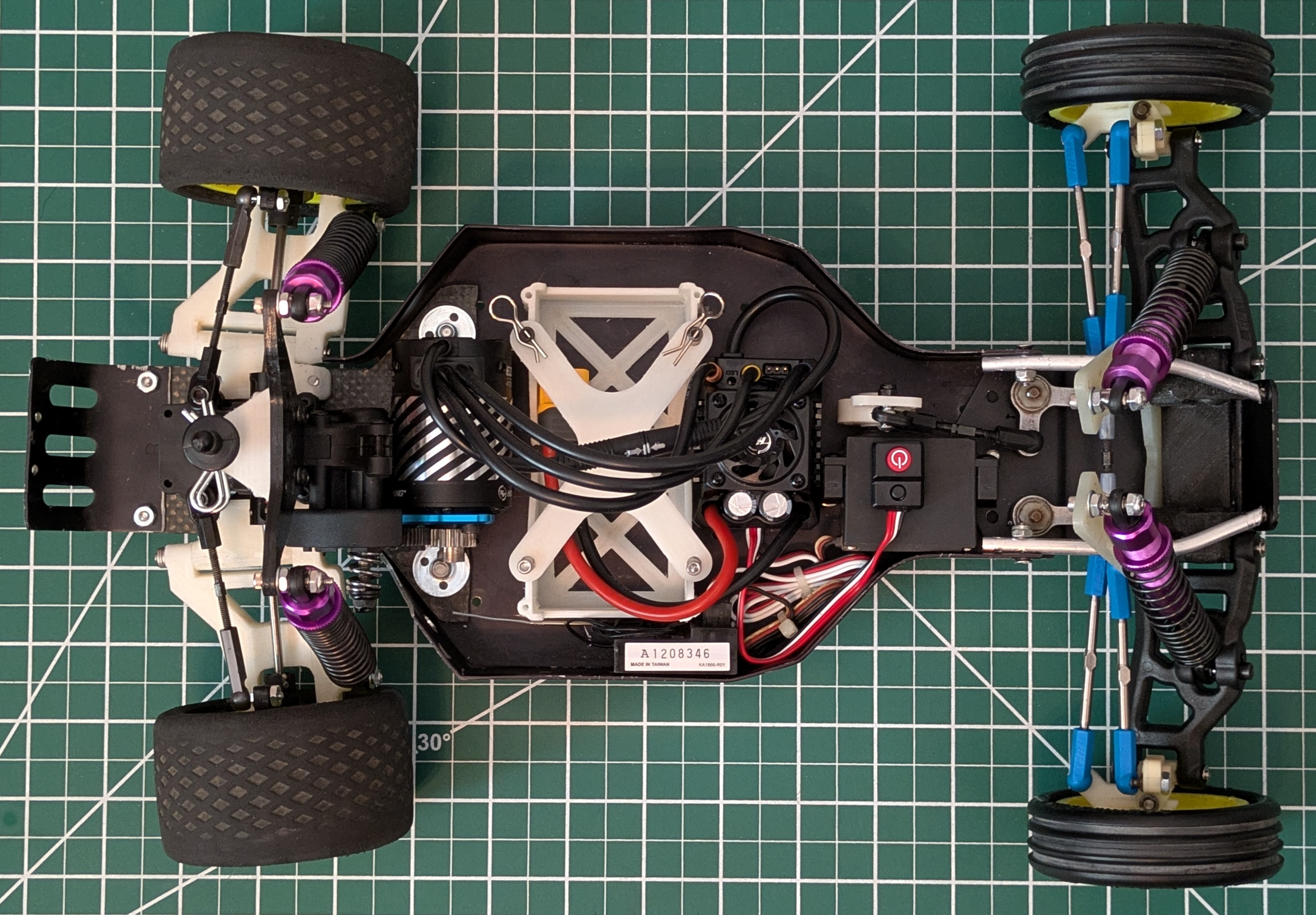

The space I need is there, I just can't use the TRX1 battery cups that I planned on. They put the battery about 1/8" too far forward. If I used a narrower servo, that would solve the problem too. I would just need to have one. I'm not putting an S132H in here though.
Would the bellcrank still clear the servo if the servo moved forward 1/4" or so?
I mean no disrespect to your chassis by drilling 2 additional holes but...
This chassis has plenty of history of being disrespected. It's not done with that either. Moving the servo forward looks possible.

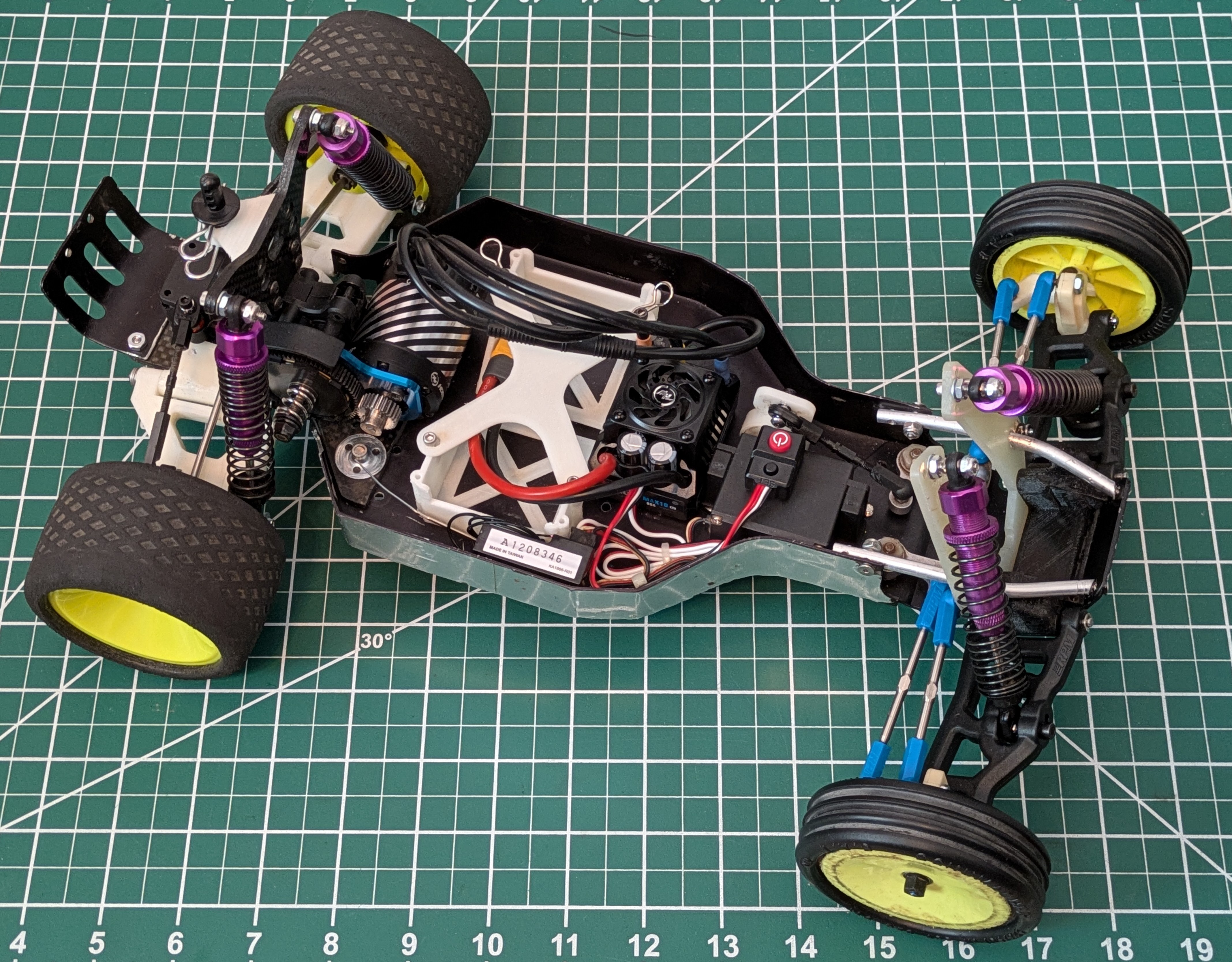

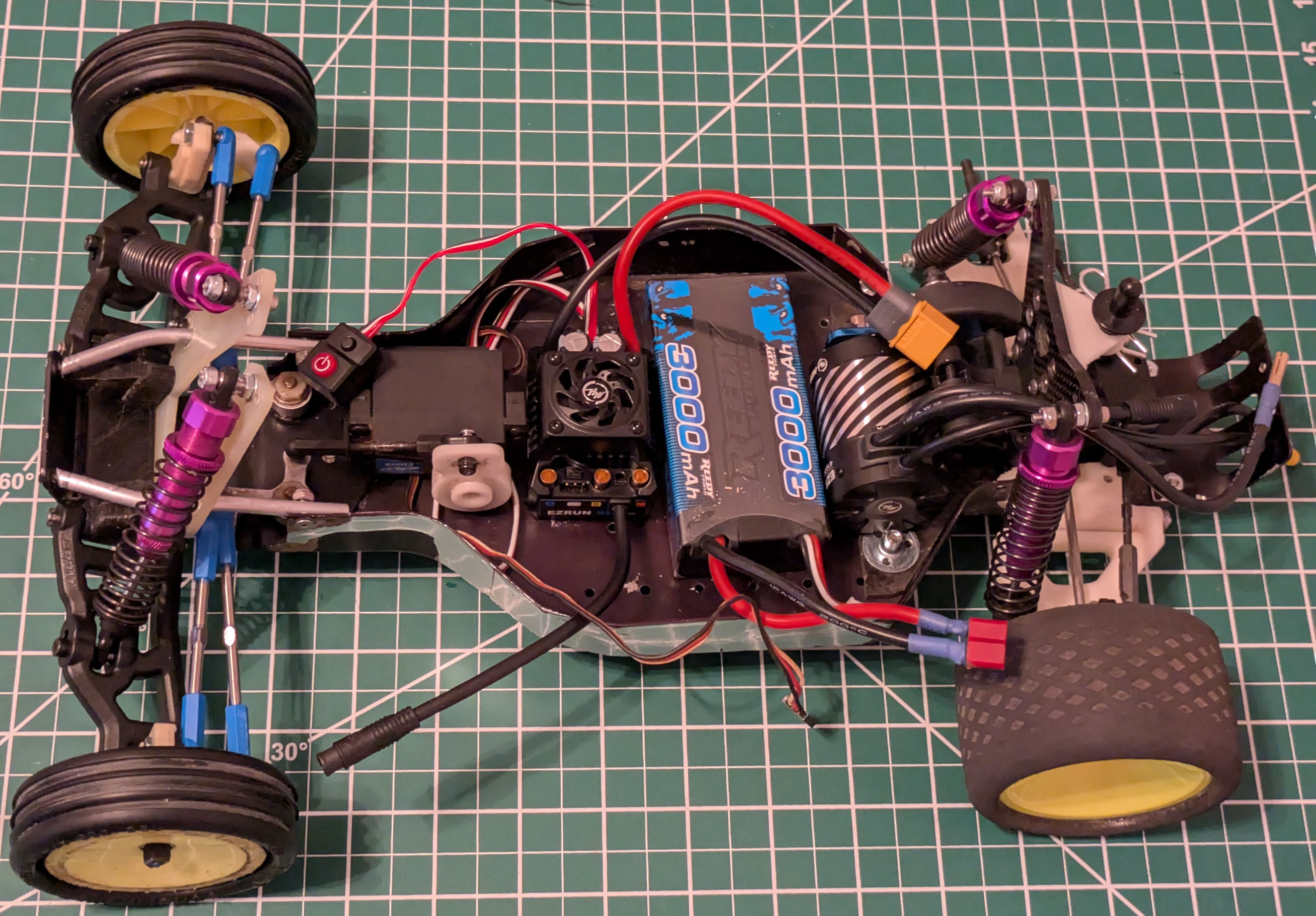

Servo moved (but moved just barely enough
) and new battery cups made (same location). They are snug, but now the electronics are coming together.
Everything tucked in well.
Look, no junk in the trunk!

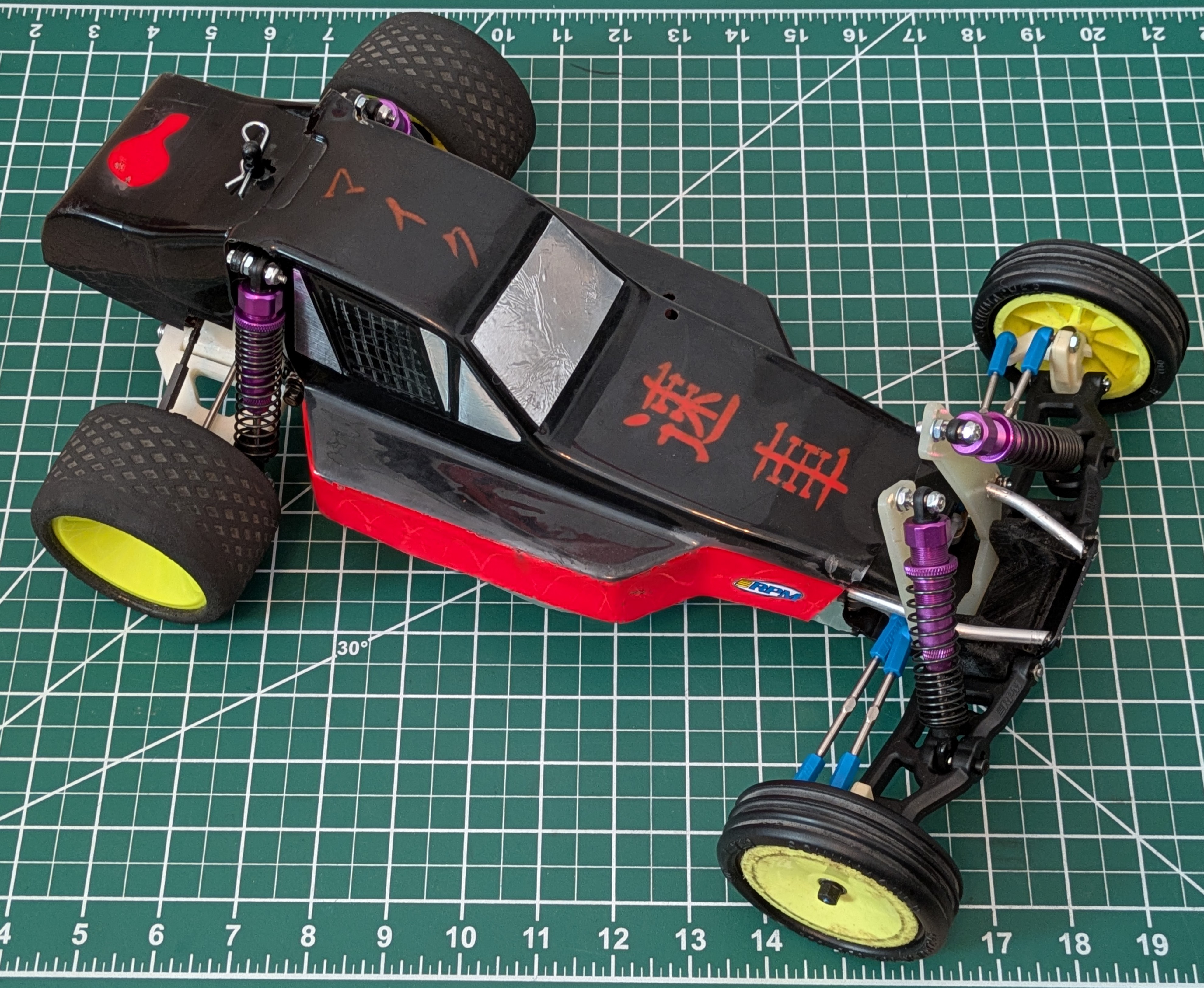

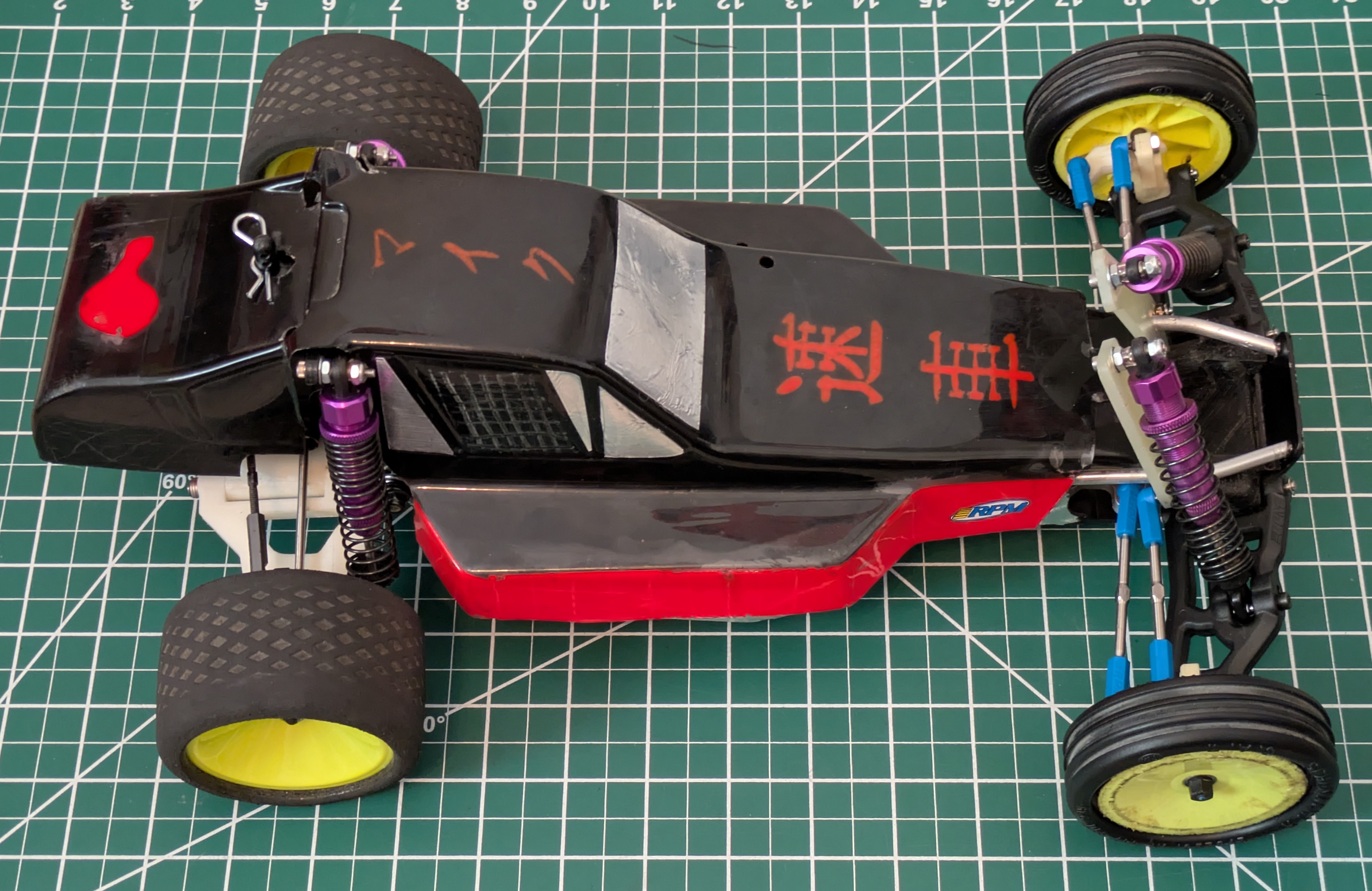

The POS of the moth brought me back here. Time for a short Japanese lesson, or in other term, why you can't trust google translate 100%.Frankentruck wrote: ↑Thu Jul 04, 2024 8:25 am Google Translate has changed what it translates to several times since I first got the body shell. It did momentarily say Mike but then changed to microphone.
Here's the breakdown of the katakana which is the characters the Japanese use to emulate the sounds of other language's words.
マ = ma
イ = i
ク = ku
Maiku
The Japanese language doesn't really accommodate for having a consonant at the end of words, other than "n" so they often add what is felt to be the closet sounding vowel to the end. Knowing this you're left with "Mike", which google translate seems to have a brain mannerism and can't fathom it being a name so it thinks it's talking about a Mic and in turn tells us "microphone".
Real question is, "Who's Mike and is this a fast car?"

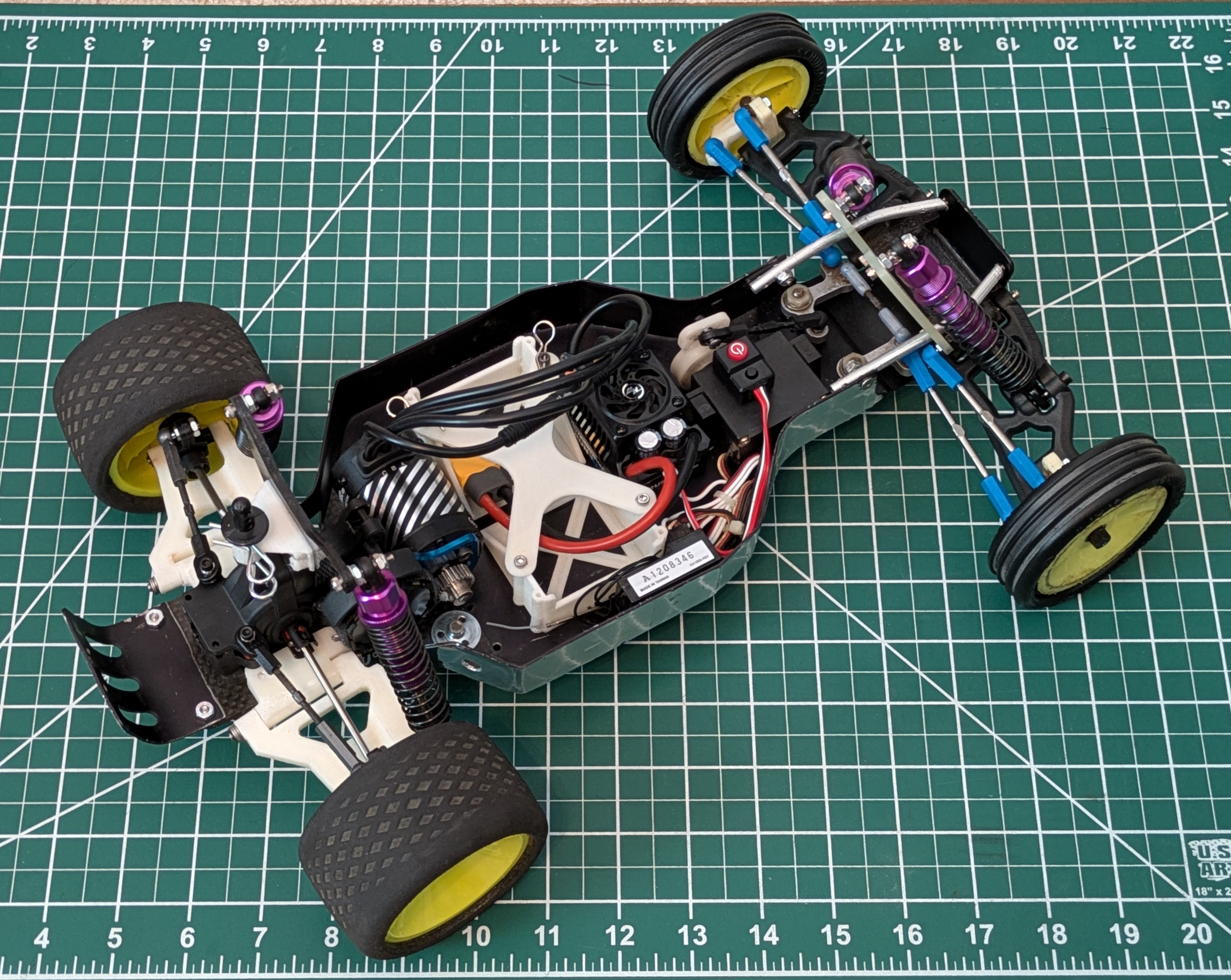

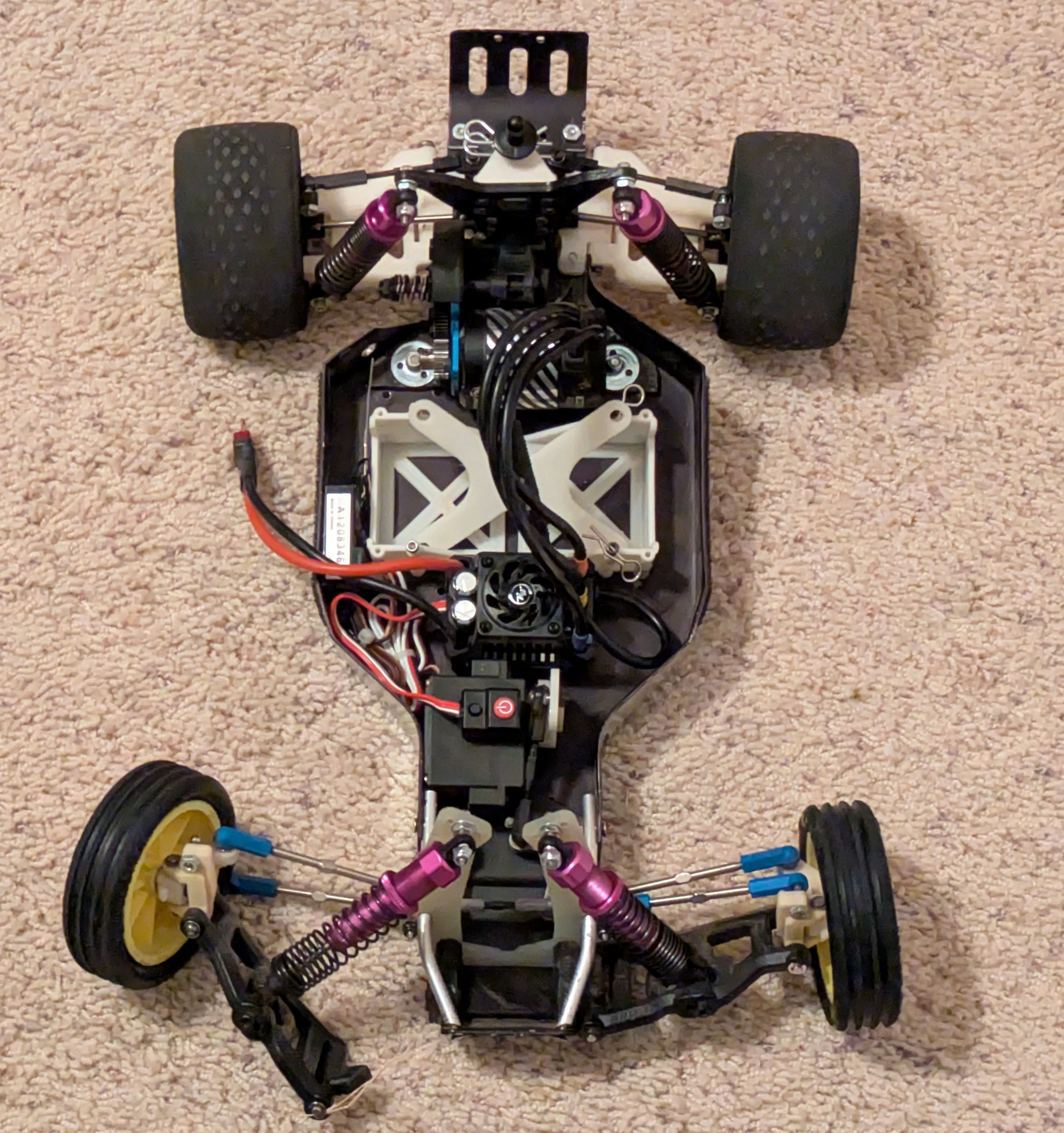

Video added of first run. It would almost run on the grass with street tires so I changed over to some spikes for a few passes across the lawn. The front end surfs over the grass.
https://youtu.be/jbBMHtxUxZI?feature=shared
On pavement, it seems like I need to get more weight on the rear wheels to help traction. Steering twitches result in instant fishtailing. It seems very similar to my RC10L. Hooking up the rear tires on pavement with any attempt to accelerate seems like a lost cause. But there is that spot I could add weight to the back ....

Do you know if the red shape on the back of the body has any significance? Maybe it means 'good luck, you're gonna need it' ?
- RogueIV
- Posts: 1165
- Location: W. Mass
- Has thanked: 2139 times
- Been thanked: 1100 times
I'm no professional. But I took a look around and I think it's a "hyotan" or bottle gourd which seems to be a symbol of good luck.Frankentruck wrote: ↑Mon Mar 24, 2025 8:40 amDo you know if the red shape on the back of the body has any significance? Maybe it means 'good luck, you're gonna need it' ?

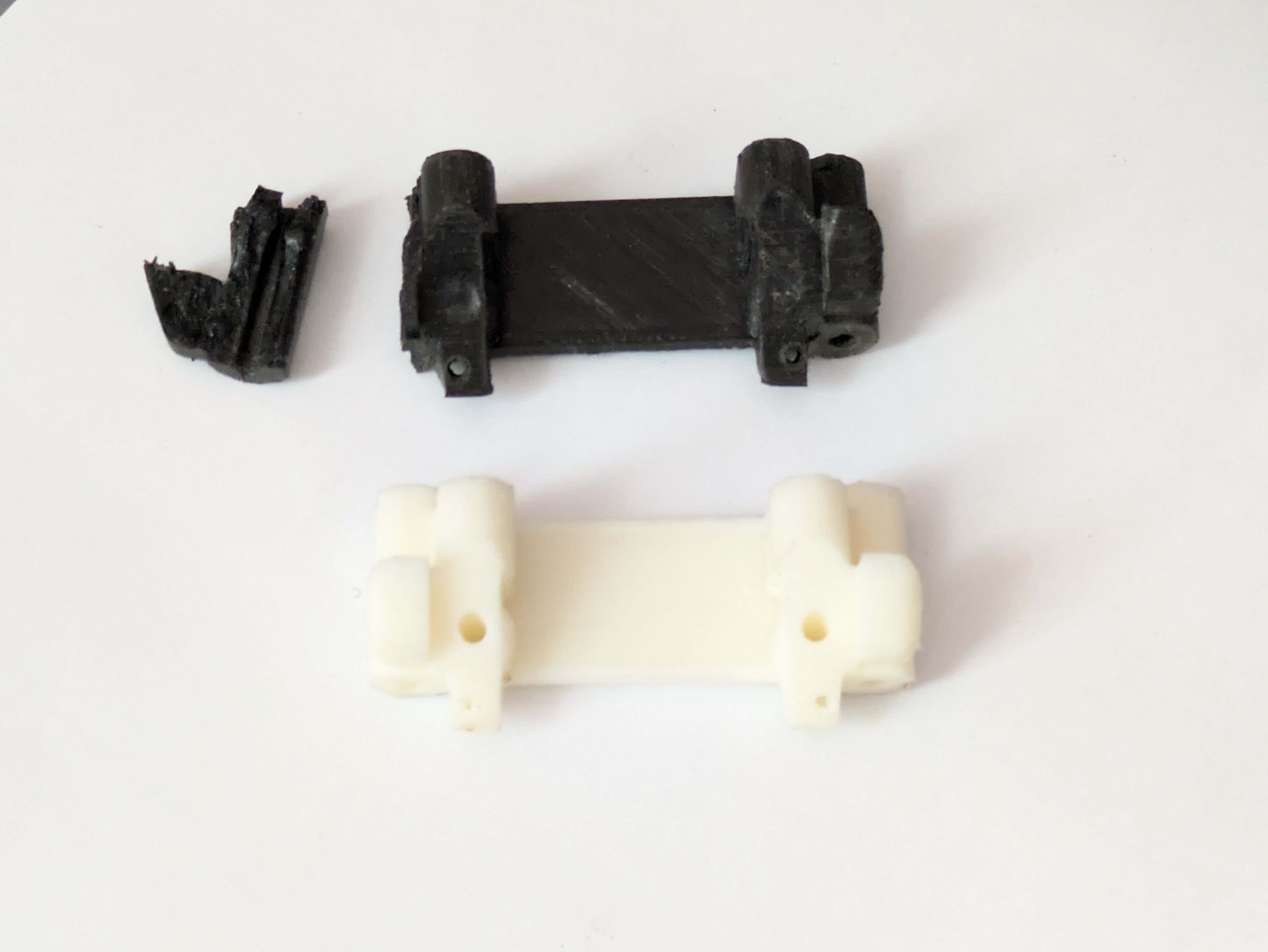

A friend with the right Hobbywing tuner card adjusted the ESC so that it's a much better runner without spinning out immediately. It really flies down the street now. However a high speed cartwheel through the yard took care of the front bulkhead. I have better material to print from now, so I think the replacement will be tougher. Maybe it will last for 2 cartwheels!
Maybe I should add a brace across the front hinge pins too.
