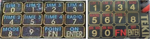

There definitely were changes. The 410K doesn't have the exposed FETs that the Mach 7 has.

Yes, there are obvious differences between the mach 7 and the 410K. But history tells that when Kevin Orton (Tekin) saw the mach7, he hired its maker, Noel Lovisa, to develop something like it for Tekin. But there are rumors that the 410k didn't come to market the way Noel intended, but Kevin reworked the thing to his specs before it went into mass production. I'm interested in the differences between Noel's 410K and the mass production 410K. Well, I assume there is no documentation on prototypes of the 410K, so it will remain a secret. If you compare the keypads of the mach7 and 410K, you can see the relationship. The ENTER key is used to switch the 410K on and off. The designation has been changed from ON/ENTER (mach7) to OFF/ENTER. Who thought of this?
