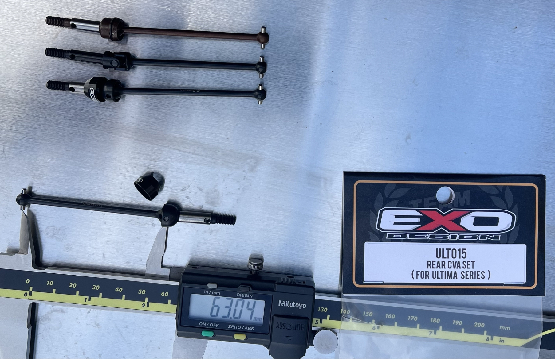

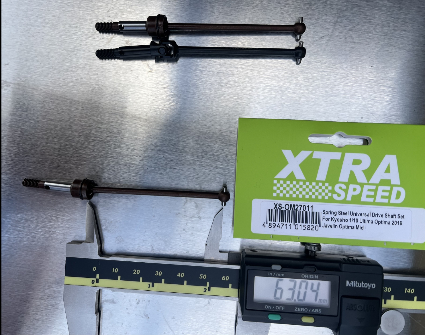

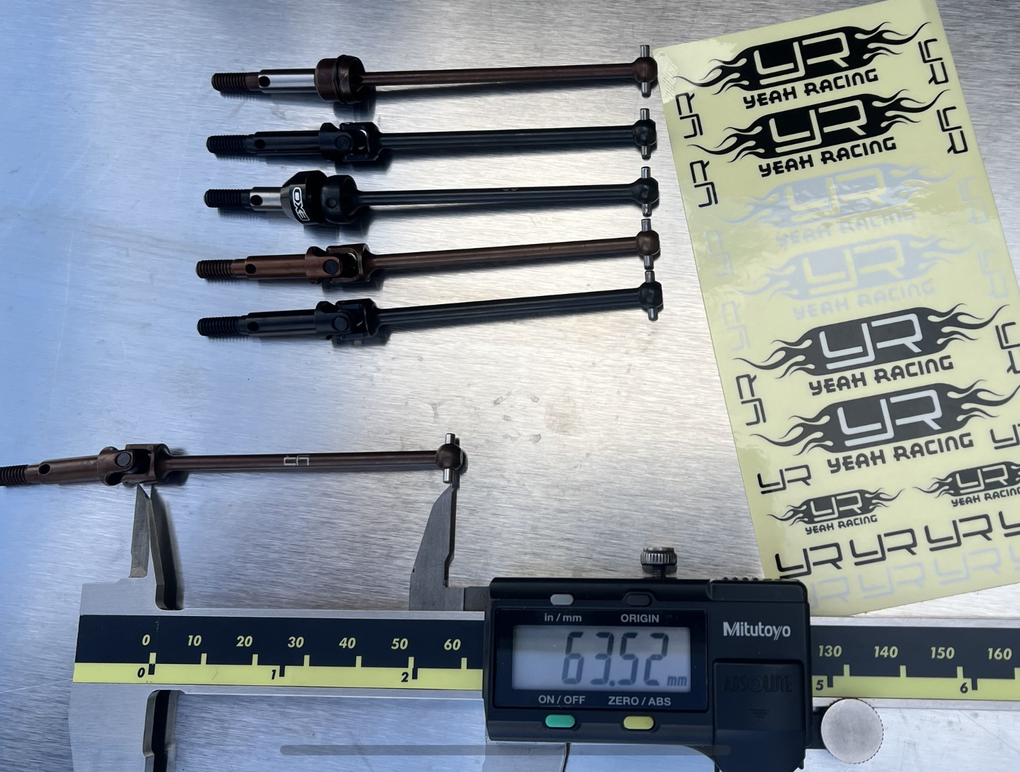

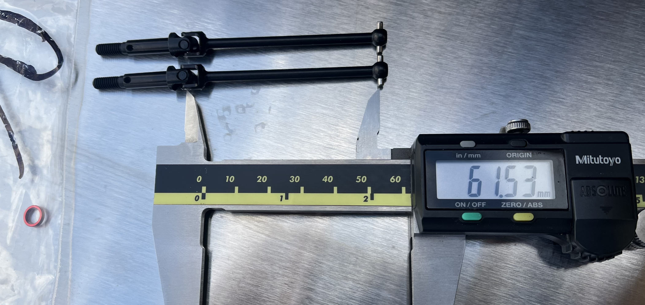

Great work guys! :D I also have a Raider that is not moving due to a broken dogbone.
Have the following axles to compare/Pics Added:
-Kyosho re-re 87 WC/JJ Ultima CVA's 61.5mm
-Yeah Racing Optima Mid axles from alloy hub conversion (KYOP-019SP) 63.5mm
-EXO Design Ultima CVA's 63mm
-Xtra Speed CVA's for re-re Ultima (Xtra Speed PN: XS-OM27011) 63mm
I’ll throw one of these Xtra Speed axles in and see how it looks.
JJ Kyosho 61.5mm
JJ Kyosho 61.5mm
Yeah Mid 63.5mm
Yeah Mid 63.5mm
Exo Ultima 63mm
Exo Ultima 63mm
Xtra speed 63mm
Xtra speed 63mm

rknize wrote: Mon Apr 07, 2025 11:39 am Looks like they are 61.5mm:
I had a feeling that was the case. Are you using the red spacer? The stock outdrive spring?

The red spacer is a bit too wide if you want to use the Optima hex adapter: the bearings are spread a bit further apart in the upright, I guess. I used a few shims instead and ended up putting them on the inside. I suppose a different hex adapter might allow for its use. Either way, you have some wiggle room to play around with to get the joint to best align with the steering king pins.

The Xtra Speed OM27011 say 63mm on them, so I decided not to try them. I wonder if they have interference issues on the non-Mid/Turbo/Pro Optimas? An extra 1.5mm might be OK on a Raider, though.
