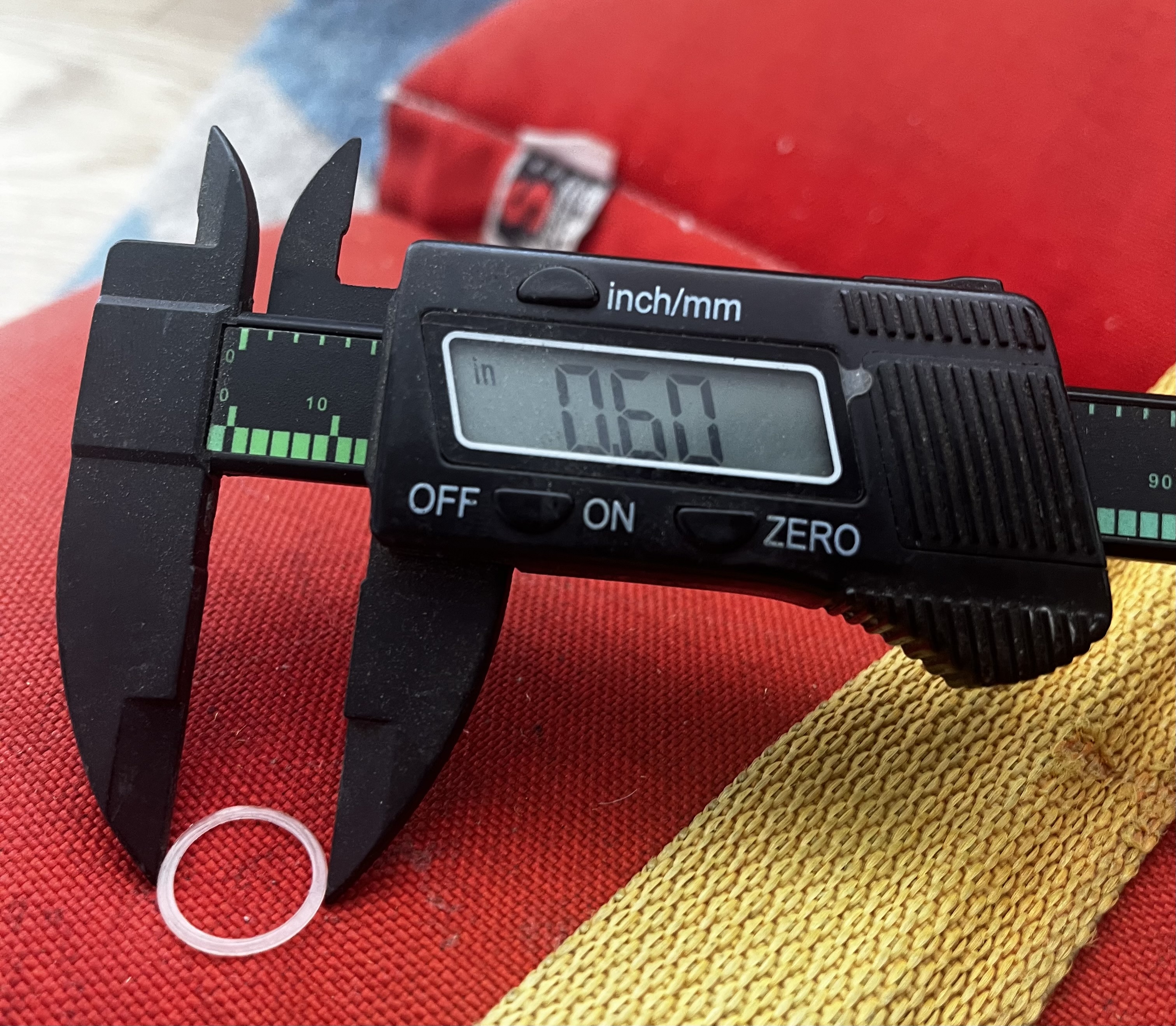

The one I have is .5” inner diameter 0.6” (15.4 mm) outer diameter.
Closest OD from McMaster Carr metric
https://www.mcmaster.com/90940A115/
I'm not exactly sure what these are made of.
It looks like from this reference. The gasket size is 014, maybe 112
Like a few of the early associated parts, airplane parts supply seems like a source
https://skygeek.com/mil-std-ms28774-014-o-ring.html

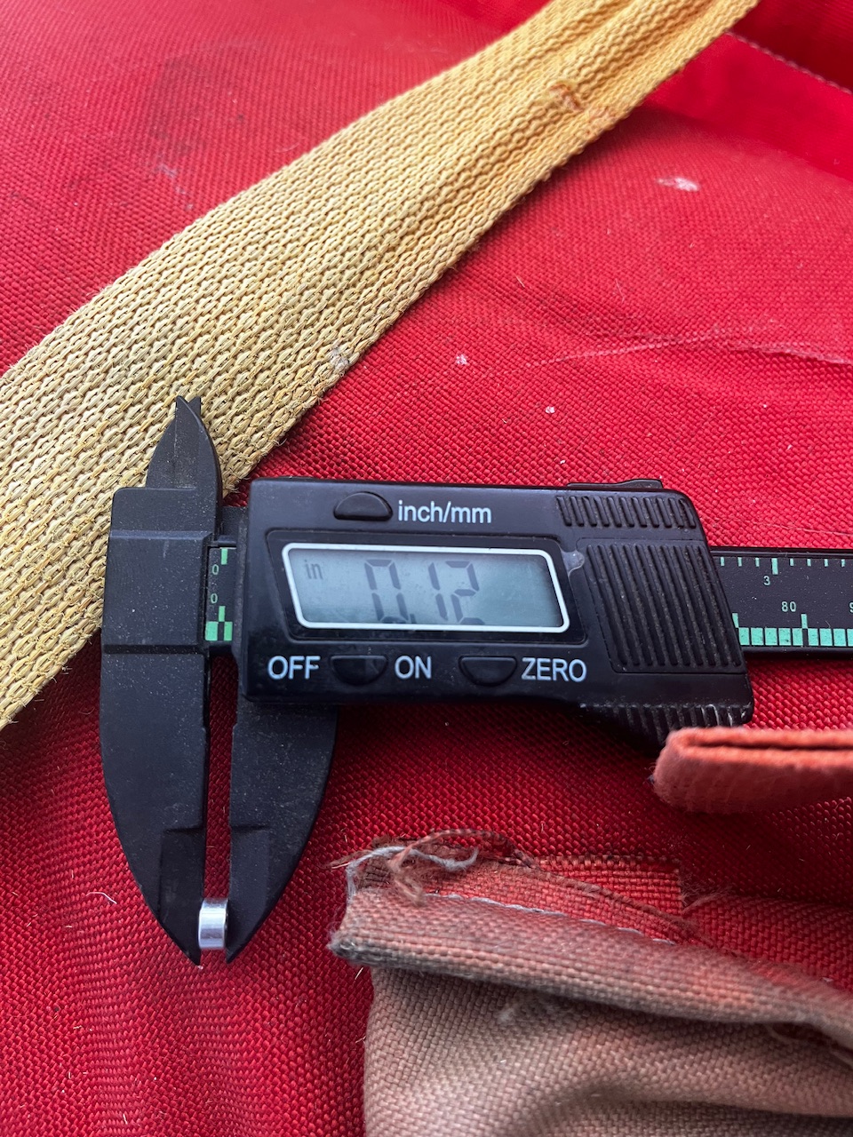

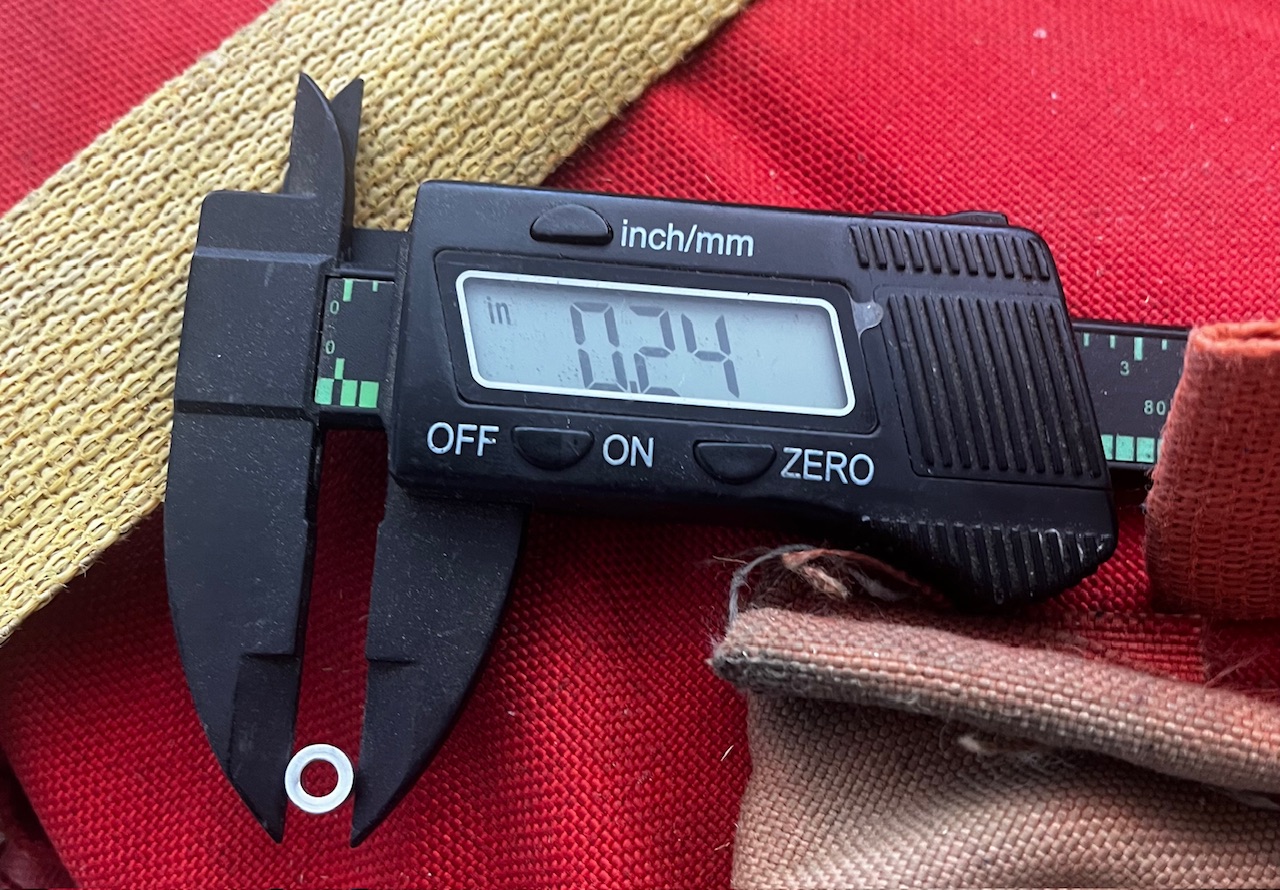

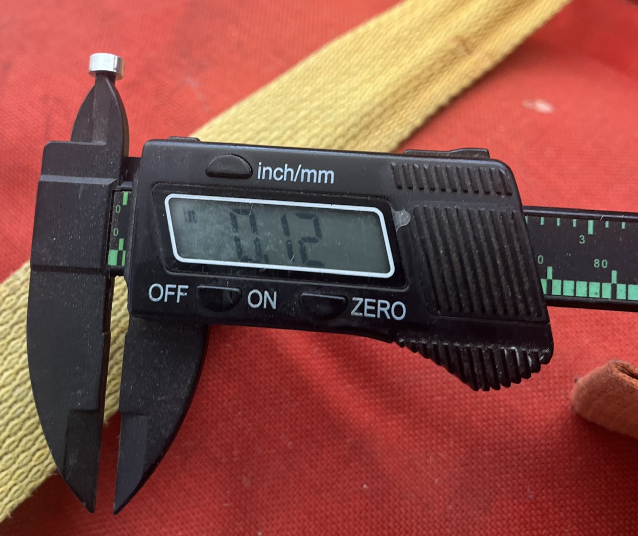

Shock spacer
Id 0.12” od 0.24” height 0.24”
Id 3.1mm od 6.2mm height 3.1mm
I added the metric to see if the caliper revealed more accuracy

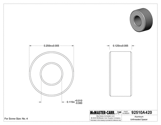

Closest McMaster Carr part in inches
https://www.mcmaster.com/92510A420/
