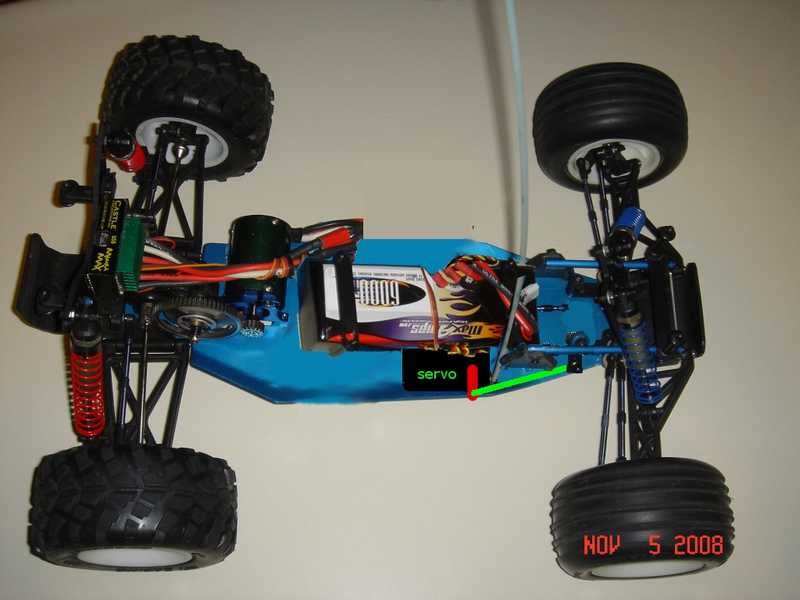

I did a little testing and regular bodies just aren't gonna look right. There is too large of a gap between the chassis and the bottom edge of the body. Looks kinda stupid. Oh well, thanks for the input anyway. I'll update when I get a hi-speed video. the gearing will have to be crazy, but I have a solid 250yd clear piece of smooth asphalt here at work. Heat will be an issue the way I plan on gearing it, but I can make a couple of safe passes I think. After that I'm switching to a Feigao 3900kv or so motor and will go back to these big tires for some monster truck action. Or I could just take out a second mortgage on my house and get a Savage Flux. :shock:

I really like the GT conversion.
Here's a "gimped" version from one of your pictures. That is how I would setup a GT ´conversion
Changes:
- at least one longer nose brace tube with tube mount moved to the back
- reversed servo saver horn
- a standing servo, probably much further back than shown since there's so much weight up front anyway
- and of course the battery positioned as shown
I actually did not bid on a complete (rtr) GT today that sold for €58 just because I already have enough projects going on the as it is. ... come to think of it that was really stupid of me, I probably could have sold the radio, engine etc. for close to that price, oh well.
hope you like my suggestions.
my suggestion of a setup
