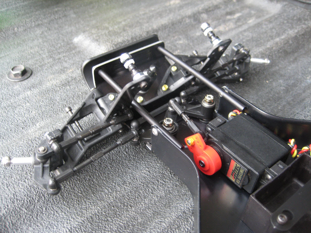

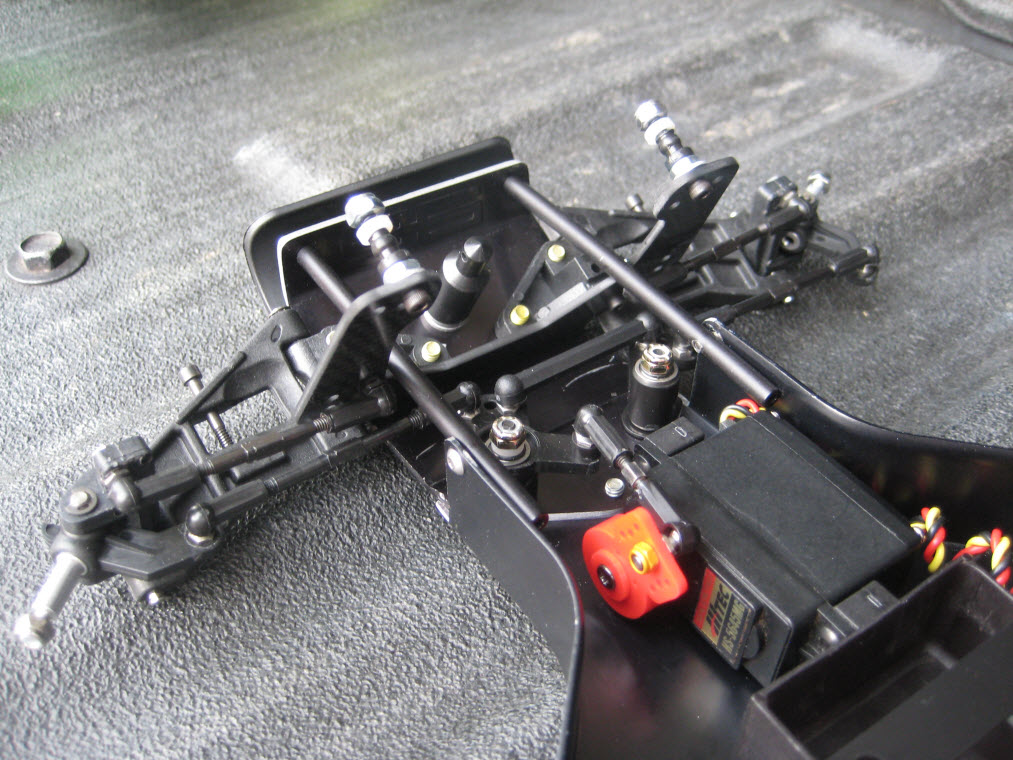

i will take some pics with mip steering, then i will put the b2 steering back on and then take the comparitive pics
i will use photoshop to do an overlay/multiply merg of the two photos.

Re: Associated RC10 Ball Bearing Steering Kit
top one is mip steering bottom one is b2
the chassis on this car has been trimmed to let the arm stick out
notice that the inside is at different angles but the out side is the same...... what do you guys think?

Does it do that in both directions? Hard to tell for sure, but it looks like the crank arm is making contact with the center link.

crank arm still has about one 1/8" left before contactaeiou wrote:Does it do that in both directions? Hard to tell for sure, but it looks like the crank arm is making contact with the center link.
and yes it does in both directions, not as bad this way tho
i am using outer b4 parts... are the steering arms a diff length on a b2????

i think the problem with lowry's car is using the b4 steering knuckle in conjuction with this bellcrank setup. the ball stud seems too far back.

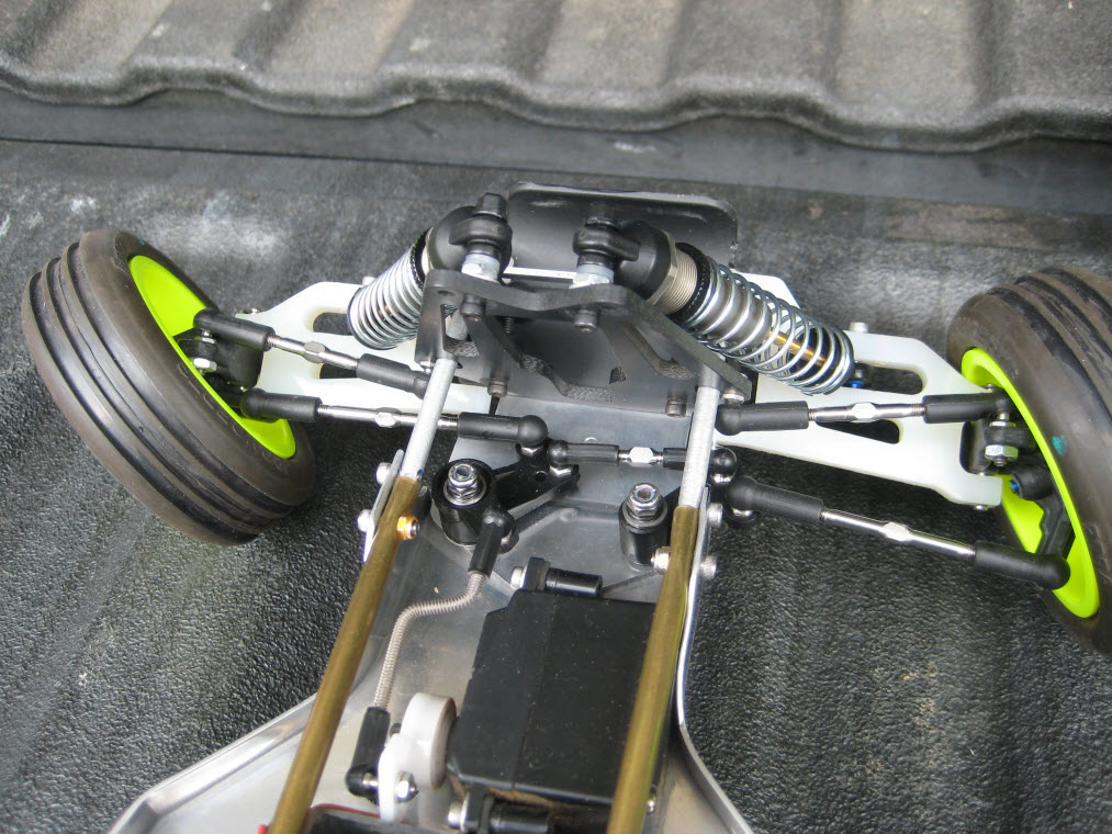

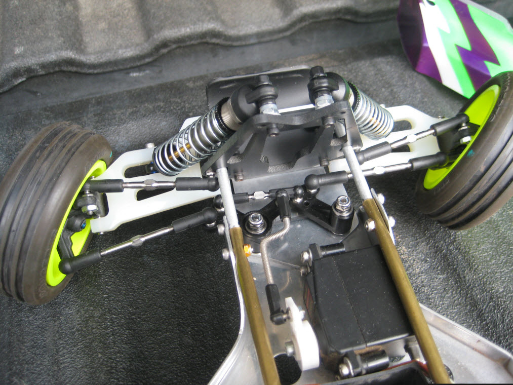

Here's my original old/new runner. It uses B4 front end parts and the Dynotech arms. I dial out a tad of steering on this one because the wheels rub the front of these beefy arms otherwise. This is a newer team car runner build where I trimmed some of the chassis, versus notching out the bell cranks. Standard RC10 front end parts on this one. Hopefully, these shots will help anyone who's having setup issues.
