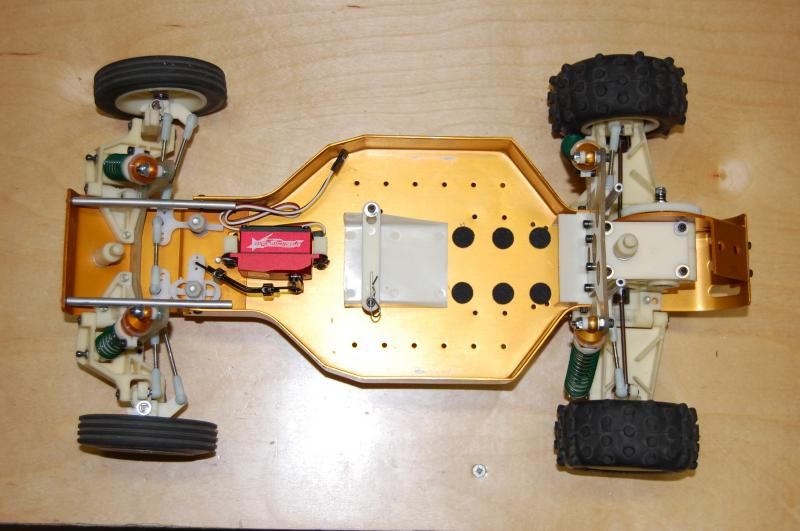

Post by GodSpeed »

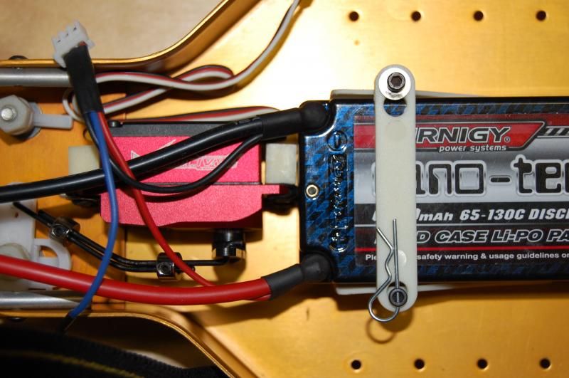

New pictures --
Unsure of ESC layout --

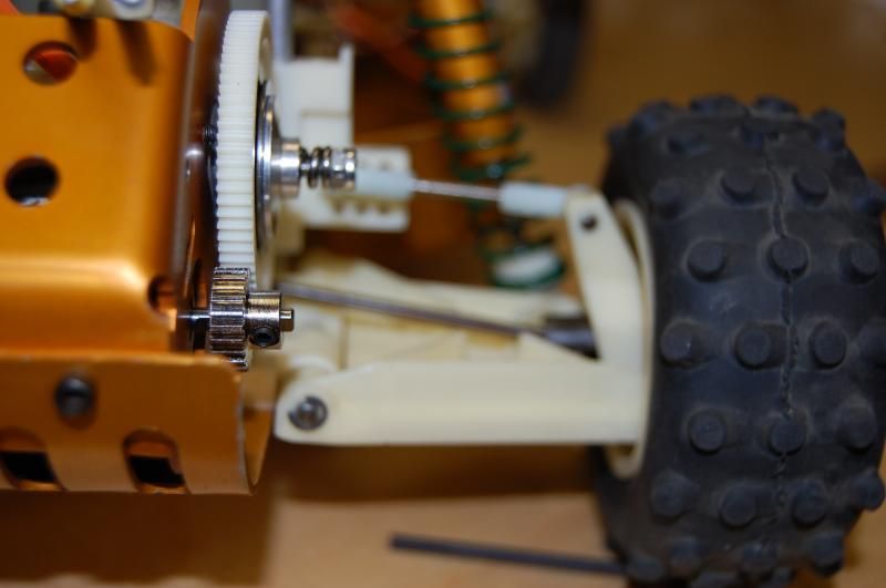

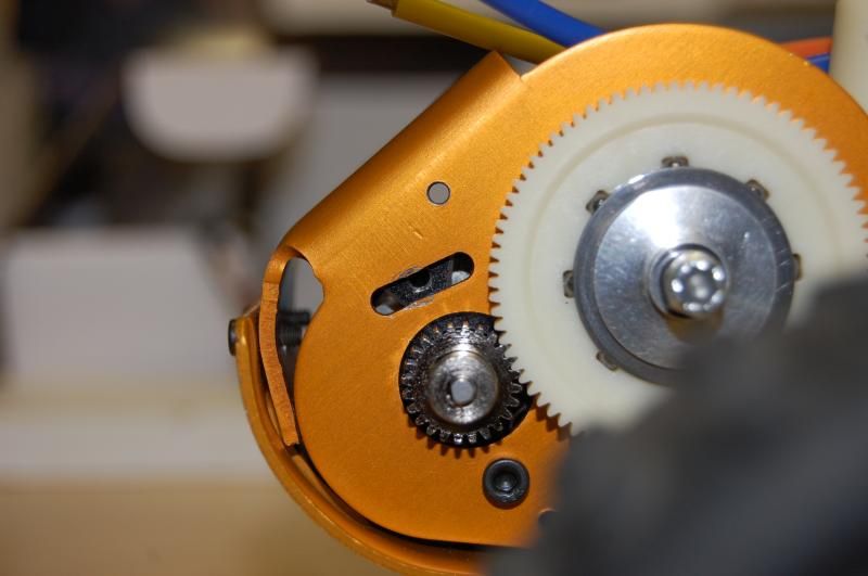

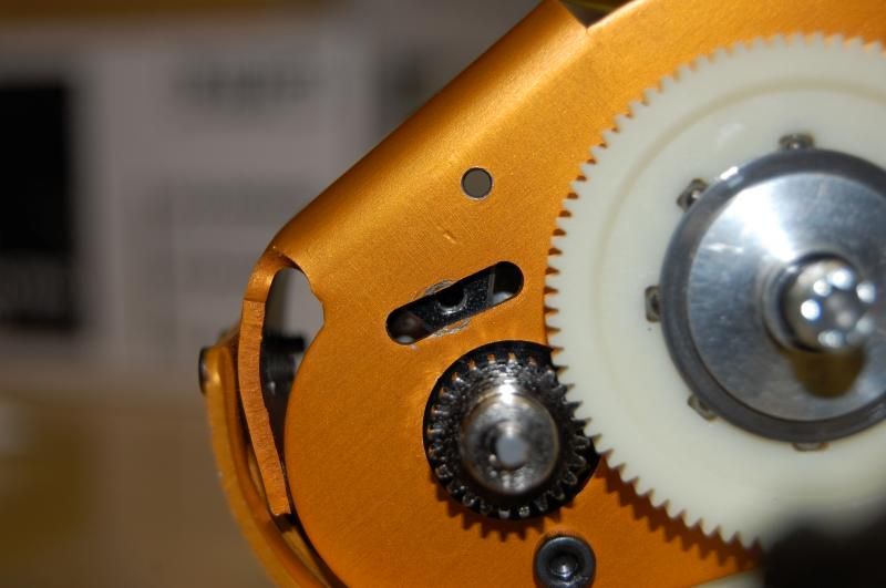

Anyone ever have a hell of a time rotating the motor into place for proper pinion/spur gear mesh???
I've got a Reedy Sonic 540 Mach 2 and it seems like the barrel diameter is 10ths or 100ths of a mm bigger than the hole spacing making it so I can't rotate the motor into place.
Am I doing something wrong?
I feel like I'm going to have to somehow shave the adjustment slot (top motor mount screw) in the motor plate wider.
WTF?
It might be hard to tell, but the screw hole on the motor does not line up close enough with the slot to go in --
Posts: 12336
Been thanked: 3919 times
Re: Help Me Rebuild My Original RC10
I can't say I've seen that, but you might either make the lower hole larger (easier!) or use the other lower motor hole, which will clock the motor a bit, then use the other top hole which even though it isn't in alignment should be a better spacing
Like this:
Code: Select all
 O     X
    O
 O     X
GodSpeed
Posts: 278
Joined: Thu Jan 23, 2014 12:14 pm
Location: Burlington, ON Canada
Post by GodSpeed »
Weird that you haven't seen this. I haven't been able to stump you yet! haha
I wonder if it's the motor or the plate?
The lower motor hole in the plate is a smaller hole and it's definitely further away than what currently is the problem. I don't think that would work, unless I'm not understanding you clearly.
Making the lower hole that I'm currently using would definitely be easy. That might be the solution, or I'll just drill the upper "slot" wider in the exact location I need. That should be easy enough too.
How tight should I have the mesh? Obviously forcing it together is illogical, but should it be "tight" or should I leave a little bit of play? How much?
Thanks again.
