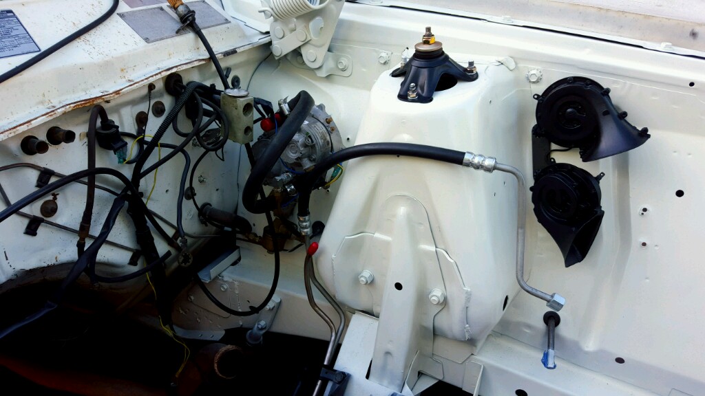

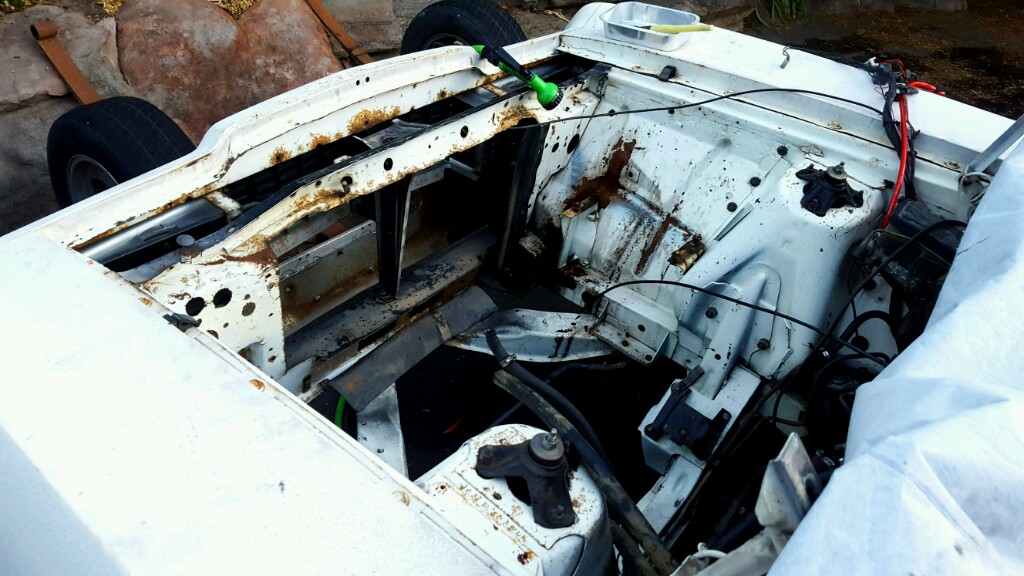

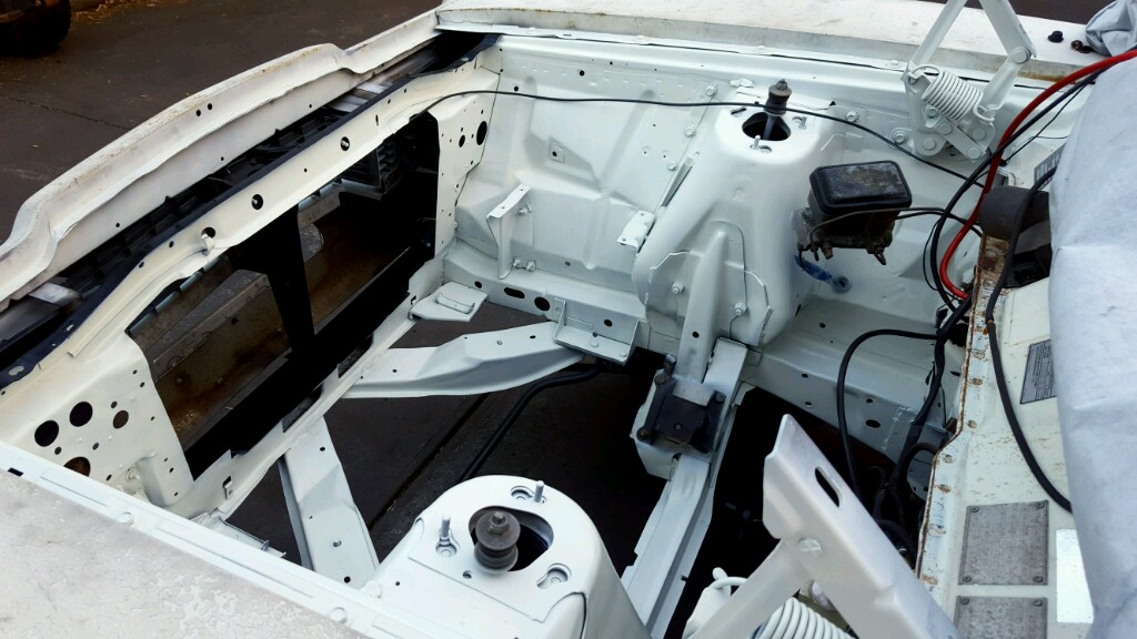

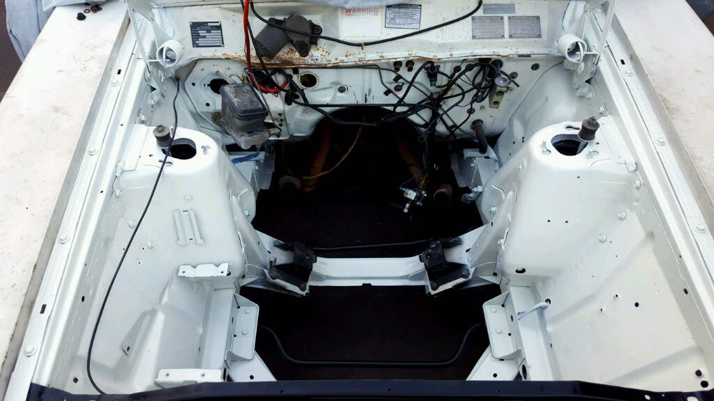

I painted the engine bay today, just gotta let paint cure for about 6 days then I'll shoot it with a chemical resistant clear. In the meantime I'll rust convert the join at the firewall and etch it.

That's a great improvement...great before/after shots!

definately an improvement. Getting closer to dropping in the engine.

Just have to love a cleaned up engine bay!
Looking good!
Looking good!

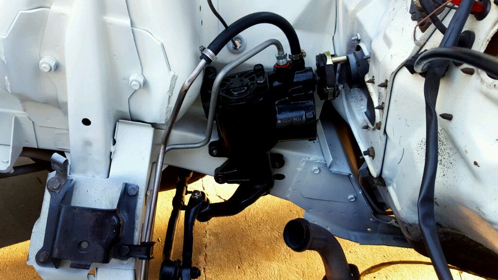

Starting to put it all back together now. The power steering lines were a real PITA. Having a tight steering box again is nice. Hopefully it drives a new 39 year old car.

Much more fun to work with a clean and painted engine bay

Tell me about it
The sticky greasy goo was not fun. Installing nice clean new parts is fun

RC10th wrote:Having a tight steering box again is nice.
THEYTOOKMYTHUMB wrote:Nothing like a nice tight box....
We all know it will happen....

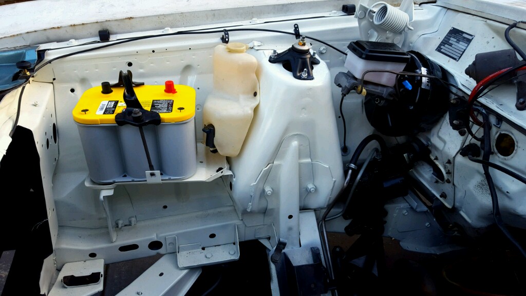

After a bit of a side track I'm back on this. I've mounted the new booster and new master cylinder. I've also made up some lines to bleed the cylinder and now just need to bleed the brake system. I also bought a new Optima D34 yellow top battery.
Next up after the brakes are bled, finally drop in the engine and bolt the hood back on.

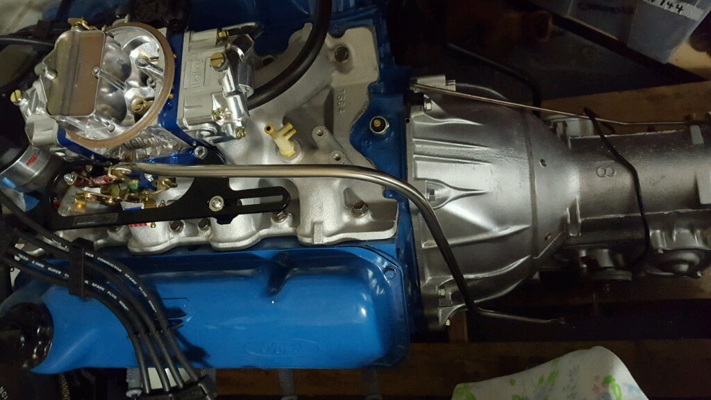

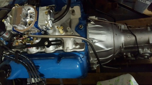

Got the brakes bled and lines flushed today. I also polished up the wheels and lug nuts a bit since they have been sitting over a year while the wheels were off.
I also installed and adjusted my custom stainless kick down rod.

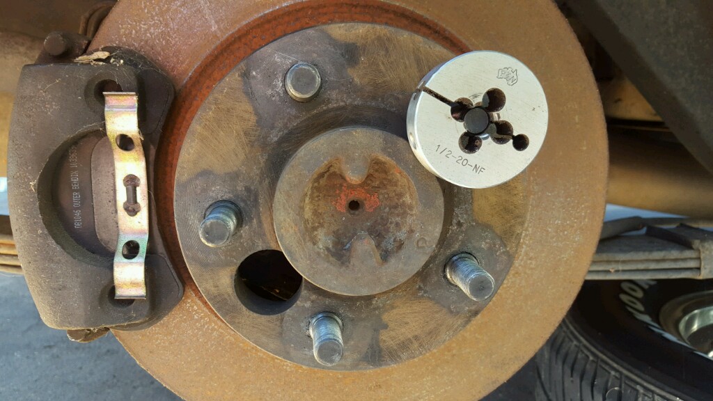

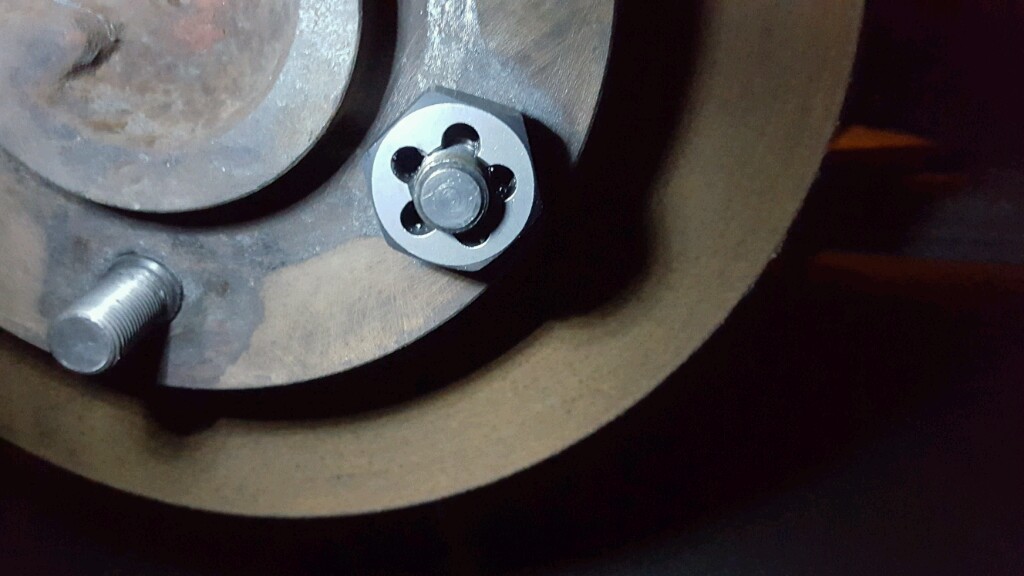

Not really a big deal but I repaired a rear stud that had two damaged threads. Of course the first die I borrowed didn't fit so I had to specially order one in.
It's one of those little jobs that should have only taken 5 minutes but took a few days to sort out
The days are also getting shorter now so I'm glad the bulk of work is behind me.

Wow...you went the extra mile. I would've pounded it out and picked up another stud for it at the auto parts store for $2 and been done with it but then again thats just me
