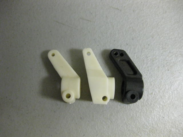

fredswain wrote:Shapeways messed up my order. These are from the NIX91-Complete Set1 SLS order. What doesn't look right here? The parts that aren't pictured are correct. I got two sets of duplicates and am missing two parts. The steering isn't really a problem since these aren't the race steering parts but the lack of a right side steering upright is annoying.
i'm sure you'll have time to get it squared away before jake starts to ship the chassis kits out.

fredswain wrote:Shapeways messed up my order...
I'm sorry to hear that. First time actually. You should contact customer service. I'm sure you'll get things sort out...

At least I have spare parts!

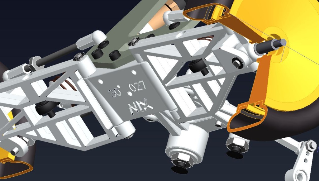

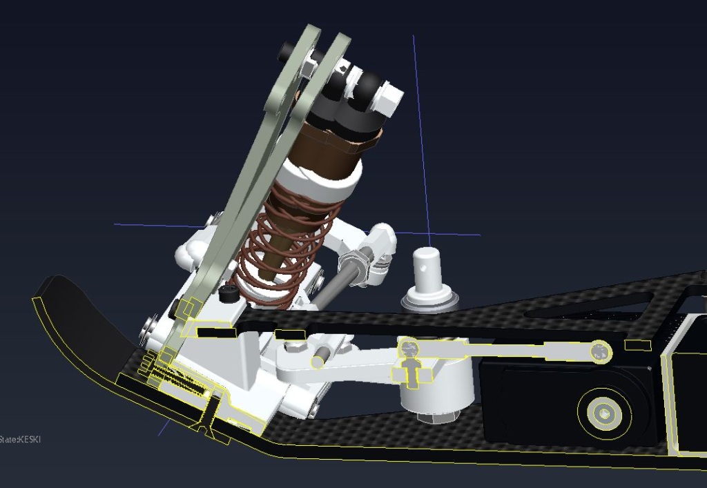

New part (optional):
NIX91-027 Front bulkhead (30* on 25* kickup)
http://shpws.me/wgmb
Shock upper mounting point moves backwards 7mm.

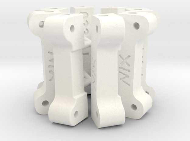

includes:
NIX91-001 Rear arm mounts, left and right (1.5deg toe-in/side & 3deg anti-squat)
NIX91-031 Rear arm mounts (3deg toe-in/side & 1deg anti-squat)
NIX91-032 Rear arm mounts (3deg toe-in/side & 2deg anti-squat)
NIX91-033 Rear arm mounts (3deg toe-in/side & 3deg anti-squat)

Are the castor blocks at 0 degree to the hinge pin?
original 25 degree bulkhead gave 25 degree castor, 30 degree bulkhead will give 30 degrees castor?

Yes, steering block carriers NIX91-007 and NIX91-008 have zero degree angle compared to hinge pins. Front bulkheads NIX91-022 and NIX91-027 make caster 25deg or 30deg.

Could you put the right side steering carriers back up on Shapeways so I can order them? My order came with 2 lefts. I just want to order 2 rights to have complete sets.
