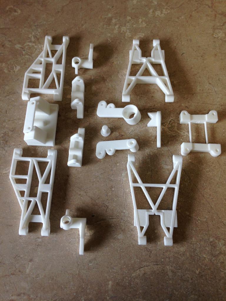

I used super diluted Rit dye to achieve the nylon look on my car. I conducted research through the Rit dye website which shows custom colors to find the shade that was close to what I needed.
I ended up mixing 1/8 teaspoon of yellow dye with 2 cups of water. Heated the mixture to approximately 180 degrees and dunked each shapeways part in the mixture for three seconds. Cold water rinse immediately then compared the shade to the AE parts.
If I do it again I will do a mixture of 1/16 teaspoon of yellow and 1/16 teaspoon of tan. The key to doing this is having a super diluted mixture that allows you to dunk the parts and then check the shade. You do this in increments to keep from over doing the color. The shapeways parts do take dye very easily.

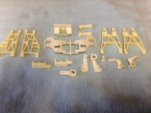

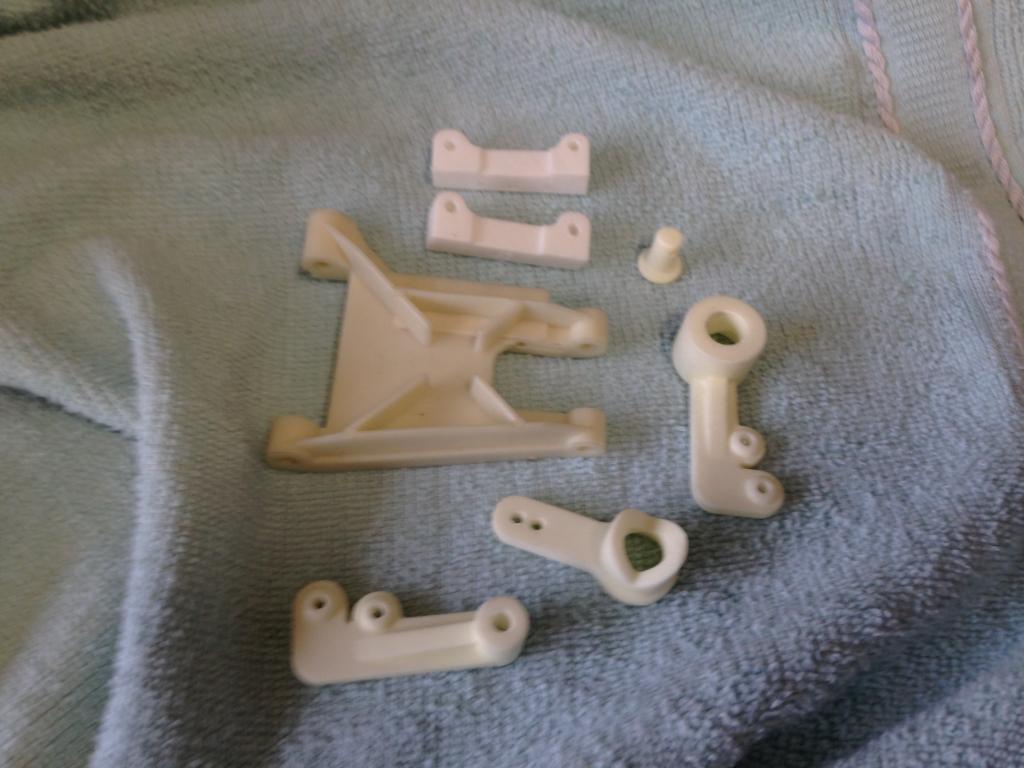

Arm Mounts as they arrive, steering dyed, original arm for comparison
And the final parts with ReRe arms for comparison

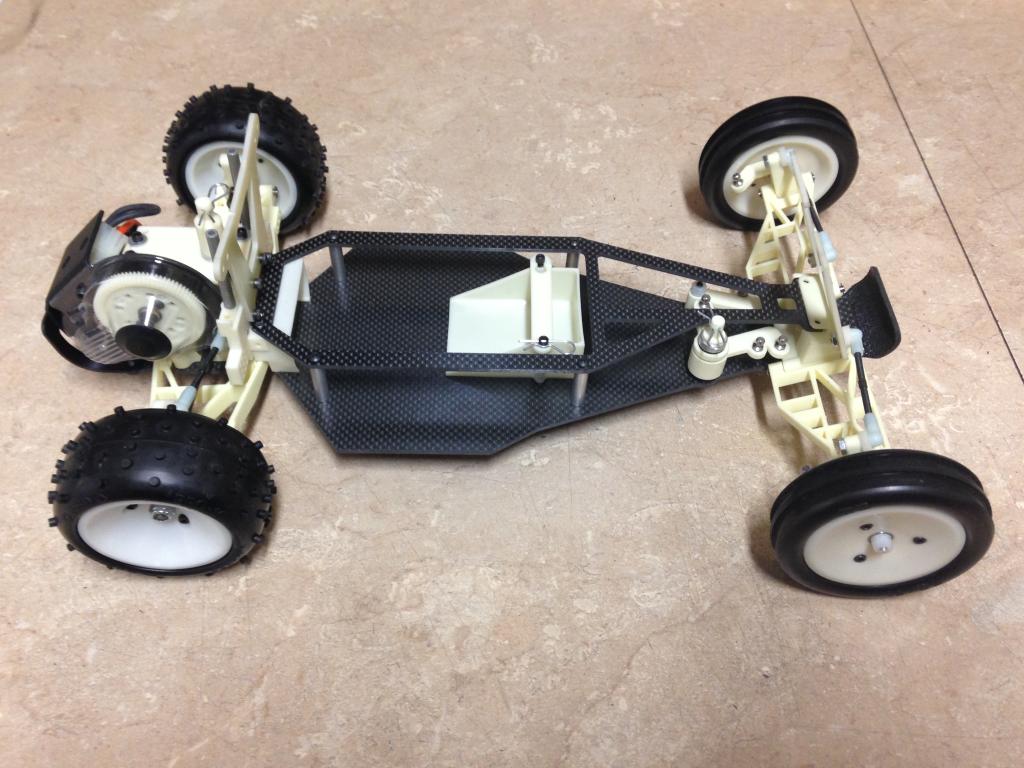

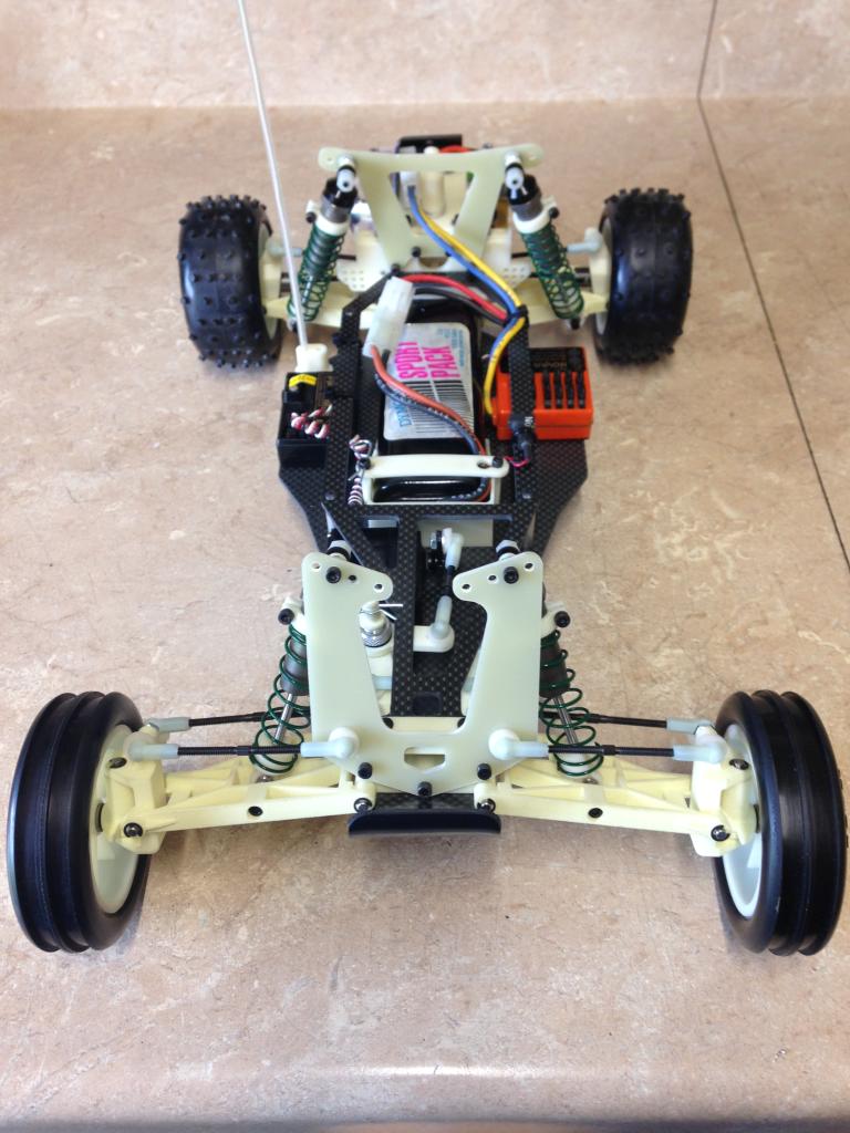

Updated the pics in the first post but they aren’t in any particular order
