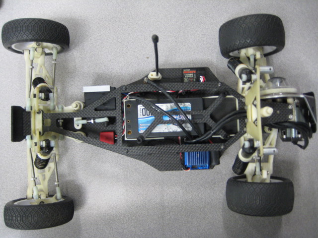

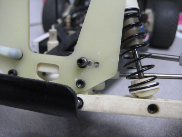

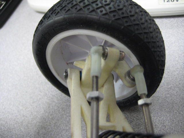

Re: NIX91 Racer discussion thread.
Track: Wolcott Hobbies & Raceway, 130 Scott Road, Waterbury, CT.
This track hosted the 2014 Vintage Offroad Nationals, and I have been told it will host the race again in 2015. Its a smooth, medium bite, Indoor track. Pro-line M4 compound tires are a must. Any bar type tire works fine really, right now Electrons work great.
Nix91 setup
Front:
Losi 35 wt oil
Custom piston, 3 x 1.15mm holes
5 .030 limiters
Kyosho W5181-55 springs
Upper mount #3
Camber link, New inside 3rd hole on camber link, -1.5 degree
Modded caster block back 1mm
3 Bump steer washers
24mm ride height
25 degree front bulkhead
Proline Electrons M4, Pro-line closed cell insert
Rear:
Losi 30 wt oil
Custom piston, 2 x 1.45mm holes
2 .030 limiters
Kyosho W5183-60 springs
Upper mount #1, lower mount #3
Camber link 1-A, -1.5 degree
3 degrees toe-in per side, 1 degree antisquat
24mm ride height
Proline Electrons M4, AKA closed cell insert
Lrp X20 9.5t motor, std timing
24/81 gearing
Lrp SXX ESC
SMC shorty 4600, forward
Airtronics 94774 servo
It's very smooth and predictable to drive. I'll probably move the caster block back another mm for a total of 2mm, and I want to run 0 degrees antisquat for slightly more corner exit on power steering. Otherwise should run well at the 2015 VONATS race.
I would think the Nix62525 racing steering assembly with the steering servo rotated 90 degrees would be a symetrical setup for the front. I like the battery forward design too.
BTW, I like the new geometry of the inside camber link!
The nix91 steering racks are longer and mounted up higher. It would also require a low profile servo.
