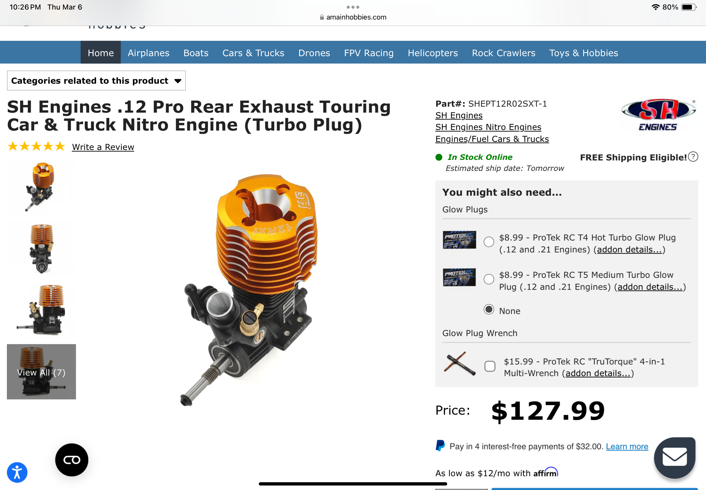

Thoughts on the SH .12 Pro engine for $127? Specs at 1.47hp and 40,000 rpm.
Thanks, limestang
Posts: 12335
Been thanked: 3917 times
Re: The next rere... a GT?!!

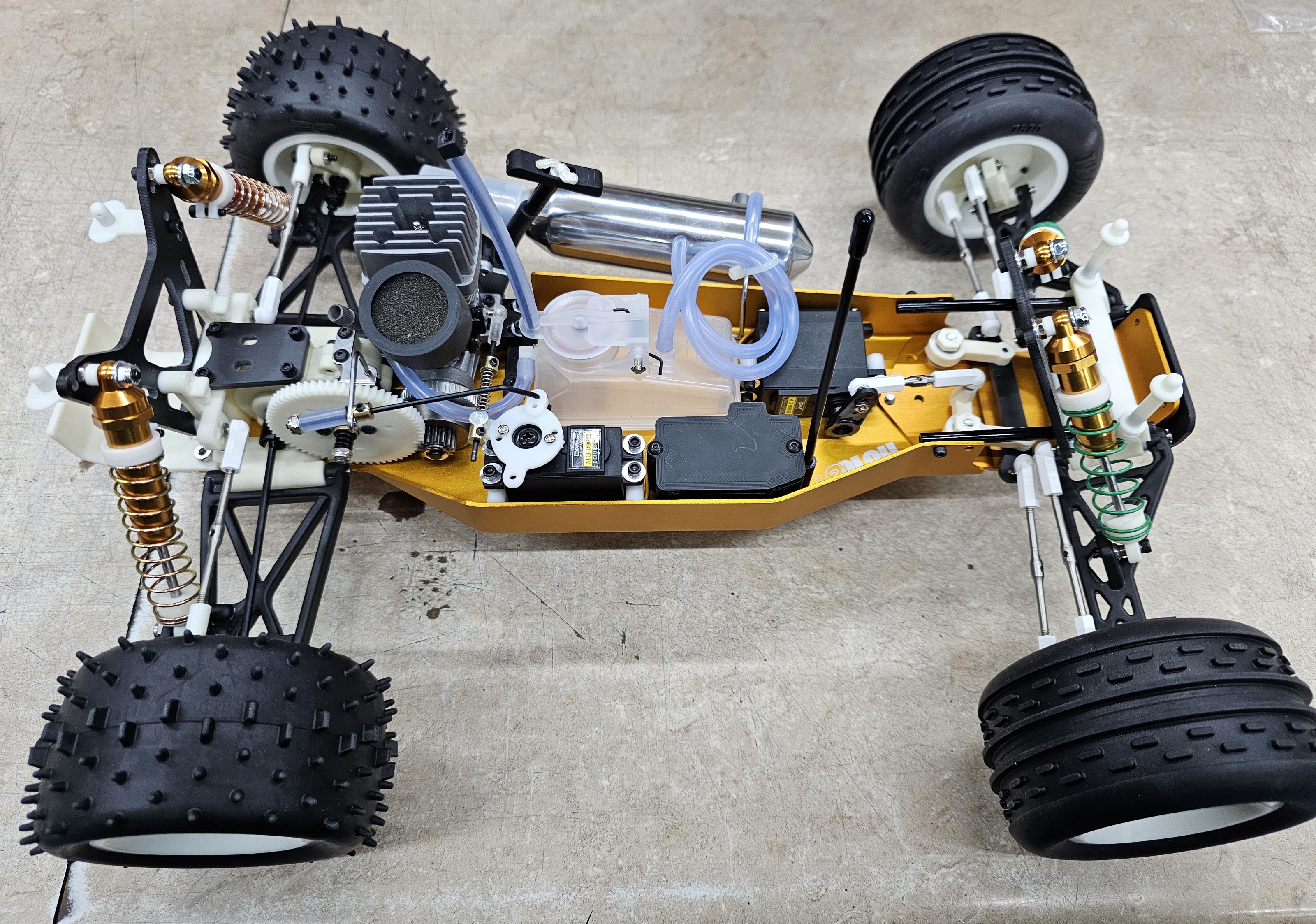

SG crank will be difficult, I *think* you can cut the crank and make them work, but its been along time and I could be wrong. Also the rear exhaust will make header choice difficult.
I went with a USA made K&B engine from Mecoa, but had to order the machined cylinder head as mine came with the older cast head. This was a drop in, even with the pull start. The header is the only concern.

Nice WNIO build!
What's New Is Old. :D
badhoopty
Posts: 3892
Has thanked: 183 times
Been thanked: 157 times
Post by badhoopty »
GoMachV wrote: Thu Mar 06, 2025 11:44 pm SG crank will be difficult, I *think* you can cut the crank and make them work, but its been along time and I could be wrong. Also the rear exhaust will make header choice difficult.
looks soooooo good with the gold tub!
Is the engine in your photo the .18 cast head? I'm seeing the bar stock head and the one that looks like yours on the MECOA website. I've never run a nitro car, but I would like to build up one of these GT kits and get it running.
The AE engines aren't due until late June, so it'd be nice to have something to run in the meantime. I see a user a page or two back also runs a pull-start engine but mentioned that another user-supplied special mounts. You mentioned your K&B was a drop-in but that the header may be a concern. Did you do anything special to get everything working?
Does the kit come with a pinion for the output shaft? Photos of the AE engine appear to show the pinion included, so I want to ensure I have what I need if opting for a different engine.
