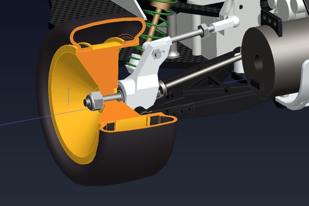

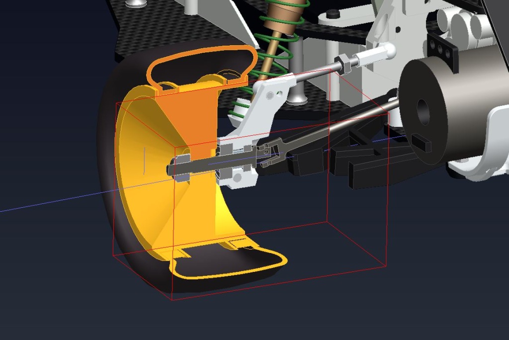

Mark and I knocked our heads together and this was the result:
Rear hub with ASC7935+ASC7933+ASC6906 bearing set and two camber link holes. Classic look obviously
This could be used in a rere-RC10WC also. CVA axle should fit in there...

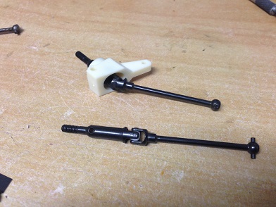

I would like to use the 1/4 inch axels as I have the yokomo adaptors and wheels to put on them.
I have some original cvas from my rc10 graphite, that tests with both the original 6365, 1/4 inch ID bearing fine, I just needed to confirm that the drive shaft length
I don't think these versions are available any more either

I just got a confirmation from my friend:
MIP#1007 CVD-set drive shaft lenght match MIP#1198 CVD shaft lenght you can see in the middle here.
http://www.rc10talk.com/viewtopic.php?f=99&p=405825#p405825
