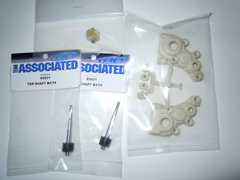

Finally after over a month of waiting AE sent me replacement parts! :D
They actually sent me two top shafts too. Not sure why but I will take it.
Case part # 6565-001
Idler shaft and gear part # 6570-001
Top Shaft B4/T4 part # 9601
If anyone is having the same issues it is definitely worth the effort. I faxed over a customer support form and emailed them a couple times with great results.
