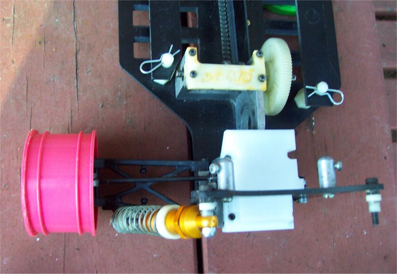

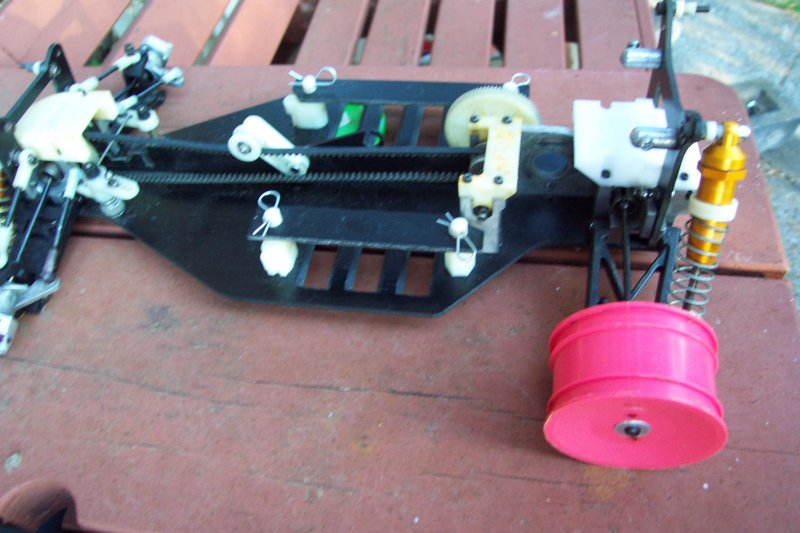

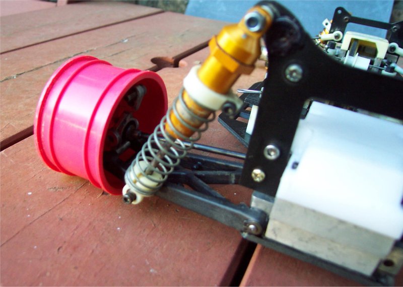

Small update, i'm going to go with the later offset rims because they're easier to find in 2.2". So I was either going to have to make longer rear arms, use 91 works arms or find something else. Figured B44/B4 arms were about the right shape if they were reversed, after removing alot of material from the arms at the inner pivot points i've got some super flexible arms which seem to be exactly the right length. They might break easier than they would in a B44, but atleast I won't break something expensive instead.
I just need to ream out the outer pivot hole in the arm, B3 outer hinge pins will be required for the extra length, and a bunch of spacers to hold the hub carrier in the right place.
I've also made the new rear bulkhead top, haven't made a new shock tower to suit though.

I kept the stock arms on my 870C but used optima mid axle carriers on the rear to compensate for the small offset of the later wheels.
It works very well, but don't forget you need longer U-J's

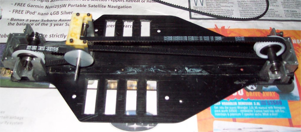

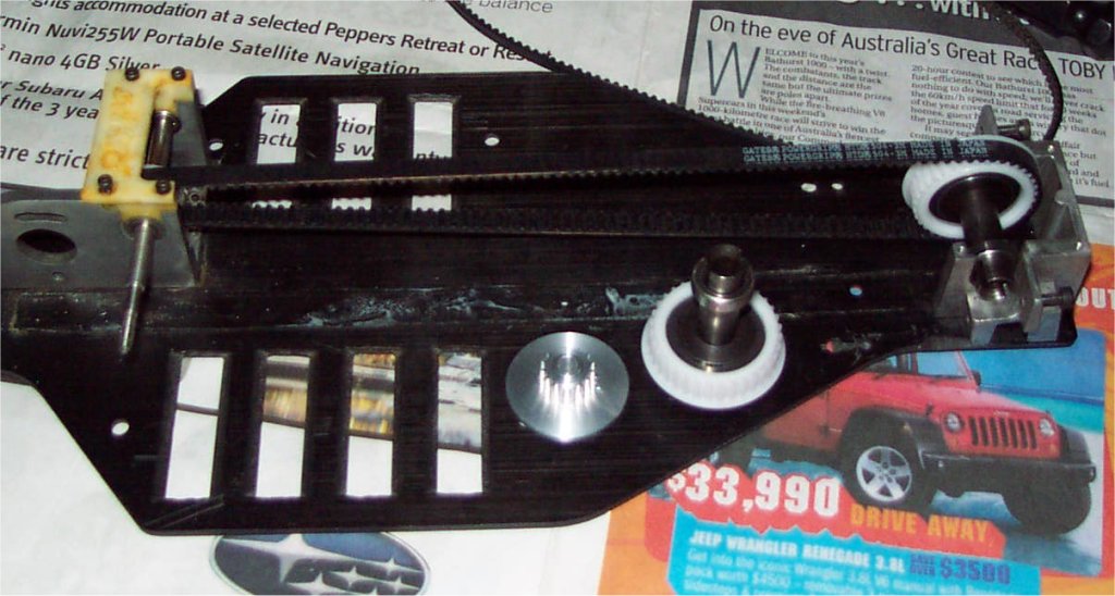

Got the drivetrain almost finished, have to pin the pulleys to the layshaft, mill some flats for the B4 outer slipper plate, and make some sides for the exposed side of each pulley..
There was only just enough room to fit the 6mm belt pulleys in the rear, front was easy.
Also I bought a Corona 2.4GHz module and it's working in the Futaba radio perfectly, just have to switch it into PPM mode..
