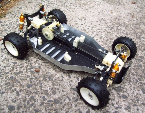

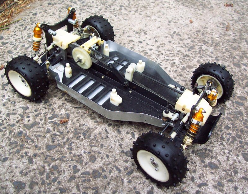

Just got this, needs a bit of work. The rear diff pulley is screwed. Rear shock tower seems to have been broken and repaired by gluing a washer to each side. Not a huge fan of the body that came with it!
Bulkheads look to be ok. Is the only place the bulkheads crack the shock tower mounts? I was thinking of making some new bulkhead caps which have small ears sticking out the side for the shock towers to attach to.

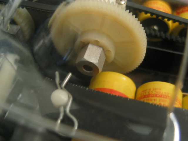

Is there any way the front one ways can be locked out? I want to run mine at St Ives but you realy need the front wheels to brake if you want to get the front end back down after the jumps.

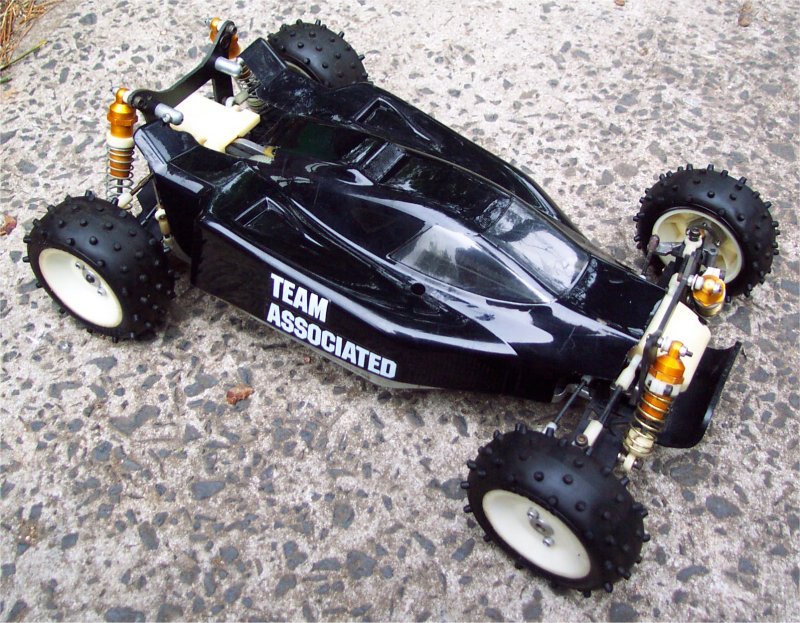

Gonna get a body from mr lexan, haven't decided whether to get the protech or 870c body, probably have to get both!

I was looking at locking the one way, looks pretty simple. I'd just need to make a thing which sits on the end of the shaft, locks onto the shaft with a grub screw and locks into the spur gear with pins going into the holes in the spur gear. So it'd be easy to change between one-way or locked.

Jase, in the original 870c kits they came with both one way and a solid alloy adapter to lock the drive to the spur gear, is this what you are after? You can only do it if you have the stock one piece spur and rear drive pulley.bormac wrote:Is there any way the front one ways can be locked out? I want to run mine at St Ives but you realy need the front wheels to brake if you want to get the front end back down after the jumps.

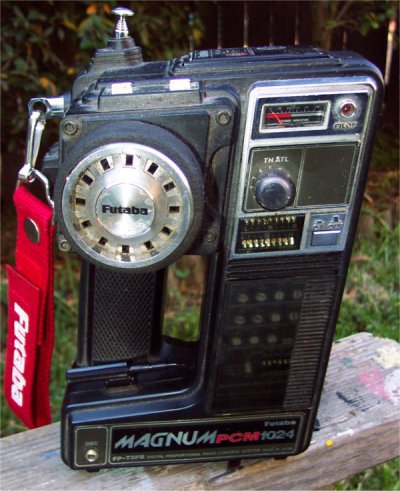

Recently discovered the most awesome transmitter ever made, so I got one to use with this car. 75MHz is illegal to use in Australia though so i'm going to convert it to spread spectrum with a Corona 2.4GHz module.
