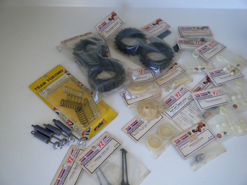

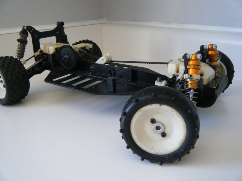

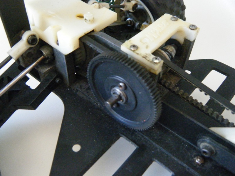

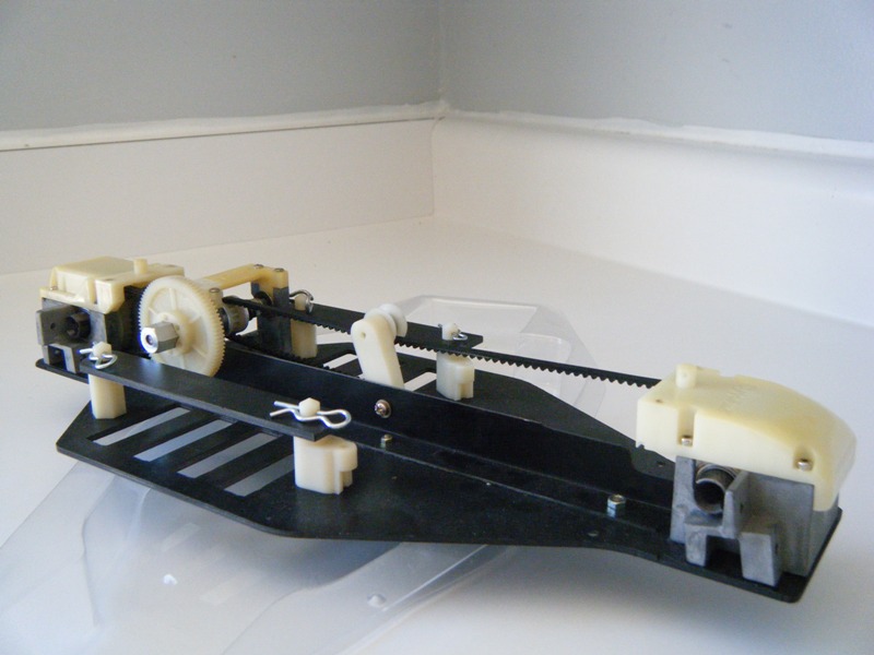

My next project will be a combination of this chassis and driveline which appears to have been the start of someones project, I got this on the bay like a year ago and every part and screw on it is brand new, chassis included. Combined with a farily complete car and a host of NIP parts I think I can come up with an almost new one.
I do not know much about YZ's oddly since I did race one when I was like 14 and it was the first car I ever got a 1st place B-main with.
So....
This
Plus this
And these
What spur gear adapter is on the complete car, anything else unique I am not aware of that the Yok nuts see??

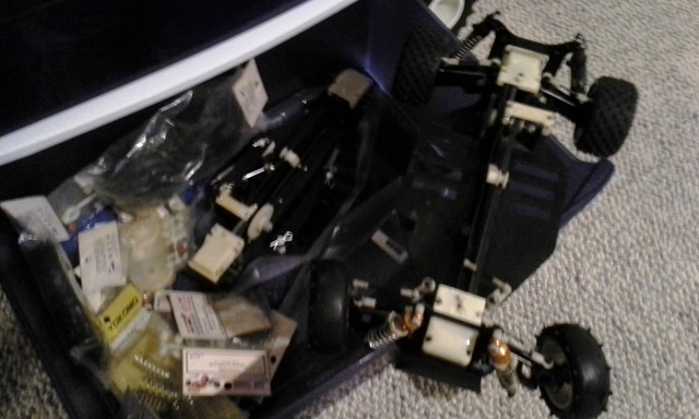

Think I have darn near enough now to start this and pull off a 90% new build. My patience and wallet are worn out so I am going to get to work.

Nice grab there.. the spur adapter could be a yokomo part or maybe a robinson facing part.. I have both myself.. I'll take a look to see mine and post some pictures.. unless someone else beats me to it..
Shawn

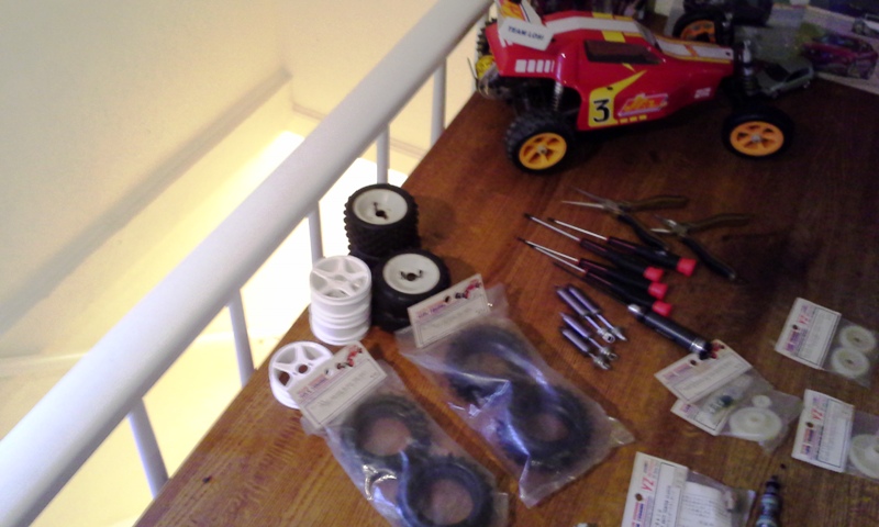

I'd like to find a nice set of new or like new wheels. That is the most visible part and probably the roughest of what I have. They are out there but pricey.
Curious if anyone has tried the hydrogn peroxide on these wheels? It works well on a lot of old assocaited RC-10 parts.

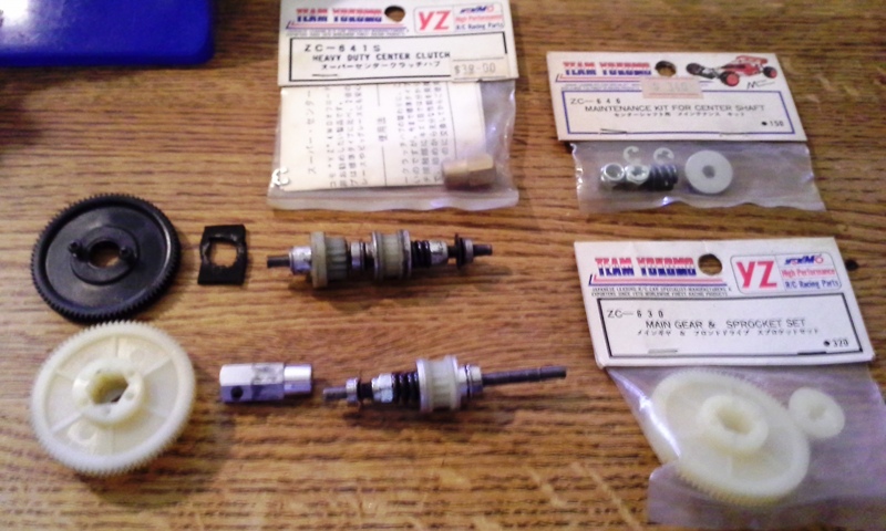

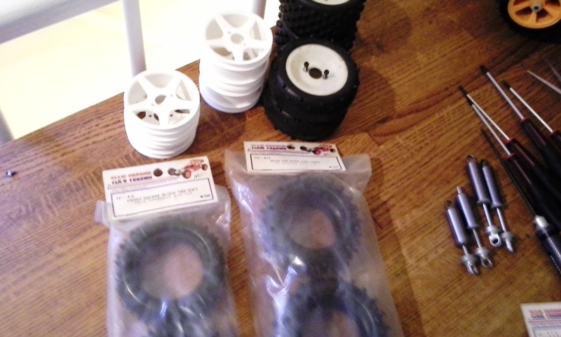

Getting cold out so more "small car" time. Finished rebuilding diffs, they were new, so I just lubed and reassembled. However for spur assembly combining parts but not sure what I have here? The top spur set up (black spur gear) is a one way slipper sort of? Plastic piece jammed in between spur and assembly, not sure what this is/was. Bottom was from the partial new built project I am combining and clearly new non one way set up.
Not sure if the new in parts packages I have can give me one way slipper or not? This is only a shelf build so if I don't have what I need to build one way front in packages I will re assemble without and sell off NIP to someone else. Can someone confirm what I have here and if NIP stuff is what I need for new one way slipper build, I think not??

And while we are pondering big things, crack open NIP tires and clean up wheels for shelf or use modern 2.2 repo 5 stars to showcase suspension and be non original? Please vote :lol:
jwscab
Posts: 6580
Location: Chalfont, PA
Been thanked: 505 times
Re: My next 870C project
Post by jwscab »
Those jc racing wheels will require custom hubs on the rear for the 870c.

I broke down and got new original wheels from Ebay. Ouch.

Hello. I cant tell from the pictures what kind of layshaft and parts you have to assemble a 1 way with slipper clutch. I can tell you this though; The slipper assembly will connect to the layshaft with a pin, so it will be locked to the shaft. The 1 way will have to happen inside the front drive pully. So, if youve got a front drive pully with the 1 way bearing inside,, then your good to go.
