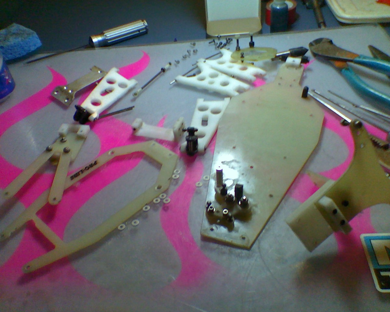

I reversed the arm mounts and WA LA 3 degrees of antisquat!
Now it's completly torn down for a deep cleaning while I wait for some parts and materials to arrive.
Enjoy!
