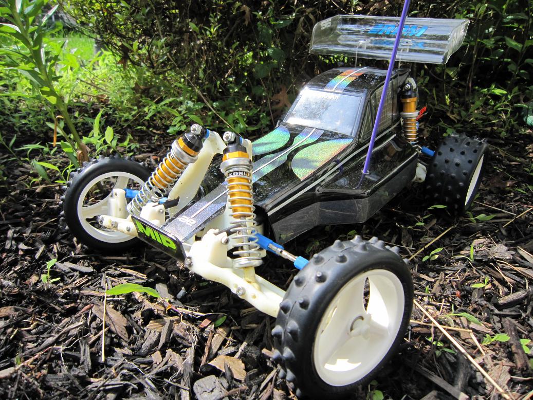

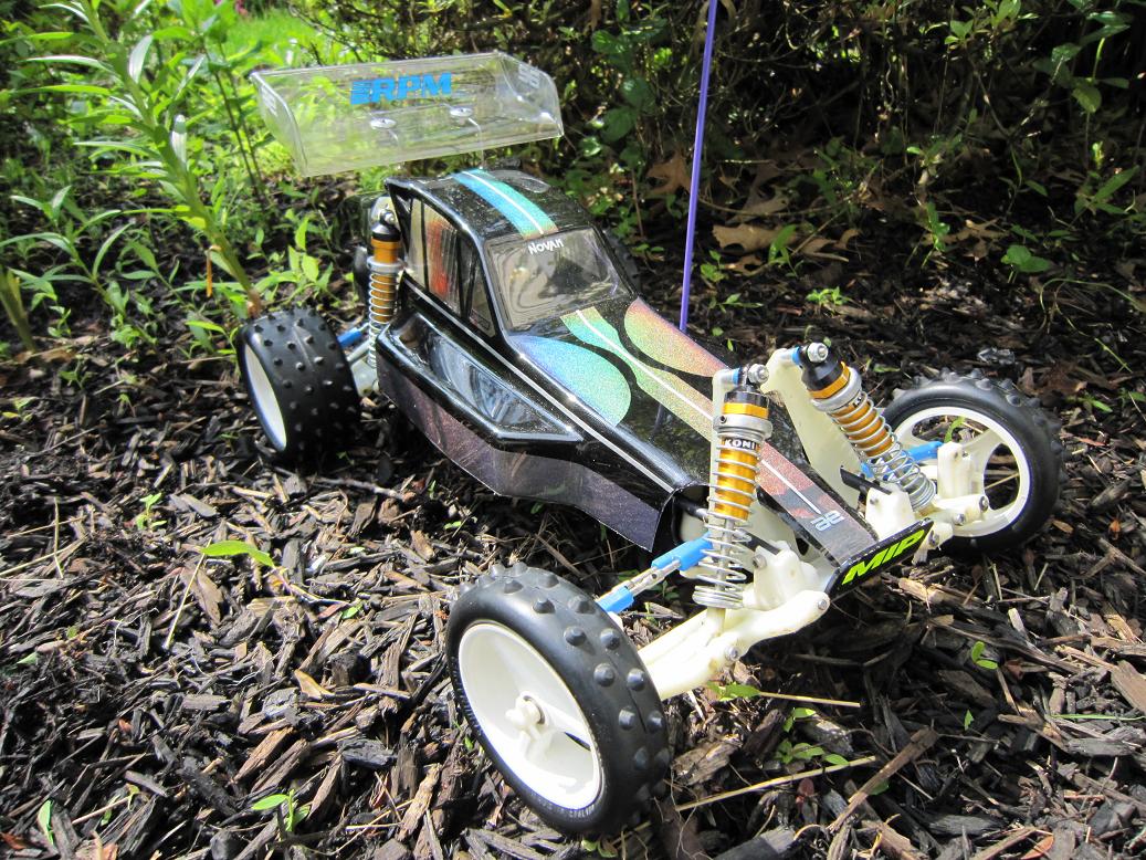

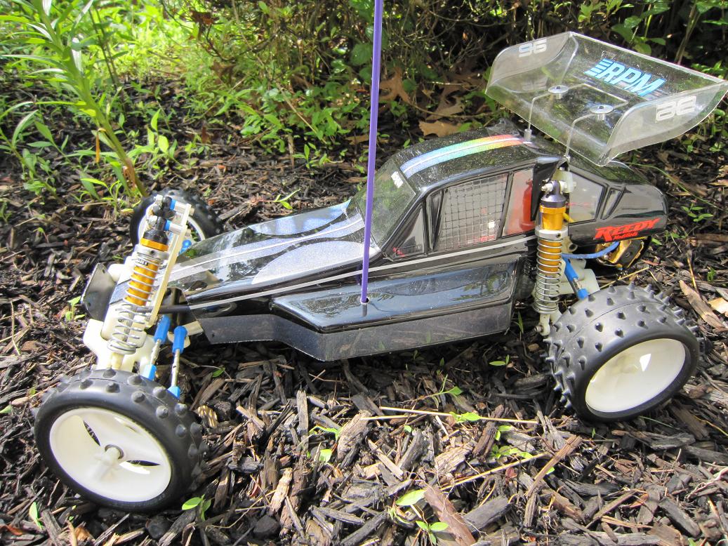

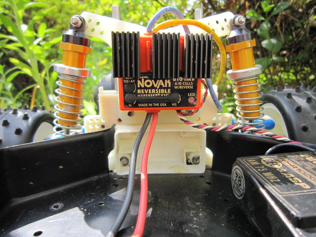

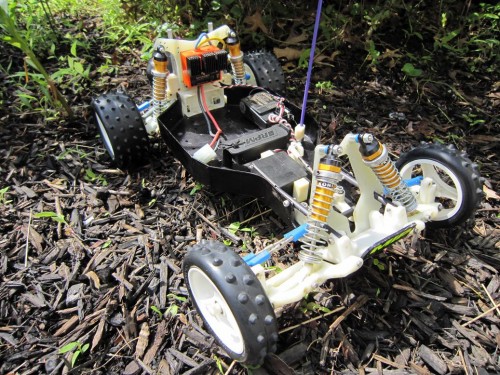

Got this one finished. I wanted to run it so I added some older electronics but it bit me in the ass by being cheap and not going with a 2.4 setup. First run out in the yard I lost total control and wound up slamming into a retaining wall. I got lucky as it only snapped a tie rod. Still didn't learn and gave it another shot and wound up running after it like a hundred dollar bill in the wind. The little bit of time I did get control of it was very cool. The older esc and radio looks cool and thats about it, I'm ready for some new stuff.

nice buggy and body.
I also had trouble with that particular futaba receiver in the aluminum pan. You have the crystal close to the side chassis. I would try swapping receivers before ditching all electronics.
