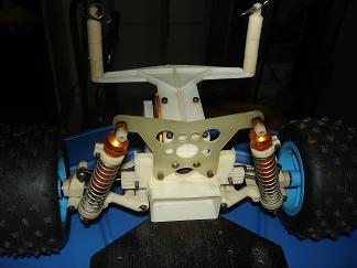

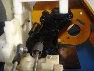

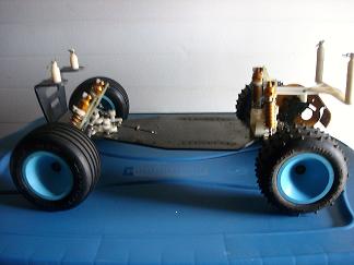

Craigslist find. Would I be better off starting with this chassis instead?

Well, it all depends on what you are looking for. If you want a purely vintage truck, then starting with a buggy chassis and some offset wheels is the way to go. After that you can do all kinds of stuff, like new shock towers and shorter shocks, a chassis with an offset battery pack, maybe turn the motor around.
If you'd like more of a pure runner, I'd start with an RC10T and lower it with the Factory Works towers. After that, try driving it and see how it runs. Them decide what other changes to the layout that you'd like to make.
I had a Parma Dodge Ram body, the street truck, on my RC10T with Pro-Line Strikers and it looked pretty sweet. I had to chop out the bed to clear the off-road shock towers, but that wouldn't have been a problem with new shock towers.
