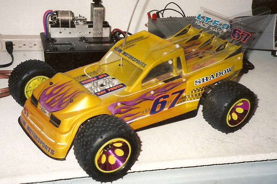

here is the link to my oval 10t. it's about as extreme as you can get.
http://www.rc10talk.com/viewtopic.php?f=36&t=2189&hilit=terminator+10t

wyldbill wrote:here is the link to my oval 10t. it's about as extreme as you can get.
So, what size shocks are you running and will the front RC18T's work? The reason I ask about the shocks is that it seems there are more options with the 18T vs .56 or .71 shocks.

18T shocks would probably not be a great choice, your spring selection is going to be pretty poor. shocks are easy to find though, just use a set of associated TC3 shocks, and if you need more static ride height run a longer shaft like a .71 shaft. that way you'll have lots of spring choices. for a smooth track though where you can run the truck low you should be able to get away with any stock length touring car shock. Reggie posted a link to my truck a few posts ago,
http://www.rc10talk.com/viewtopic.php?f=36&t=9653
It uses Custom Works Interim shocks which are the same length as TC3 shocks and I used a long dubro 4-40 rod end to get the desired ride height.
