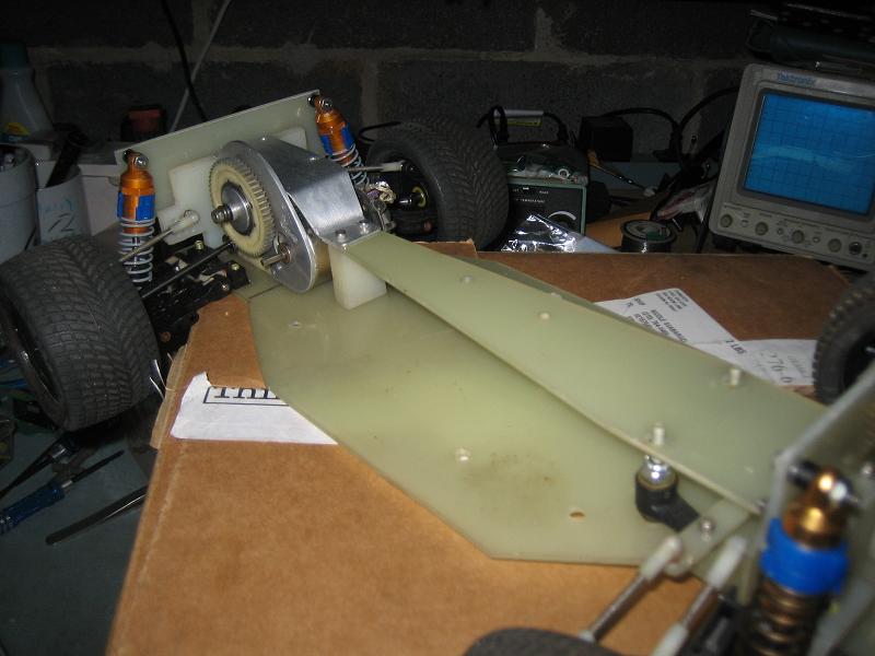

yes, I will snap some pics tonight to help clarify.....in the meantime, I pulled a couple images from an old thread, compliments of jsrracing, you can see how the motor is mounted, and how the motor plate was trimmed.
let me know about those shocks, and once I get pics from home, if you are interested in the motor plate.

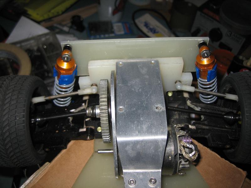

here are a couple pics of my mid motor car:
