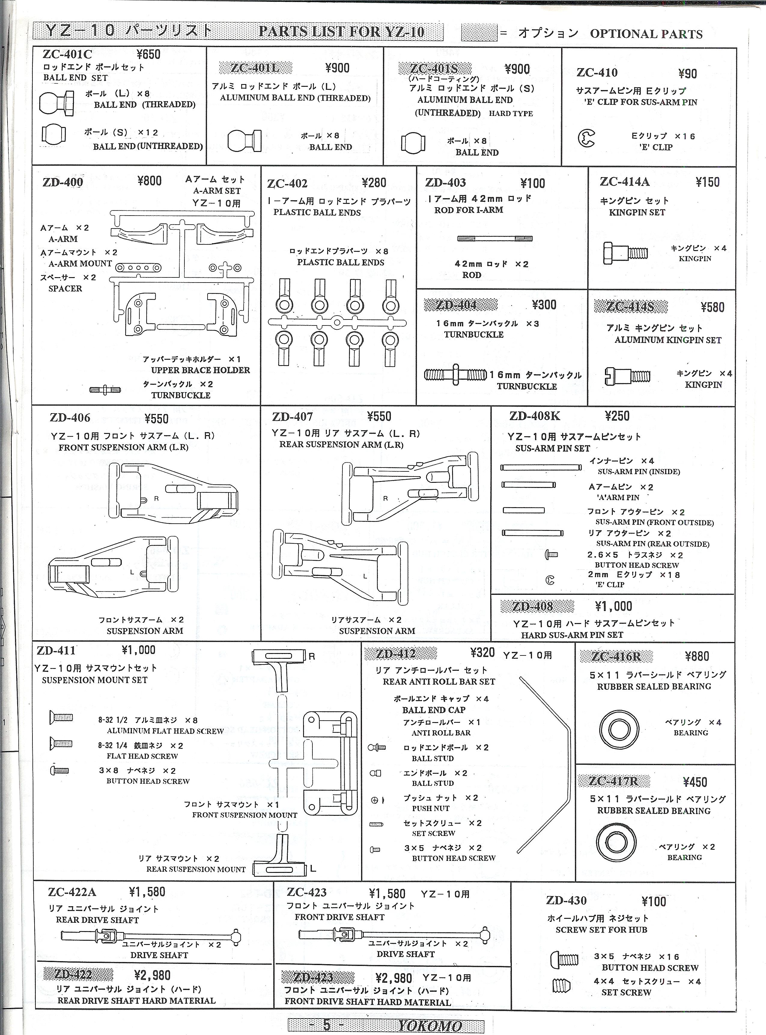

Here is what the 94 manual shows!fakiee wrote:So the all driveshafts sold for the YZ10 (works 94) were of the 'hard' variety?
Yokomo universal driveshaft's part # versus model?

Thanks!! Certainly cleared things up for meaip47-2008 wrote:Here is what the 94 manual shows!fakiee wrote:So the all driveshafts sold for the YZ10 (works 94) were of the 'hard' variety?

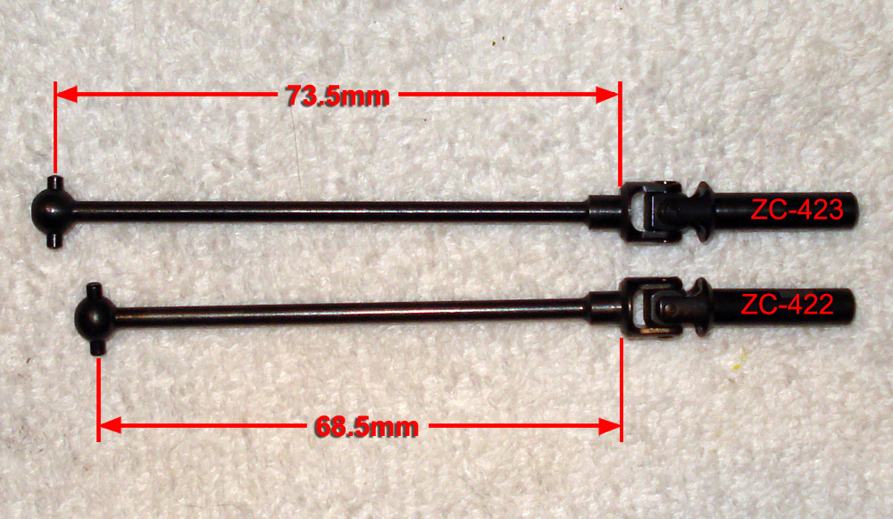

Since this thread is already talking about Yokomo universals maybe I could ask a question on the topic....
I have the two universals shown (ZC422 and ZC423) with the lengths listed (not full length as can be seen in pic - this is because I believe that there are also a few lengths of axle which could throw the measurements off). I'm looking for a yok universal that measures 1mm longer than the shorter one here (so I'm looking for 69.5mm to 70mm dimension). Does anyone know if this exists? I know that ZC421 is too short but does anyone have a measurement for ZC422A or is there another part number that I don't know about? The ZC423 is just too long for what I need it for and the ZC422 pops out of the diff outdrive at full suspension extension.
Thanks everyone,
Jeff
Thanks everyone,
Jeff

Re: Yokomo universal driveshaft's part # versus model?
I've got 5mm shims and have tried everything.... but neither of these will work too well. I can explain relatively quick as it can get complicated. This is for the rear of the '89 masami yokomo with the wide rear white arms and modified RC10 rear hubs (as well as moded camber link position on that hub). It seems that this setup offers a lot of camber change throughout the suspension travel causing the universal to bottom out in the diff-outdrive rather quickly if the universal length is just a tiny bit too long. So, basically to utilize the full shock travel the universal has to be right at the edge of popping out of the drivecup at full suspension to ensure that it doesn't bottom out at full compression. To add more crap to this I could just use the ZC422 and put 1mm of shims before the first bearing (same as your o-ring idea) but then the axle portion of the universal doesn't sit flush with the aluminum wheel mounting hub (the axle is recessed by about 1mm) and since I'm being overly anal I'd prefer not to do that. This is why I need such a specific dimension and was hoping the ZC422A could work.J.M. wrote:Hi Jeff,

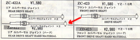

Yea, I could do that too, but I wouldn't want to add much more than 1mm of limiters or the droop would be too little (and then I'd have to limit the front to keep balance correct). Since I'm not using the actual arms that masami had the droop is already approaching the limits to keep things realistic.
But, for fun I cut up the instructions from above and placed the 423 below the 422A and the dimensions on the 422A may actually be what I need (assuming that the drawings are somewhat to scale). That would be perfect if you could measure up your 422A's for me Reg!!
Thanks for the help with this guys!!

THIS JUST IN.......... you should attach pics when you reference them.

Hi Jeff
I just measured some nib ZC-422a that i have here and they are the same as ZC-422 they just have a longer flat on the end?
Peter
Peter

Thanks Peter!! That does suck though... I was really hoping they were a bit longer.pedro wrote:Hi Jeff
Peter
Does anyone know of any other part numbers that haven't been mentioned?
