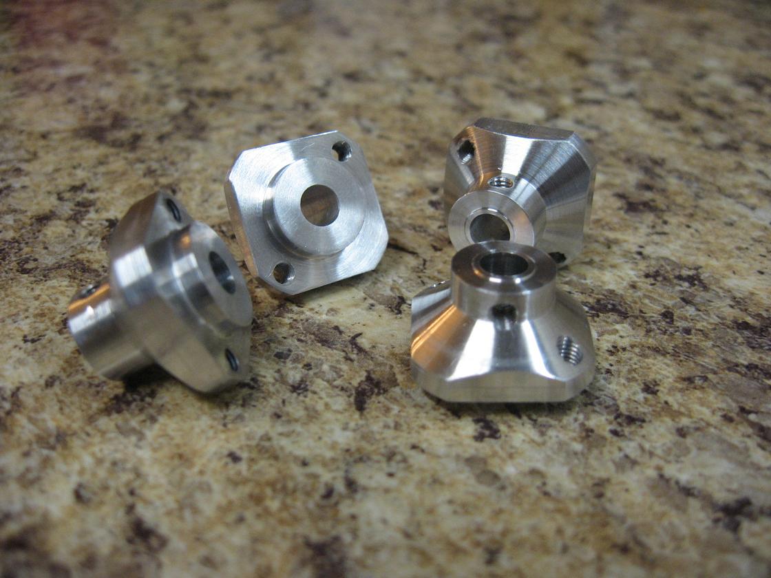

I took a few more accurate measurements last night.
the 870c has an approx 235mm width stock.
the JC wheels up front are slightly over 1mm difference in offset, so overall, the front width will be just under 3mm narrower.
the JC wheels out back are roughly 6mm narrower and thus would need a 6mm spacer, or new set of rear hubs spun up. If you used a front hub which is 3mm thicker than a rear hub, you could use a 3mm spacer. If you are handy with hand tools, and had a spare set of front hubs, you could get away with running the JC wheels very cheaply.
I found a length of 3/4" square stock in my raw material. this is within a few thousandths of 19mm, which is what the square hubs are. should be easy to spin up a few sets. I have a set of JC wheels, so I'm going to need to do something anyway.
if interested, let me know.

I have a set of JC wheels and made my own spacer to make up for the offset.
I have not made the full set for the car yet since I am still trying to gather the parts I need.

Well I've had nothing back from Dynotech so I'll go the spacer way, it looks like it's gong to be the easiest way and they look very nice too Jake

Re: Please tell how to modern tyres / wheels 870C?
looks good jake....I spun one adapter up the other day, just need a couple holes drilled and tapped. I'm sidetracked right now because I realized it would be a great idea if I spun up another motor pulley for my lathe before the one I have finally bites it. the V groove is worn so thin it's amazing it's still working. rather than chance moving forward with any other parts, this pulley needs to be made.
Ooooo I like these, very nice work bigjeepzz
They posted today. You are welcome and I hope they work out great for you.
Jake
