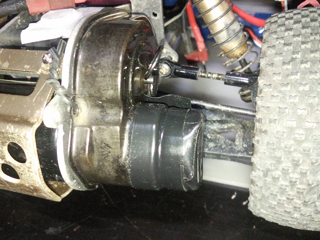

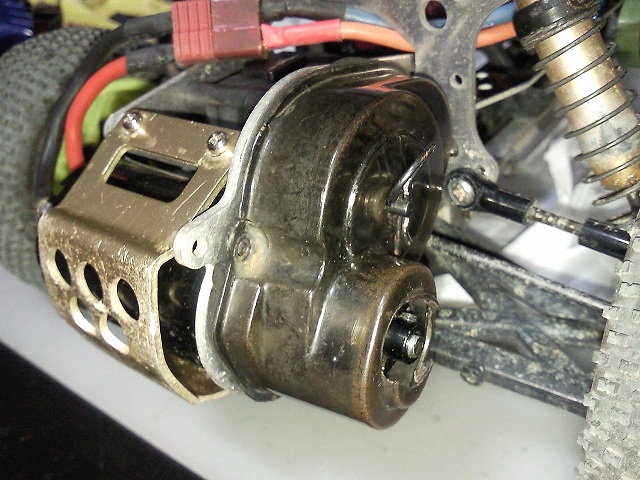

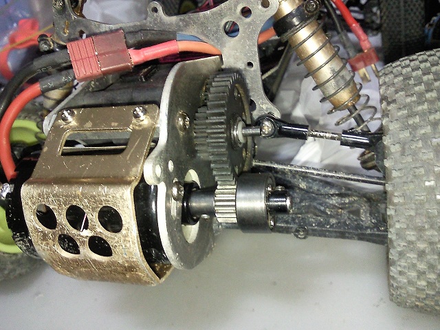

I had been searching the net for photos of how the Torque limiting clutch installed and couldn't find any, so now I have it already, thought I post a pic of the clutch pinion installed, pardon me for the broken gear cover :oops: I think this 1 is made of steel as I have another which look like it's made of alloy. I intend to try running with mamba max pro 6900 and see how it handles , i inserted 3 O rings for maximum clutch engagement as it gets very hot if I only install 1 O ring.

What motor are you planning to run with that, are you going brushless?
I wonder how that clutch pinion works...are you also using the Turbo Optima/Salute torque limiter (center gear with spring on the shaft as opposed to a solid shaft)?

Currently the black motor is a team power stock motor, which is similar to tamiya sport tune. I intend to use Mamba Max Pro 6900 BL motor,I think its way overkill for such an old car, but I'm just curious on how Optima will handle such power. I'm using the original optima solid shaft center gear. Got a belt system as standby in case the chain system gone kaput. if the 6900 is way overkill I'll just change to a Lehner 4200 motor. By the way, anyone here has a hardened final pinion for sale? I reckon I'll need it if I'm to run on brushless for long term. I'm currently running Pargu's alloy final pinion.

fix the broken gear cover with plastic bottle cap, hope it'll hold up .

I don't think that'll hold, and once dust & dirt gets into that black tape, it'll fall off...and might make a mess if it unravels and gets caught up in your outdrives/dog-bones. :shock:

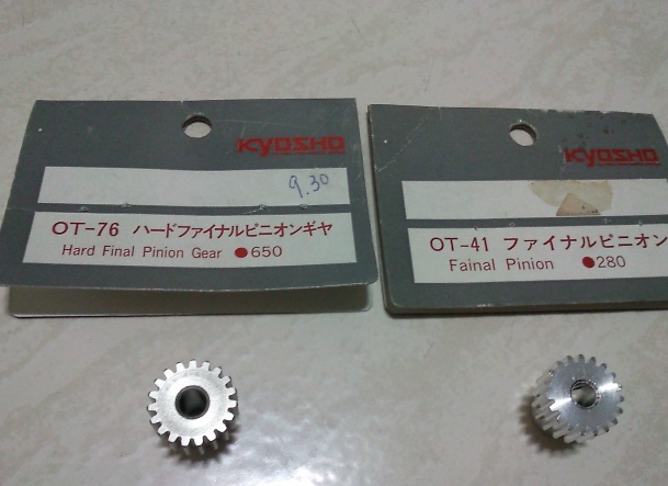

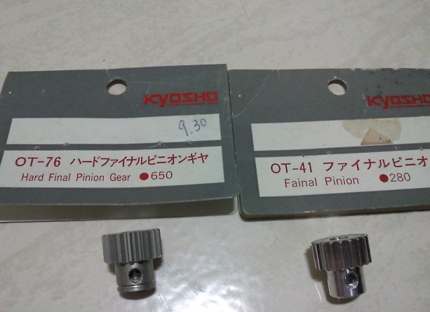

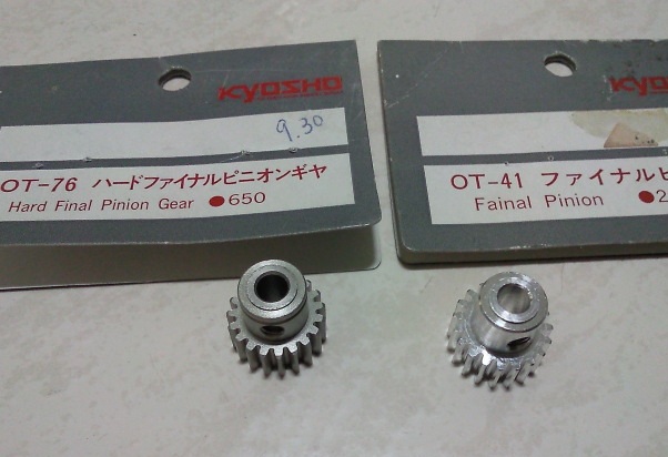

Optima Hard final pinion vs normal final pinion, what surprise me was the hard one actually weights the same as the normal alloy, at 6g. My buddy has an after market one, which I think is made of steel, weights so much heavier, so I guess kyosho's hard final is some kind of coated/anodized?

Yeah, the Kyosho one must be hard-anodized...I have 3 hard pinions and they're all noticeably heavier than the Kyosho one, and they are colored a lot darker, almost a charcoal grey color instead of bright aluminum.
