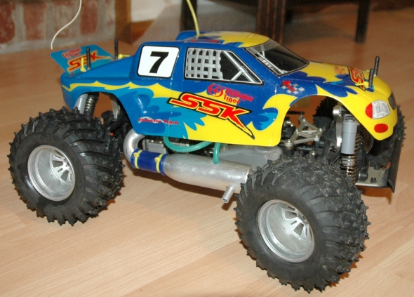

bearrickster wrote:Very nice work on the chassis. what wheels are those I have never seen them before.
Thanks. Those are wheels from a Thunder Tiger truck. I think it was called the SSK. They were reasonably cheap and came pre-glued... even the tires looked pretty close to the ones on the Tamiya trucks. Actually the tires perform quite well compared to the stockers as they are softer and come with foam inserts.
Here's a pic I googled...
