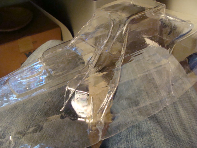

Well the prognosis is bleak, going to take a moment to regroup. I can't seem to keep the polycarb hot enough and the vacuum to suck hard enough to make it work. If it sags too much i get a body with wrinkles, but it still doesn't pull it tight enough to the body at the bottom. no problems with the mold release.
Thomas A Edison "With each failure, you get one step closer to the solution" or something like that. :lol:
