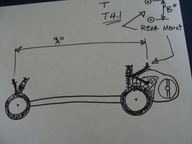

i have a t3 so i don't need mounting dimensions for that buggy and i am guessing the t2 and t4 are the same
what i need is dimensions for t4.1 and t because they have the two rear mounting holes
and let me know what you think or what i could add or subtract
as far a details i am sure i will be fighting with my OCD on this :lol:
thanks
tom
diagram for dimentions

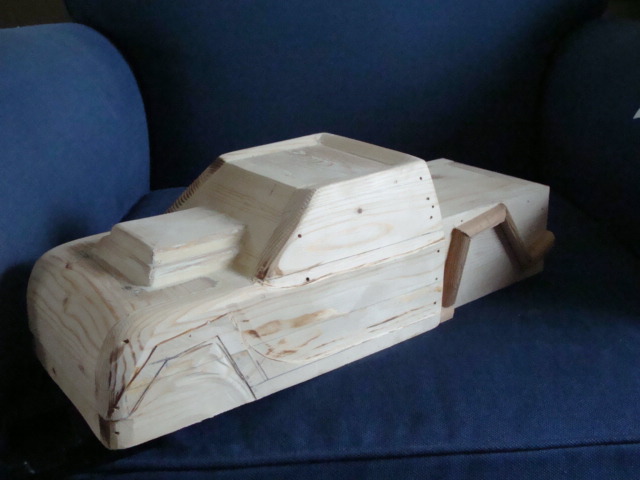

here is the wood mold at the rough sanding stage

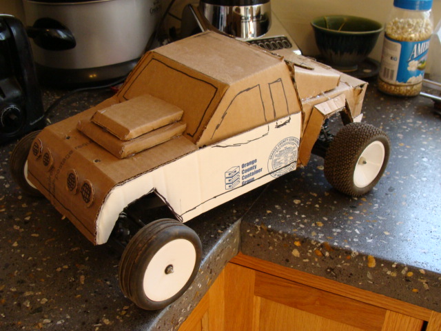

here is the cardboard prototype, after my scale drawings

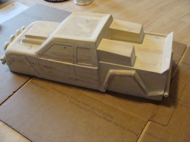

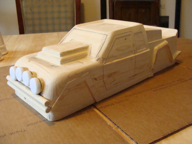

update on progress
getting close for a trial run
trying to source polycarbonate "lexan" at .030 thickness only found .060 thickness locally and shipping .030 sheet is out of the question
PETG is poor mans polycarbonate but dont know if i'll be able to get
i think i would have to order 40 sheets :( to get the thickness i want $65x40 = 2600+tax :lol: a bit over the hobby stage
well the local guy said he would see if he had some scraps laying around he might sell me, i am not sure about vacuum forming with .060
getting closer
getting closer

look at mcmaster-carr. they sell sheets individually reasonably priced. polycarbonate. you will need to be sure that your design has some 'draft' to it, ie, the mold is wider at the bottom then top so that you can pull the plug from the body, otherwise, you will have to split the lexan from around the mold. you will need to preheat the polycarbonate for some length of time to dry it out.
many many articles and information on the internet about polycarbonate handling and vacuum forming. Good Luck!
Posts: 12335
Been thanked: 3917 times
Re: Making a universal "T" body
Just one thing to think about, companies like Tamiya have multiple piece molds so they can be removed after the Plastic is pulled over the buck. I don't think you will be able to remove your buck. Think of it like its going in a jello mold, can you remove the body without disturbing the "jello"?

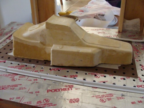

Well i found polycarb through a sign maker for cheap, and a good thing too because polycarb is a tricky material to work with. A preheat is needed before the actual 'metling' occurs, otherwise i get bubbles in the body. My second problem was that my vacuum was not sucking hard enough,problem fixed now, and that i needed a better seal between the vacuum table top and the frame holding the plastic sheet, problem fixed also. My third problem is getting the body off the form, big problem and not solved (WIP).
Discouraged, and having a bunch of polycarb left I was trying to make a mold of an old, i think, Scorpion body. What i noticed was that the body tapers inward in all directions as too let the body come off the mold easier and to probably make it easier to get a crisper edge at the bottom of the mold.
Tom
