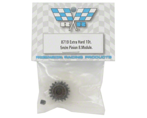

I just knew when I heard about those 5mm bore pinions that they'd work. Sad part is, I put mine in the car that ended up being the shelfer, so now I have to get another one and tear the runner apart to install it. What did you use to shim it? I think I ended up putting a spare bushing on one side and a couple of washers on the other side.

I had a couple 5x8mm plastic bushings that went on the left side and the right side got just a shim

Can you guys remind me what the alternative final pinion gear is please? I'll have to get a couple.

final pinion - It´ll be 19t 0.8M 5mm borekeithrc wrote:Can you guys remind me what the alternative final pinion gear is please? I'll have to get a couple.

Robinson part number 8719, specs are as Dennis said .8 module 5mm bore 19t

Thanks for the part number, found some on ebay.
