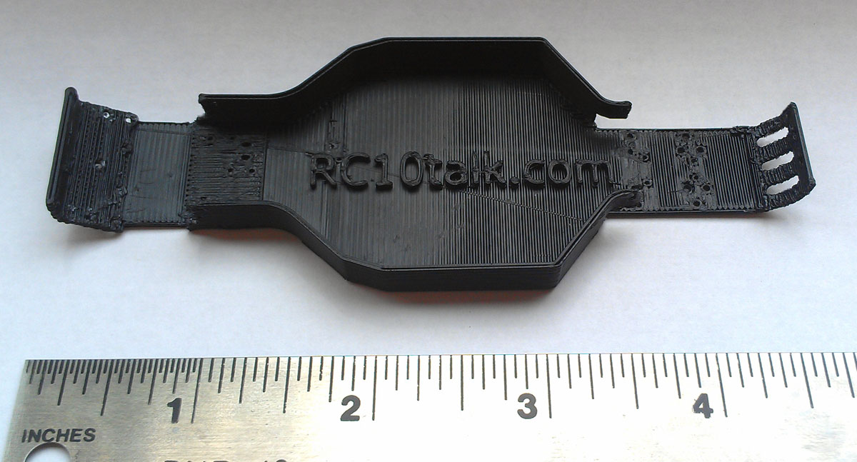

Here you go! 1:32 Scale (with 3x wall thickness). Anything smaller would be very tough to print with any detail.

SWEET! Now to find the rest of the parts and the electronics for it :D
I bet those screws would be friggen TINY.

Hmmm....almost keychain size :mrgreen:

We're getting closer!
