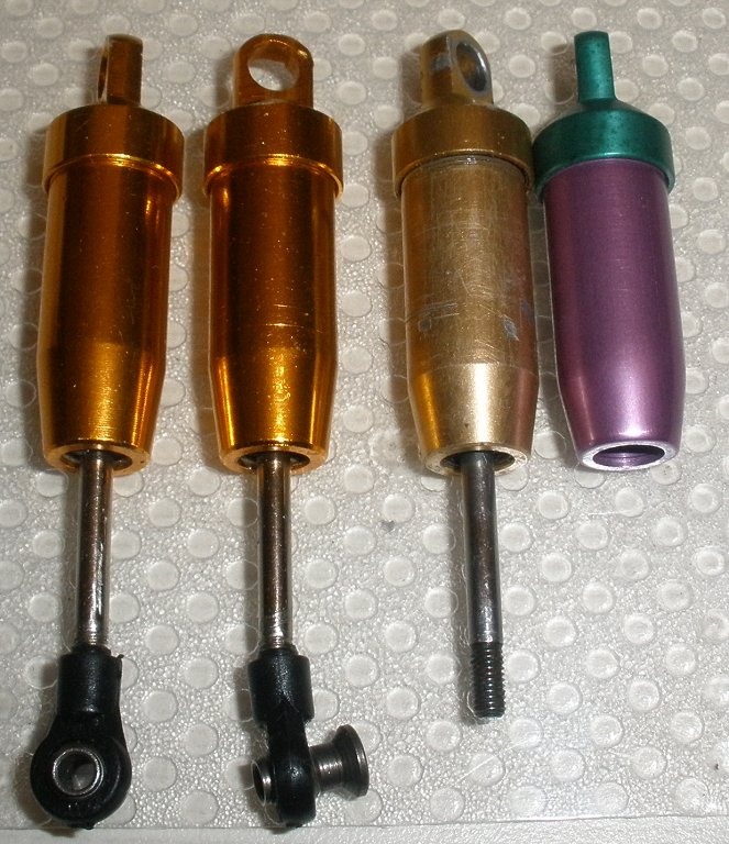

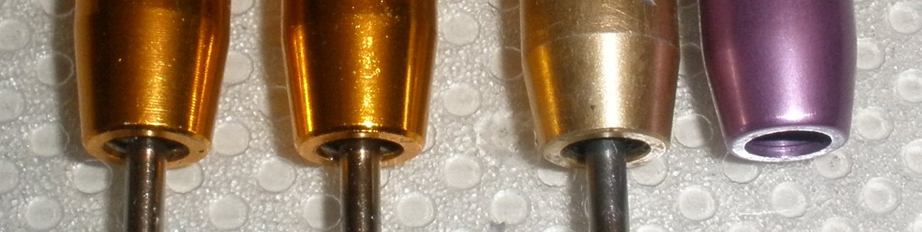

Re: Identifying Duratrax vs Kyosho Gold Shocks
Yes, I can confirm that, Jeff. The Duratrax shocks have that tiny beveled edge--less than a millimeter, very hard to see unless you have one in your hand. You'd never see it in an eBay picture, unfortunately.
I also found, if you look very closely at the Duratrax shocks--just below the beveled edge (or above, in my picture below)--you'll see striations encircling the bottoms of the shock bodies; the Golds are smooth there, as they are elsewhere.
My picture also should indicate the distinct glossy finish that I haven't seen with Kyosho Golds, which have a more satiny finish. Even the shock body I polished myself and had re-anodized lacks this high glossy sheen.
And lastly, the Duratrax shocks have a longer taper at the bottom of the shock bodies, than the Golds. 3 Golds have a tapered section from just over 7mm to 8mm max, whereas the Duraleaks have at least a 9mm tapered section.
Those striations being machine marks. Looks like the duratrax shocks are turned with a faster feed rate, creating a rougher surface finish. All kinds of little differences popping up.
Again hard to see in an auction but the area at the bottom of the shock has a different length where it tapers too, probably due to the one less oring

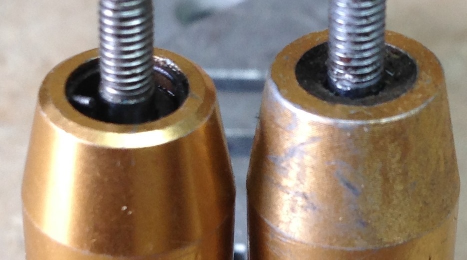

I took this pic 5 years ago with a crappy camera. The Kyosho one is on top. Once you have them apart and side by side, you can see a ton of differences. Also, the gold color is nearly the same on these examples. I think the best way to identify them, short of disassembling, is that tiny bevel that gomachv has discovered. But yeah, on a standard epay auction pic, you may or may not be able to discern the bevel and identify them properly.
