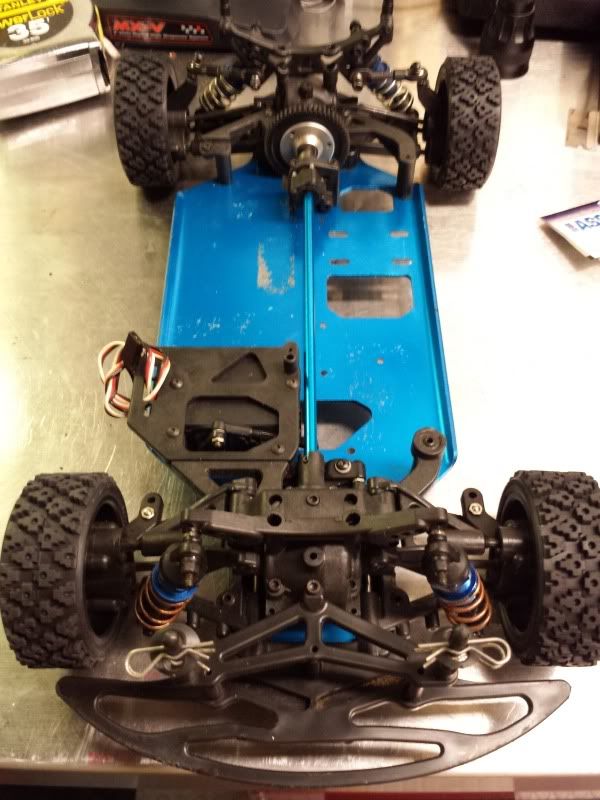

Have any ideas for a front bumper, other than the stock nTC3 one (http://www3.towerhobbies.com/cgi-bin/wti0001p?&I=LXKNY1&P=7) , which sits basically horrizontal?
Maybe this one http://www3.towerhobbies.com/cgi-bin/wti0001p?&I=LXBLX5&P=7, then I could make an aluminum skid plate that would sweep upward?

thats one thing I never addresed. I hacked the crap outta the one but never went any further :? I'm not a big fan of aluminum bumpers since one hit and they stay that way but there are bumpers out there that can be modded to fit...just gotta find the right one

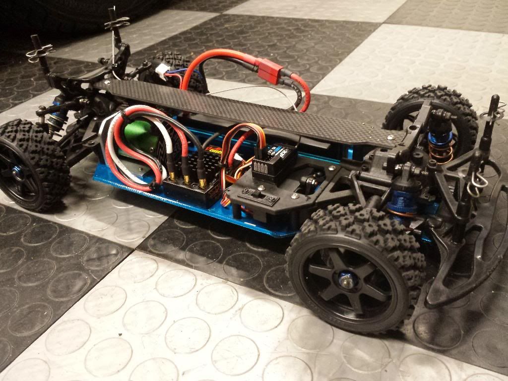

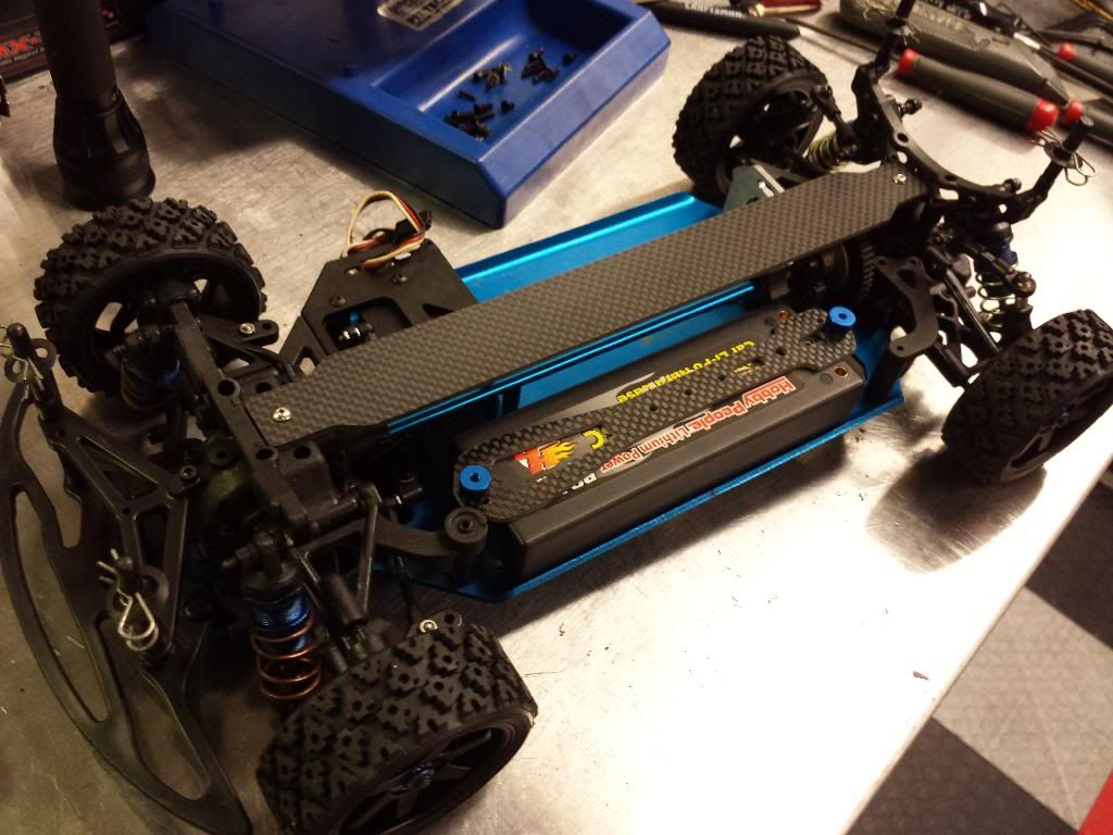

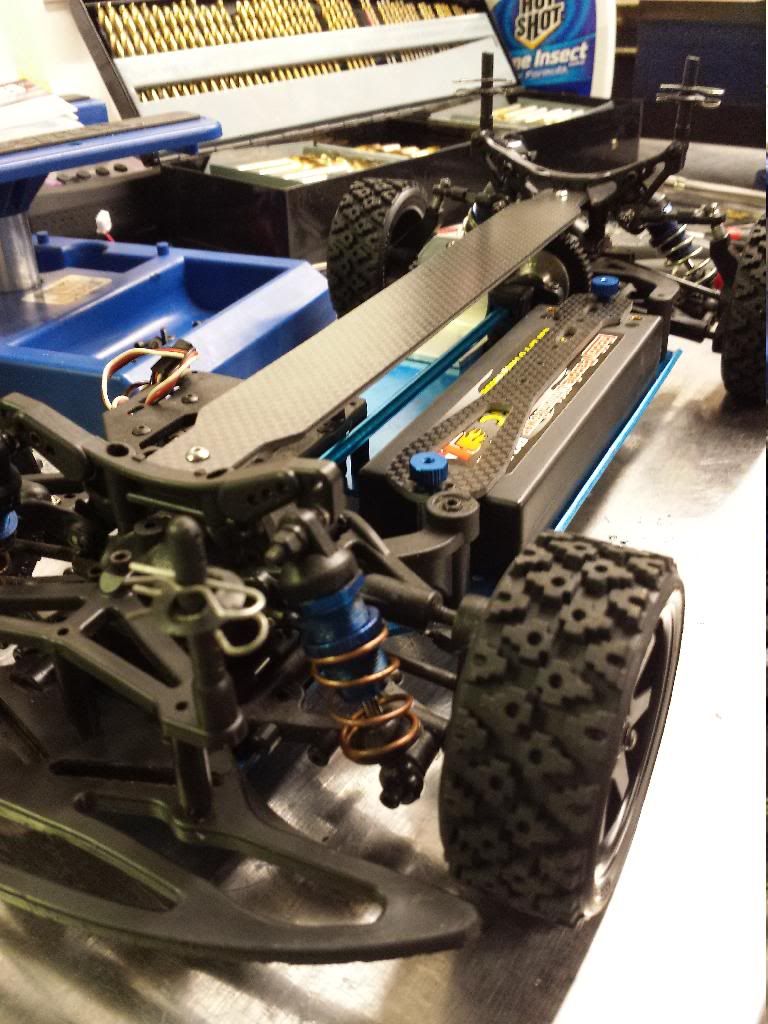

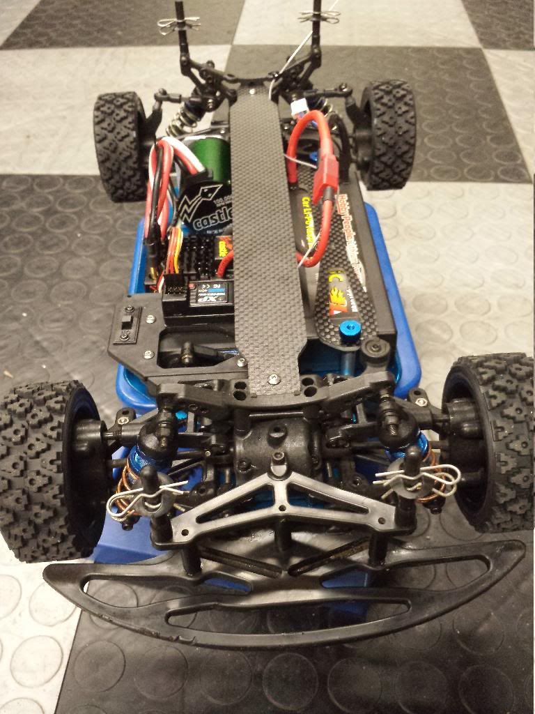

Got the new shoes mounted! I really like the way it looks

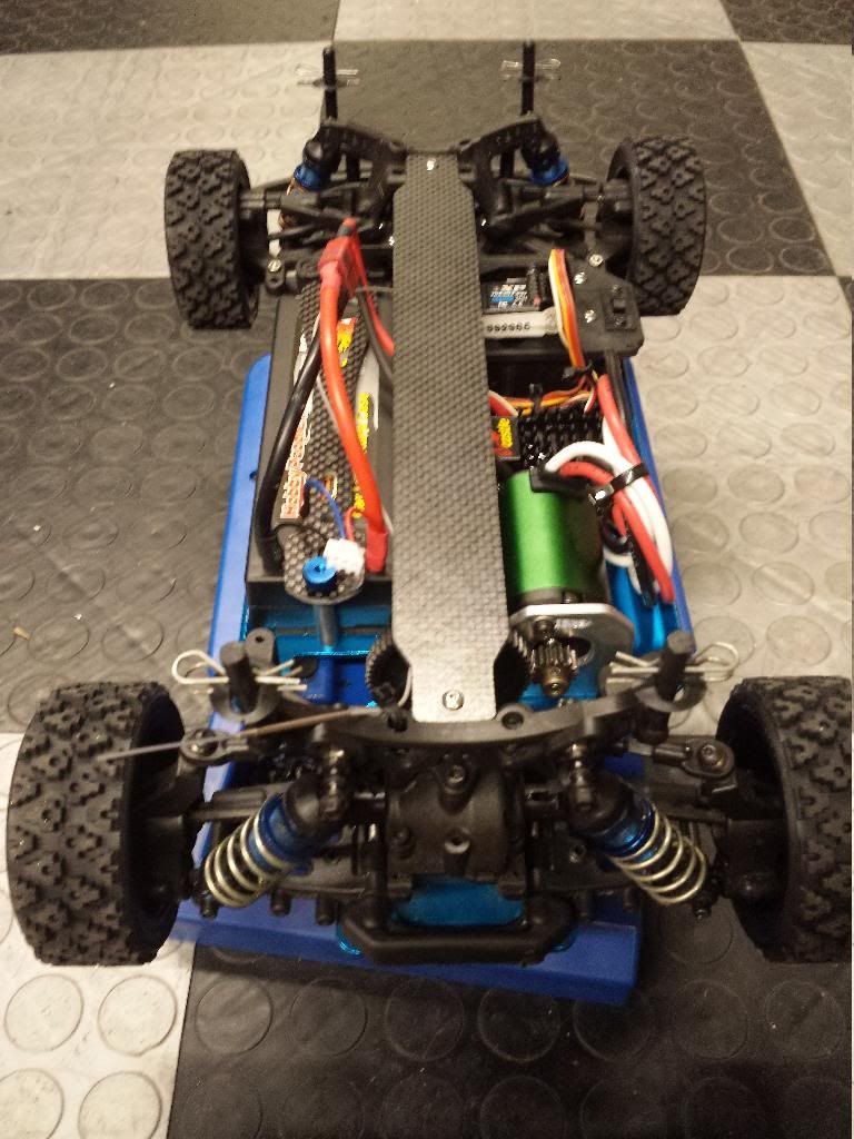

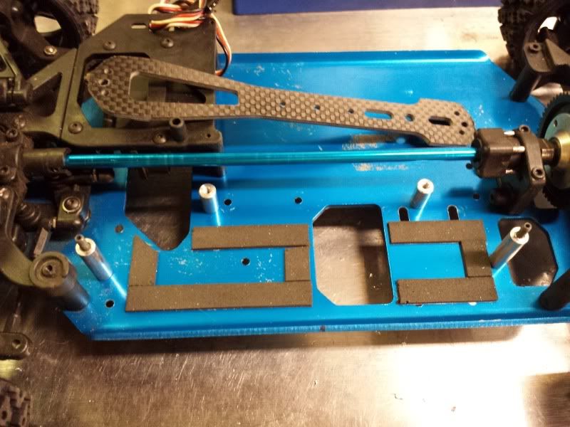

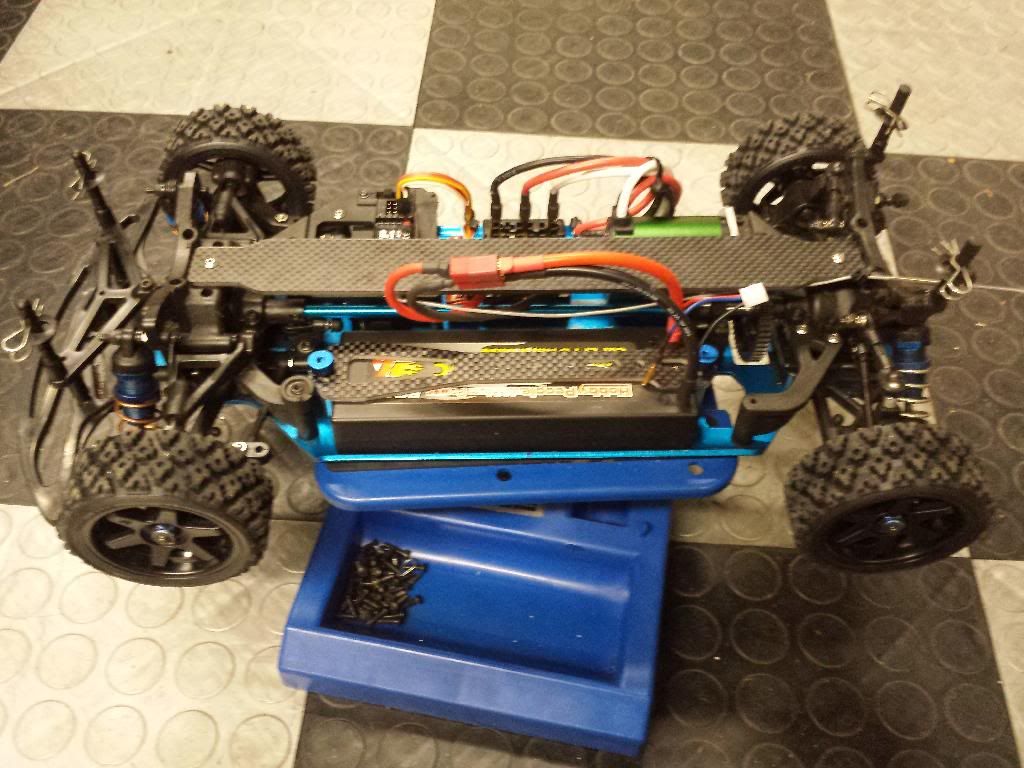

I also got the battery mounting all sorted out. I put a couple short aluminum standoffs in the inboard side to keep the battery in place, on the outboard side its constrained by the lip on the chassis. On the two ends I put standoffs to mount the cf strap I made from a chassis brace. I added foam tape to the chassis too to keep from rubbing off all that blue anodizing. That battery ain't going nowhere!

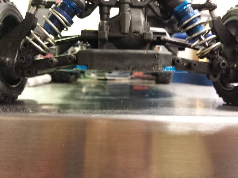

The ride height looks pretty good, although its maxed out here, so it will be a little lower when I dial it in.

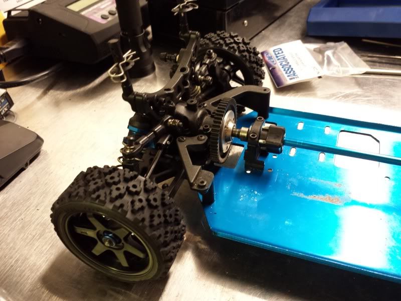

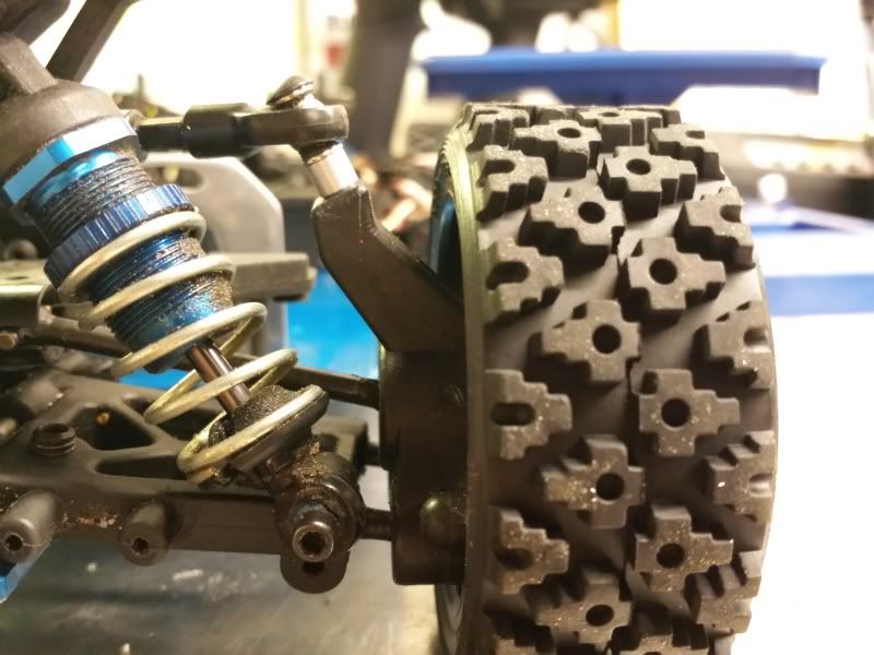

On the rear suspension, after a lot of experimentation, I figured out that if I space the camber links at the hub end by at least .140", it will have the full range of travel without them binding. And this is on the upper hole on the inboard side, which seems to maintain the suspension geometry best through the travel range. Basically, I just added 5/32 spacers between the ball joint and the hub, problem solved:

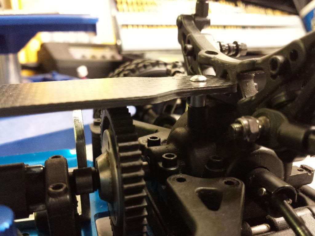

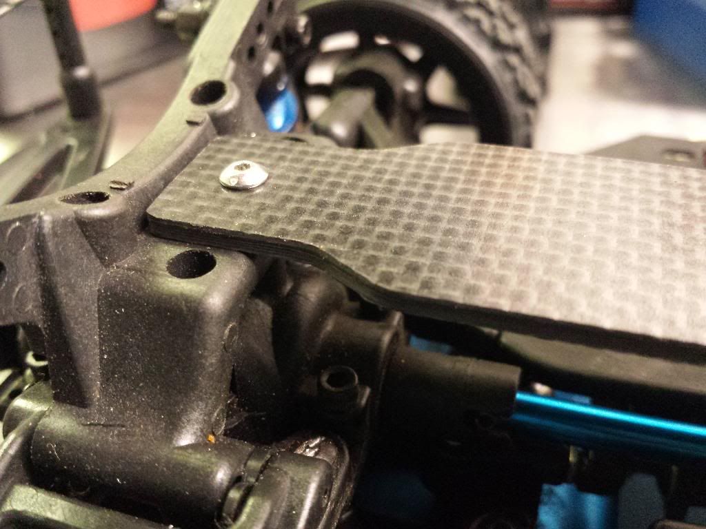

I got my cf chassis brace yesterday made by Seabass. It bolts to tbe front and rear trans cases. Fits perfect! The chassis is *really* stiff with the brace on, stiffer than my b4 by far

Looks good and it makes me even happier to have another person on the books that I have helped out.
If there is anything else you may need, you know how to reach me, now get this car finished :P

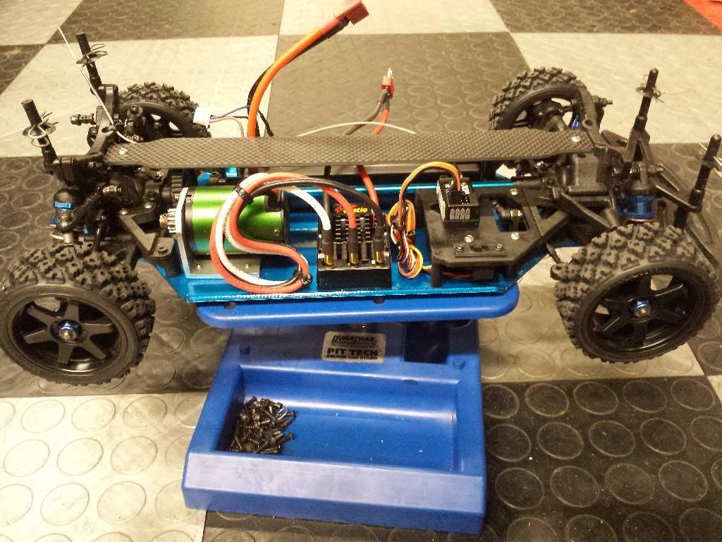

Thanks Jake. Hopefully I'll have it running by next weekend. I just need to tap the holes in the motor mount, swap in the .56 stroke shock shafts, mount the esc and receiver, and wire it up. I ended up buying a 4600 kV Sidewinder for it, should be pretty fast.

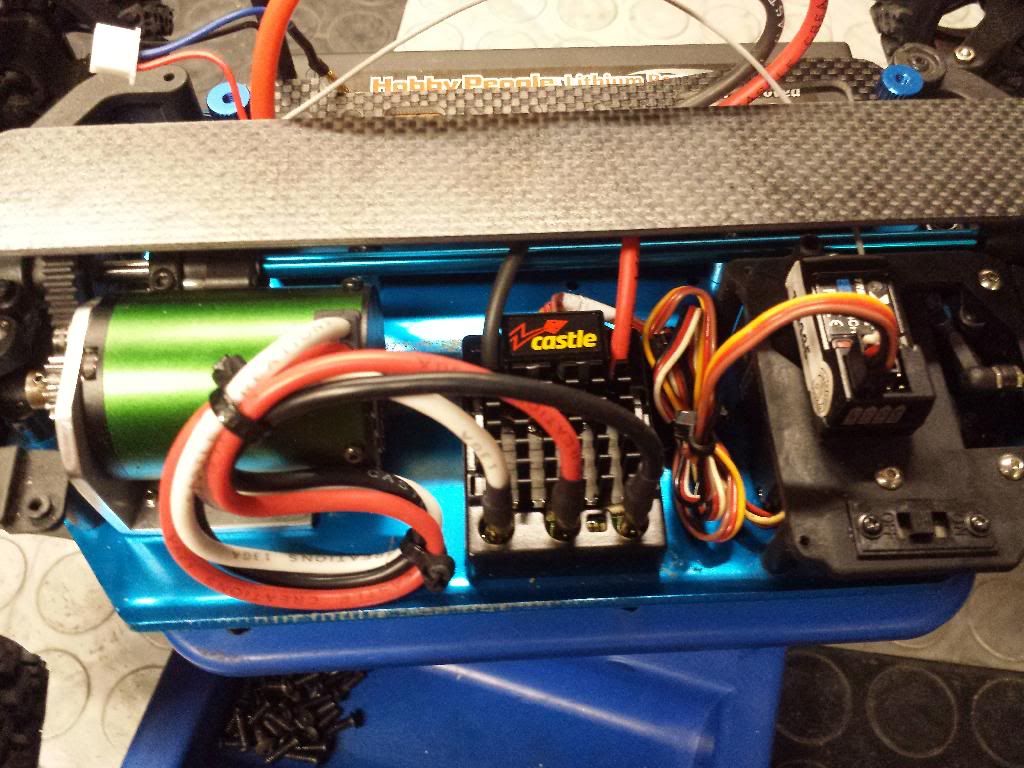

IT LIVES!
I drove it around the street for about 5 minutes in the dark last night :lol: It's pretty fast and handles great considering I haven't dialed it in yet. The acceleration is "bat out of hell."
