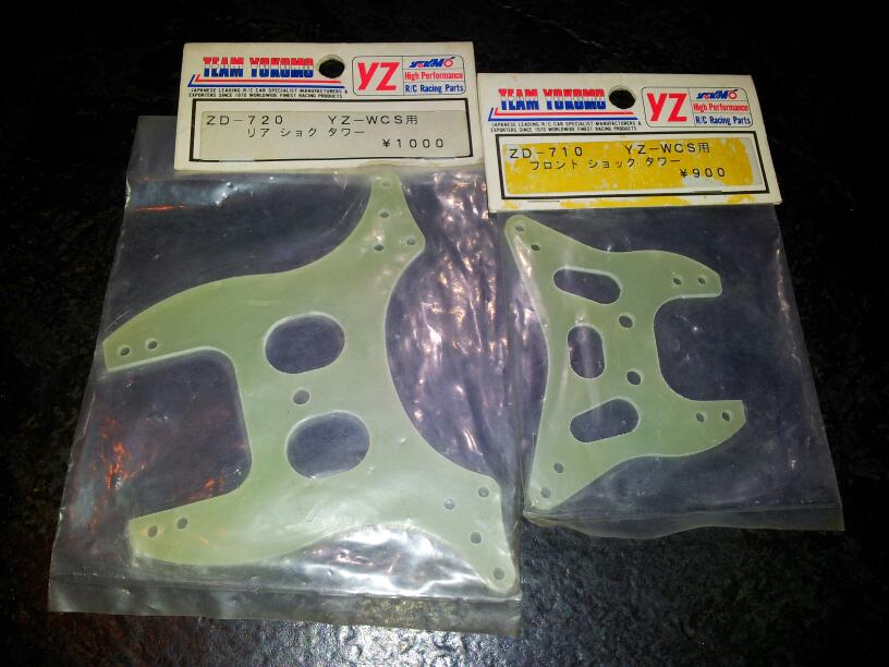

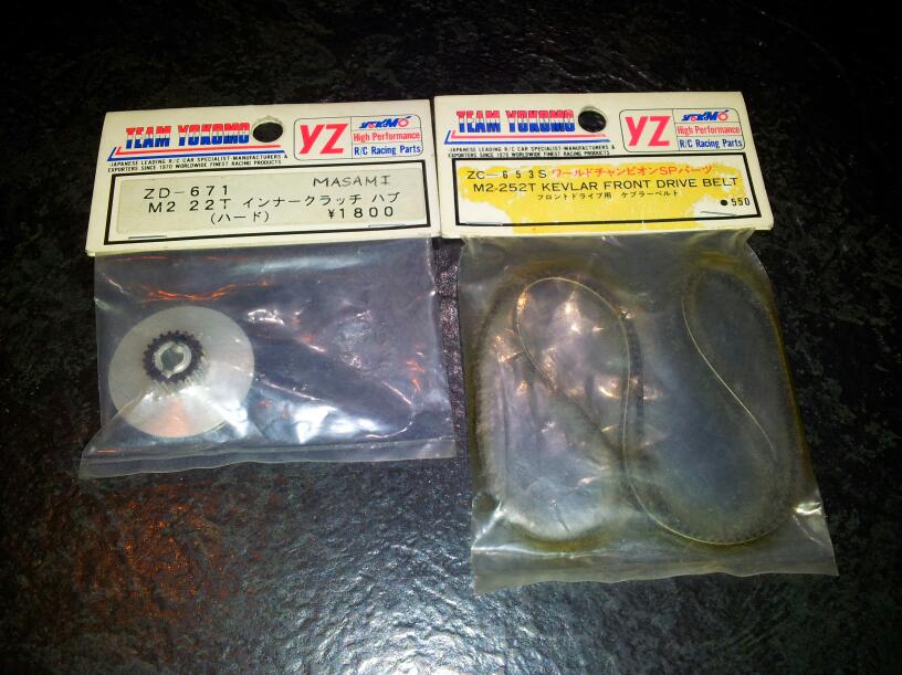

So far I found new front and rear shock towers, a new inner slipper hub (pulley worn), new belts, and carbon battery straps (they come with black posts). I still need to find the steering rack and top plate but I'll post pics of progress and parts within the next couple of days. I found a carbon top plate but unfortunately it's not the one I want.

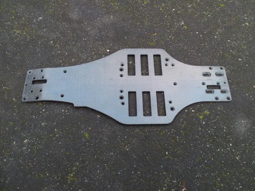

Here's the chassis after a bit of work.

Looks pretty dang good
I might concentrate on building a nice era correct race WCS, to go along with the race mods

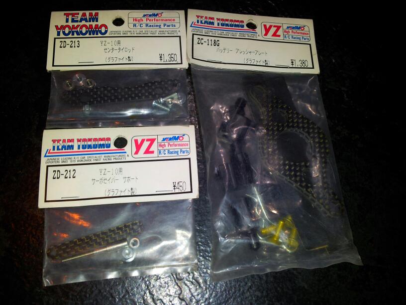

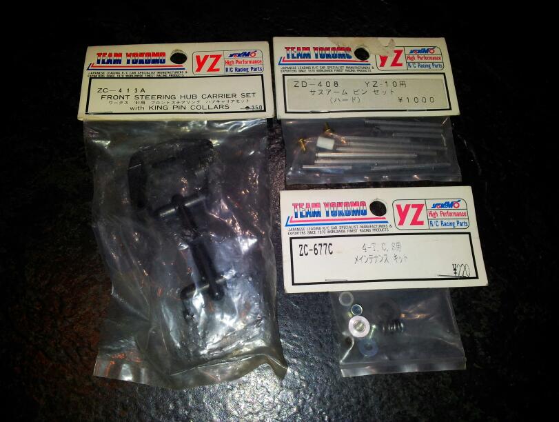

Here's my parts haul, hopefully I got the right parts. I'm not sure to run the carbon battery straps or the fiberglass ones, most photos show black so I'm leaning toward that although I like the contrast of fiberglass and carbon.
Same with the steering brace and rack so I may get fiberlyte fiberglass units to replace the carbon. I like Charlies idea of a period correct racer which carbon would suit, just not look as cool.

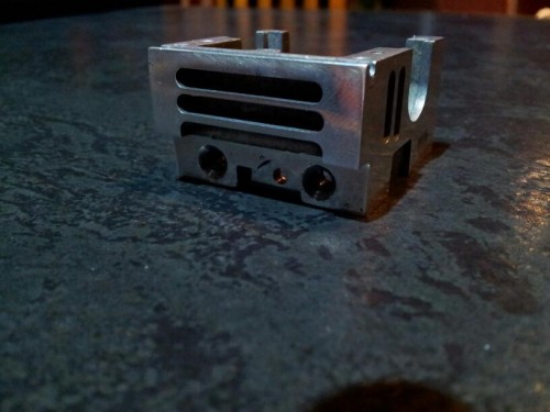

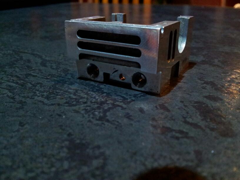

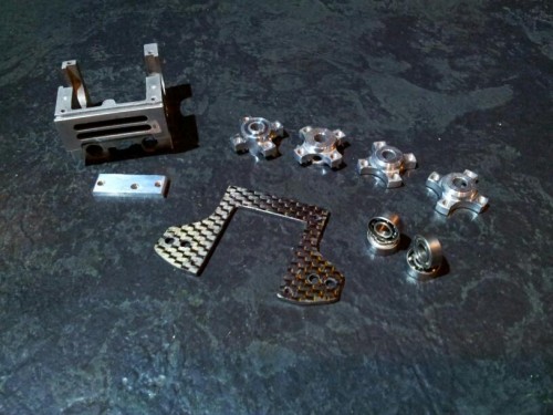

Again, not sure if these are the correct C-hubs as the ones on the car are different. These looked more "period" so I got them instead. I figured the person before me broke one and replaced them with a later model part. The other c-hubs were ZC-413C, which upon a search actually seem like the ones I need.
As for a picture of hubs and mods etc here's an all in one. The inner sheilds from the bearings have been removed, and I'm not sure if the little bulkhead plate is standard or not. I can't think for the life of me what would have bolted to it (something was at some stage though). It looks like someone center punched the bulkhead between the holes but didn't drill it for some reason.

The belts are 262t and 95t for the 2mm WCS, unless that rear end mod was specific to using the works 92' belts by design. The original steering rack and brace were fiberglass, and the battery straps were a different finish (as far as I have seen) but the parts you have there are correct.
Your car might have some real race pedigree with some of the mods I am seeing...

My bulkhead looks different to other 93 WCS's. Bummer about the belt, my belt is fine but replacing it couldn't hurt. Most straps look like black fiberglass but I bought those mainly for the black posts. I got the part number from Alex's WSC, although mine has an S at the end.

Every WCS that I have noticed came with white battery posts from the box. The rear bulkhead definitely has been massaged nicely. Masami also reworked (with a dremel) his rear bulkhead for Basildon to keep the rocks flowing out of the rear transmission-
