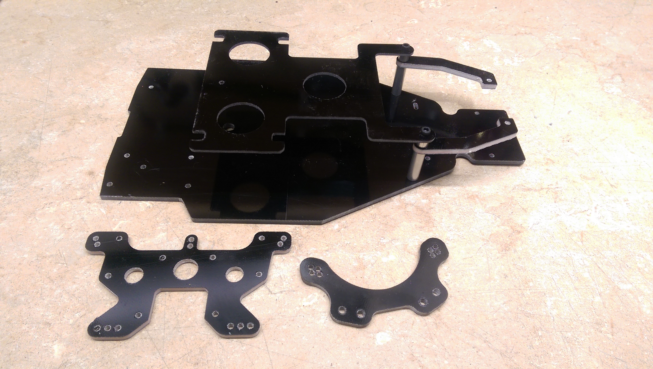

makes me want to take the extra parts and build a second Raider with your parts. Darn you jeff.
1 stock raider, 1 jeff special. (now if i can just find the parts i cant find online id be good)

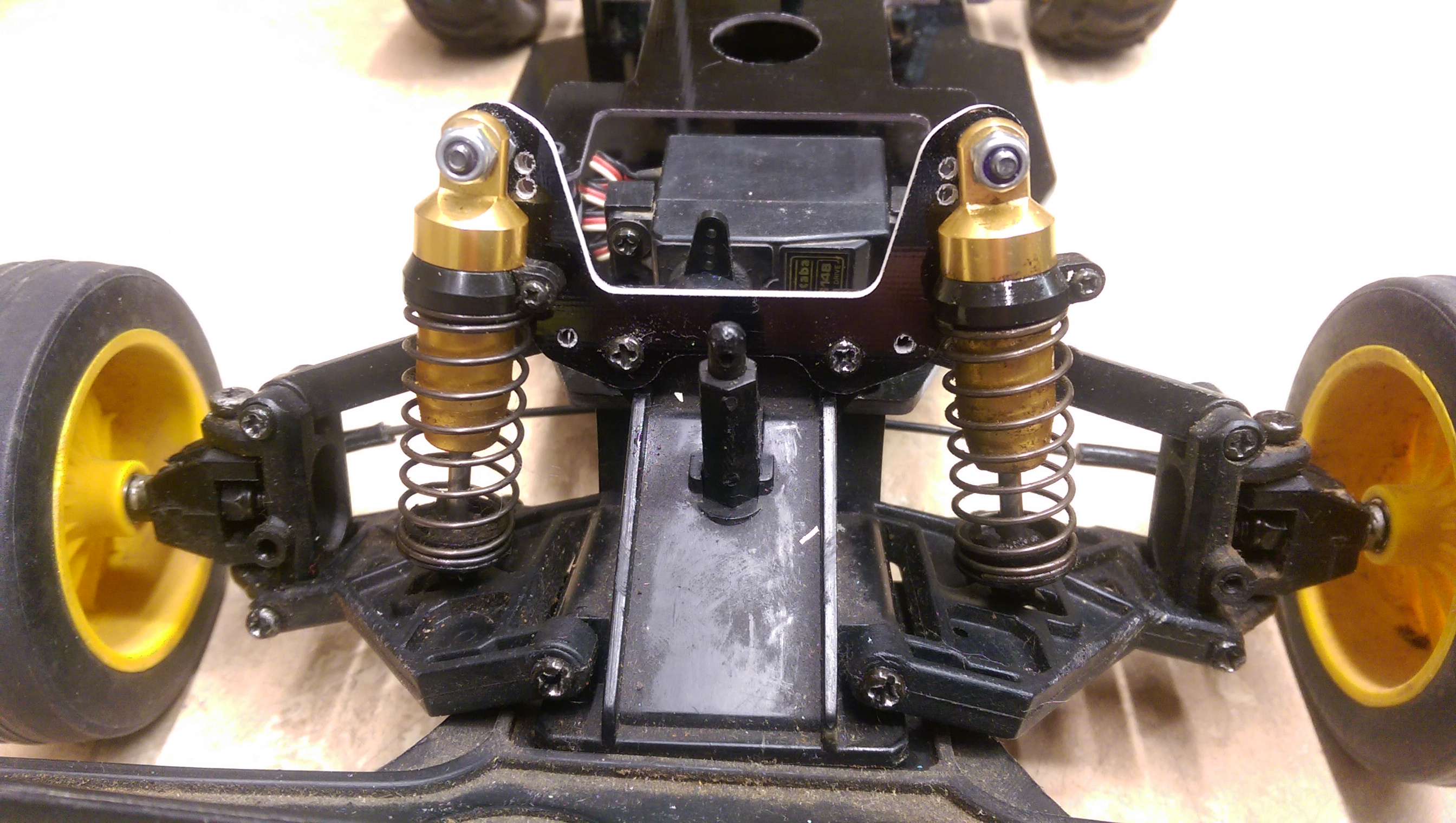

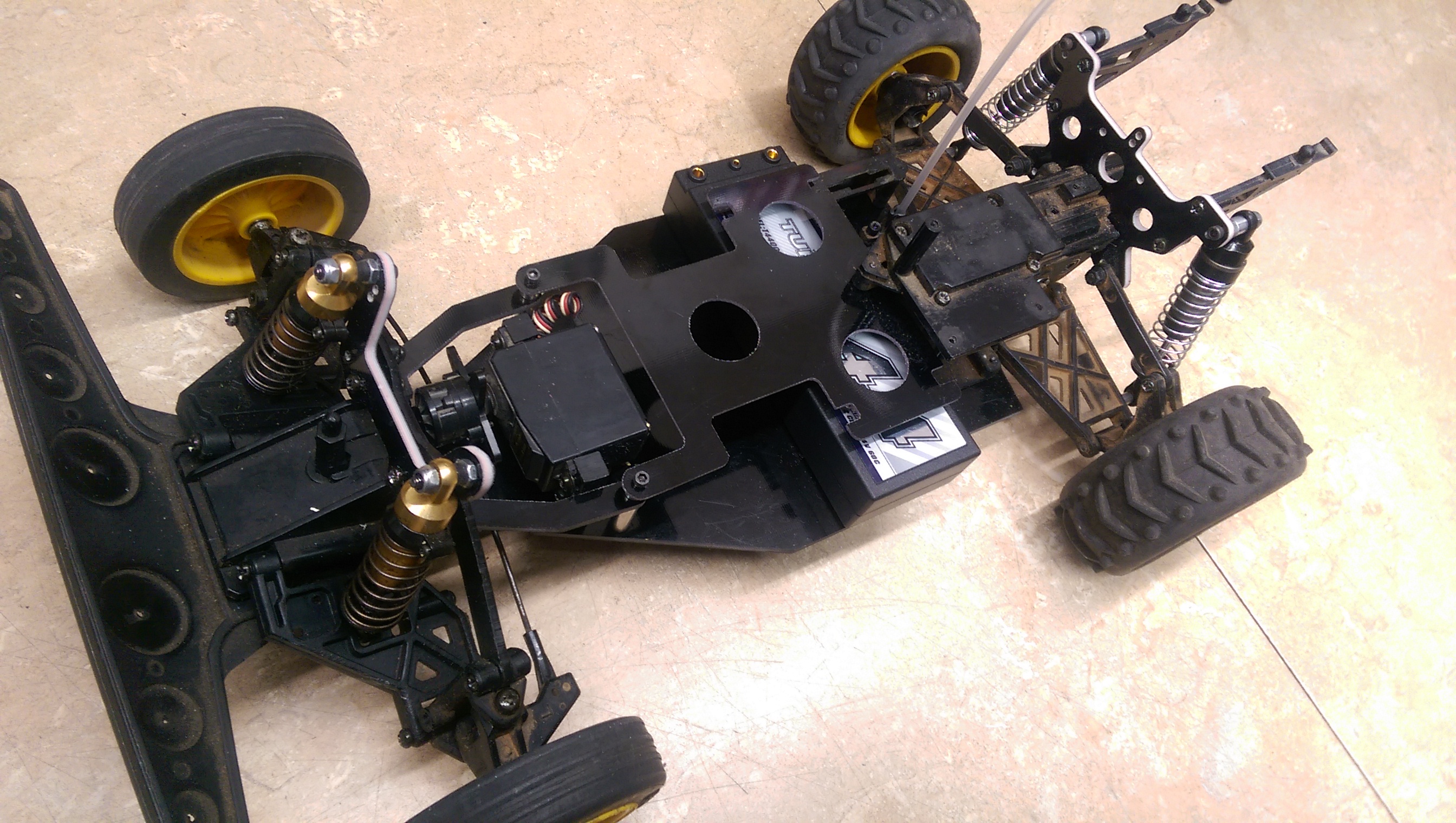

Re: Taking a Raider to the next level.... (aint saying much!
Nice going GomachV
Can you make a shot from a different angle on the front shocktower please?
12mm hexes... carefull with the wheels you select: the ones from the 22 etc have a much thicker crossection which makes it impossible to get your locknut on.
Also, look for something with a little more offset than most current 12mm hex wheels. The 1/16 E-revo wheels are usable for example

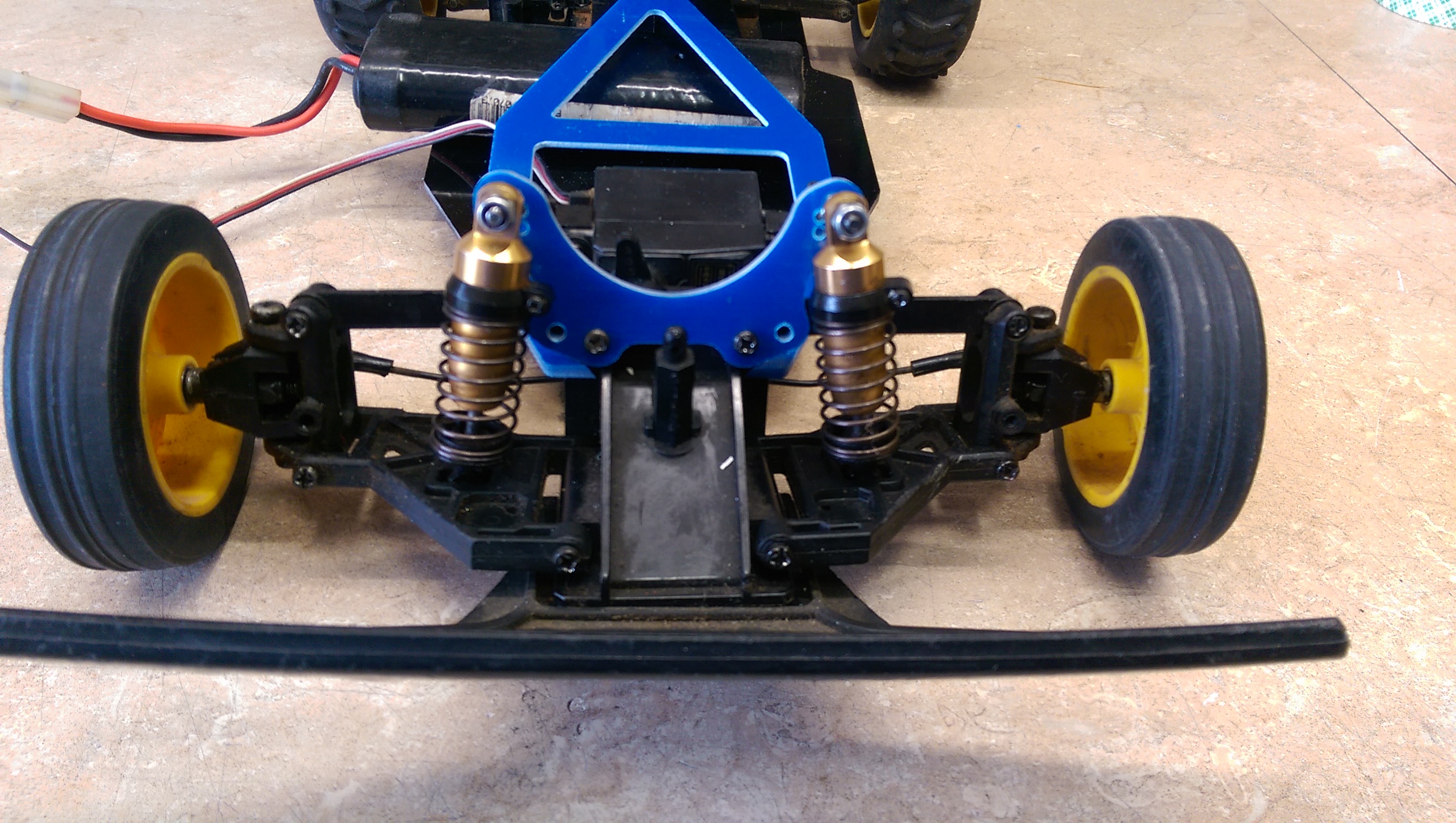

I wanted them as vertical as possible because the lower shock mount point is so far in. The two holes unused will be used when I get some adjustable ball ends on it. They brace the bulkhead nicely
We need some delrin arms. Hey, I think I can make those too
Lol! Gotta leave a couple parts original. Although....delrin trans plates and a trackmaster style trans.....hmm...LOL
Sounds great, but you're right: a raider build is a reader build.
I do hope to one day see another project though: a car you design and make every part possible yourself for.

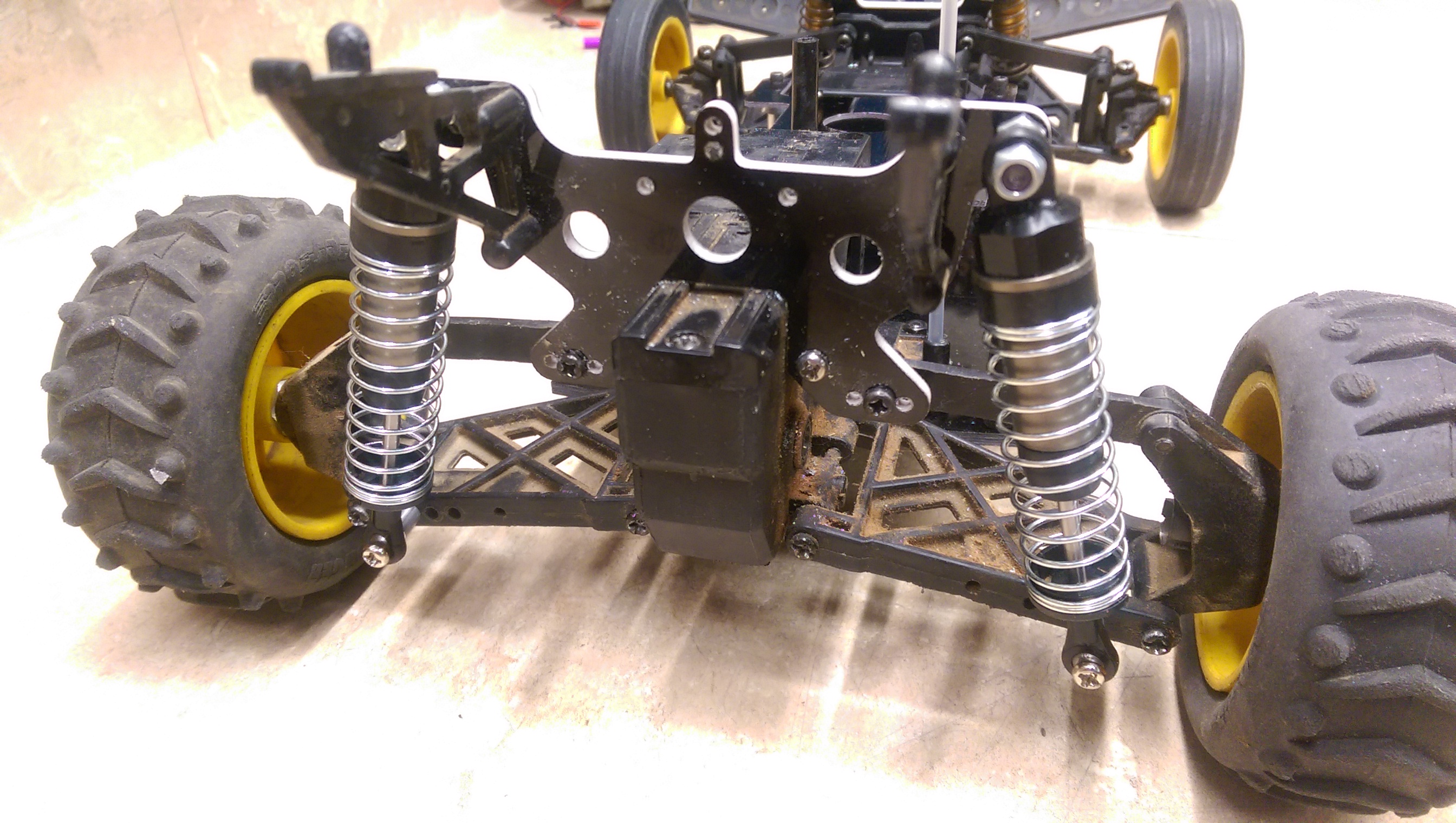

I've never personally tried it but as far as I know, A rear shock tower and trans top cover from a Rocky fits the Raider. The shock tower is aluminum, and the trans top cover is I think pot metal which adds rigidity to the rest of the trans.
The other day I unearthed my Raider Pro to put on eBay but fell in love with it again after seeing/remembering how mint it was.
- Posts: 12335
- Has thanked: 1129 times
- Been thanked: 3917 times
Yes both the tower and gear cover are compatible. I copied the bottom half of the rocky tower for this g10 tower. I need a cast cover for my rocky actually. I keep forgetting to look for one

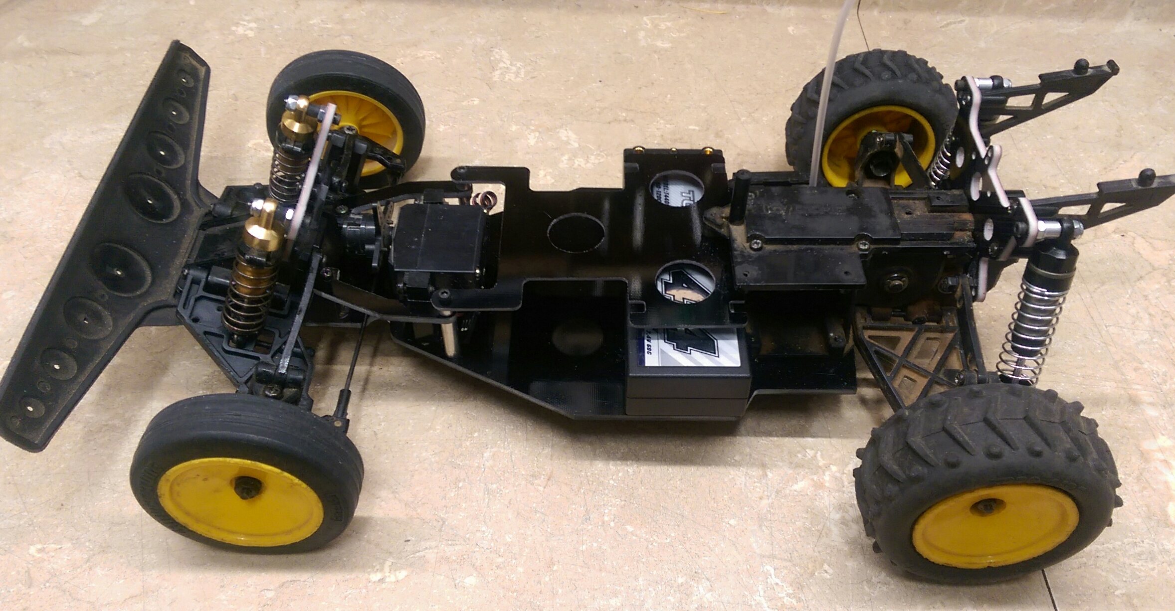

New upright rear shock positions, updated front tower, and got rid of the blue
