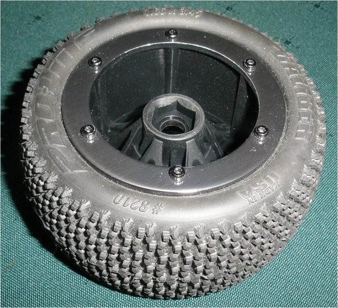

Well I finished up my work early today and drove back from Charlotte today.
I decided to assemble the wheels tires and see how they looked. I like them.
The tires are a little narrow for the wheels but not unusably so. I knew this going in as I could have purchased wider tires
but I wanted to see what the effect would be. Again I like it. Might not be for everyone but that's okay.
And here they are all assembled.

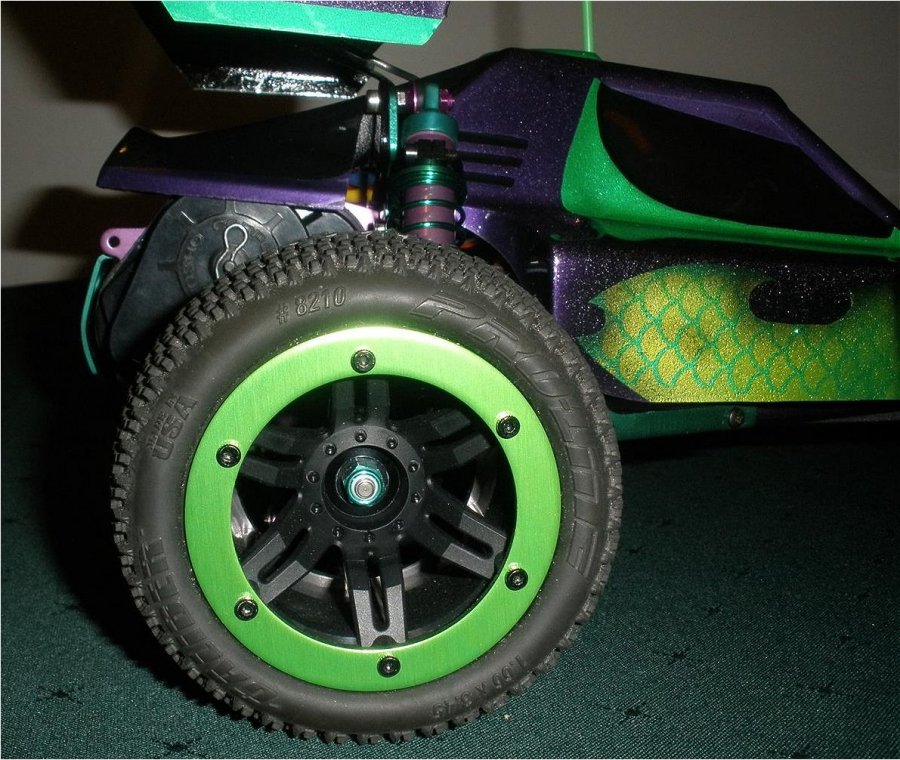

So I will begin assembling the diffs on Monday. I'm thinking I'll hold off on the anodizing for now until I can confirm the color I want to get.
The green (if it's not green let me know I'm mildly color blind) of the wheel centers looks good to me so I'm going to see if I can get that replicated.
If so I'll do another tear down and get the aluminum parts done that color.
I must say this rebuild has been a lot of fun. I'm excited to get this thing done and driving. Just a few more weeks I hope.

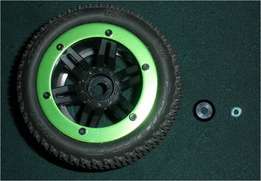

The drive hub on the wheels is a little too deep for the optima drive nuts and rubs on the knuckle. But I have a solution. I'm not at liberty to share it yet.
Not because I'm unwilling or wont share it, I just want to make it first. So be patient and I'll hopefully have something to show soon.

Thanks for the pictures. I had considered milling down the drive hubs so they would clear but decided against it.
I would like to get some nylon or delrin washers for the rim face to prevent scarring from the retaining nut.

I haven't even moved it to my shop yet but now I have a reason to do so. I also need to get a chuck and some tooling.
I used to have a lathe 15 years ago but had to let it go during a move and don't have much of the tooling left. What I do
have probably won't fit too well as it was a different animal.
So the plan is to fabricate my solution to this problem. We'll see how it turns out. (Pun intended)
About a year ago I traded a trailer I no longer used for this.

Awesome, wish I had machinery like that!BoostCreep wrote:Thanks for the pictures. I had considered milling down the drive hubs so they would clear but decided against it.
Milling down the hubs would be perfect...you can also buy thicker drive hexes. In addition to the ones that come included with the Optima, Kyosho made a thicker and thinner set of hexes. I have both of those sizes, I'm actually using the thin hexes with CYANide to narrow the track width so that the wheels & tires would more closely fit the HPI body.
How about cutting out some little round disks from some leftover Lexan to use as wheel surface protectors?
Looking forward to it...make extras, I might be interested in some.So the plan is to fabricate my solution to this problem. We'll see how it turns out. (Pun intended)
