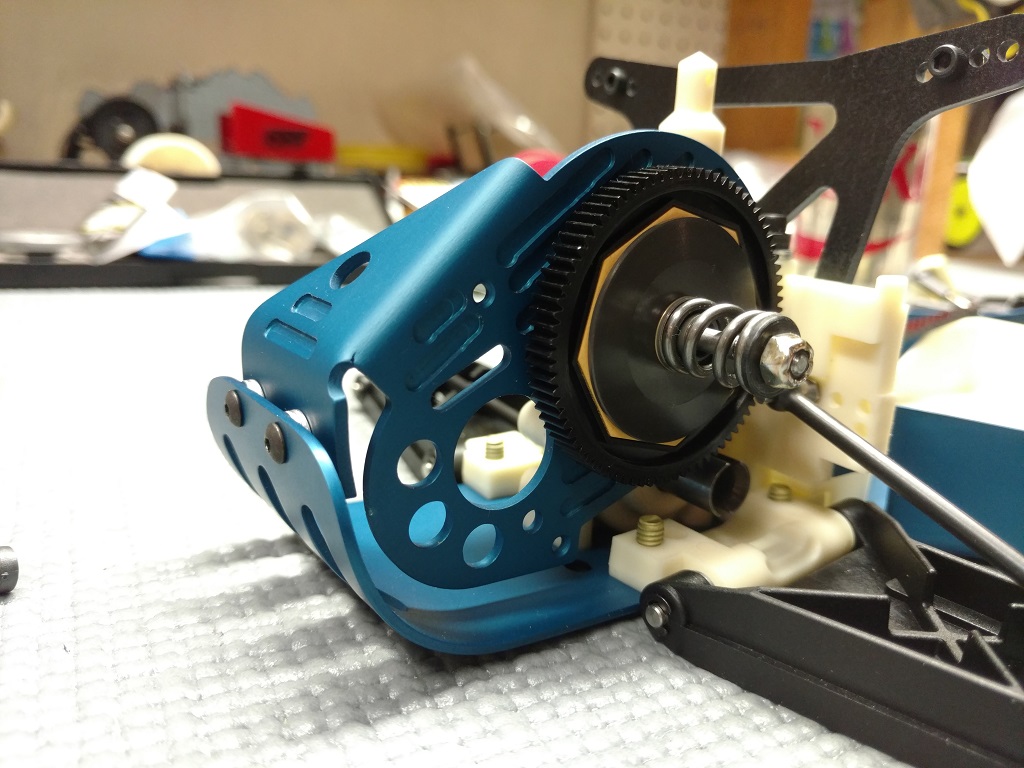

Is it difficult to mill the motor plate? Where did you get the motor plate milled?
I bought a Jconcepts motor plate for my Worlds re-re but would love to have a more authentic old school look.

Jake milled the motor plate for me while he was cutting my carbon stuff.
jwscab did the milling on my Satoshi Maezumi build (re-anodized afterwards). Maybe he would be interested in tackling another?

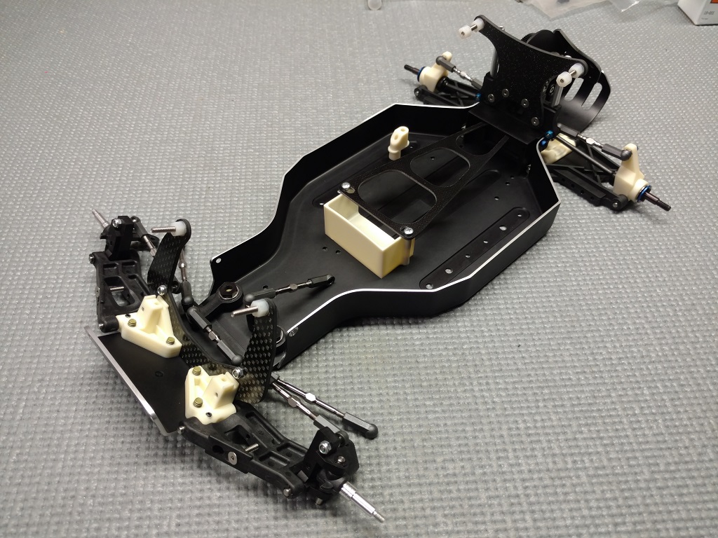

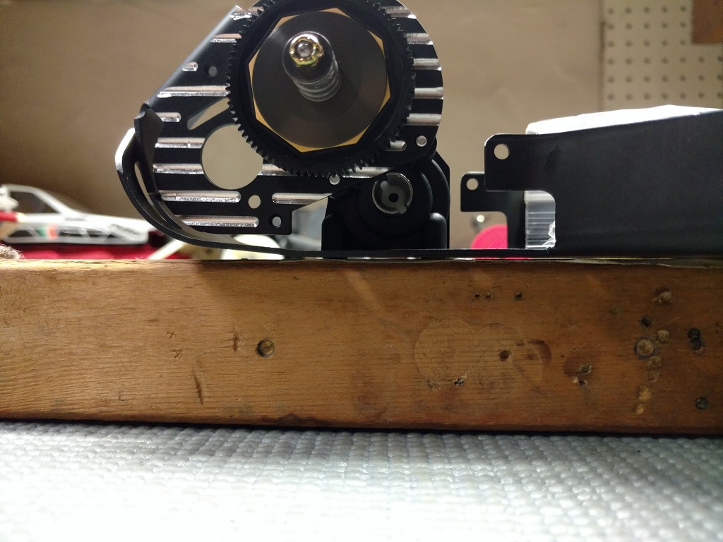

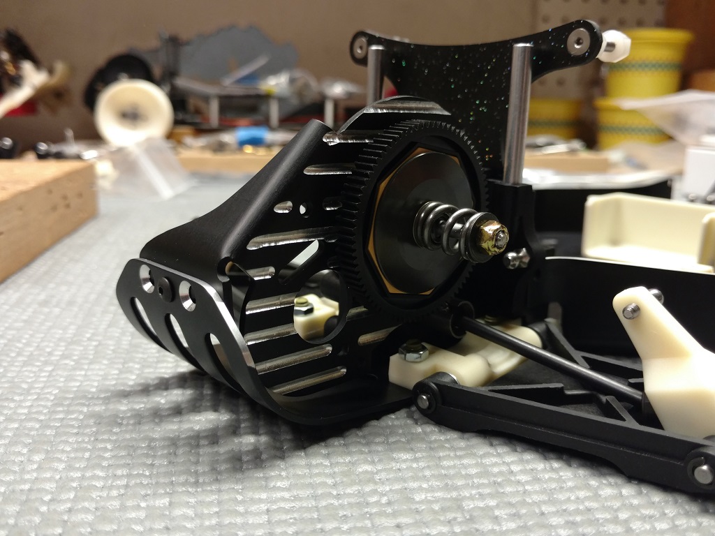

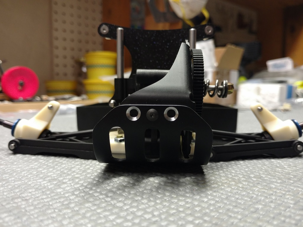

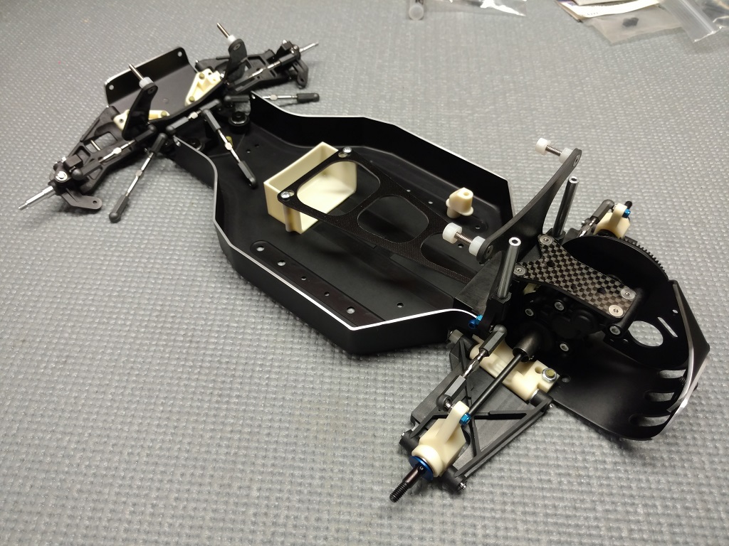

Got a little work done on this. Bent the chassis up in the back (i'll explain) and finished up the alterations on the motor plate. Shortened the wing tubes a little bit too.
I was showing some progress pics to Brad Reelfs of the tub mods and he asked if I was going to bend the chassis up at the back. Thinking back to Cedric's build I didn't remember that being covered. So I asked what he meant. He said there was a jump section that guys were having trouble with on landing, so either Roger or Curtis went around and bend the rear of the chassis up behind the arm mounts (similar to a B2/B3). This is the reason for the single center screw at the back. I marked it up, put it in the sheetmetal break and bent it up about a full hole at the back.
So this is where it's at until some more hardware comes in. I'll start to get the turnbuckles and shocks built awhile.....
I had some better pics I wanted to attach, but half of them wouldn't upload. Ever since the upgrade i have nothing but problems with pics on here......

Re: Scr8p's Worlds Re-re #3 / Modern Kinwald Replica
Looks awesome!
Nice and crisp
Hawk eye Scr8p! I never notised the 1/2" aluminum screw at the back of the nose plate
Nice and crisp

Yeah. It took awhile for the screw to jump out at me. The angle cuts on the front corners of the tub, too. I only saw those when it came time to start my build. All those years of seeing the original and never noticed it.
There is also a pair of battery box holes about an inch ahead of the factory ones. Must have run a side by side 7 cell pack in that car at some point. I didn't put those in it though.

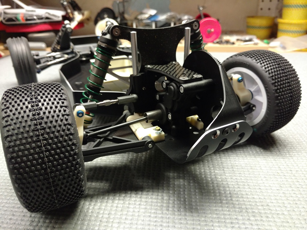

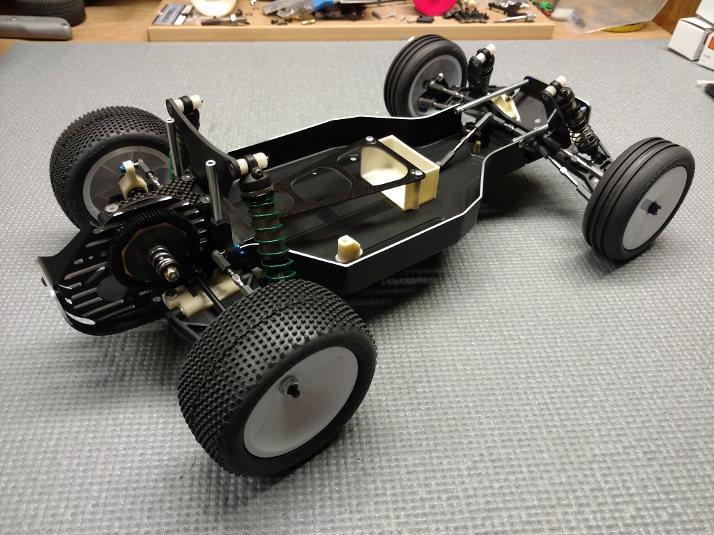

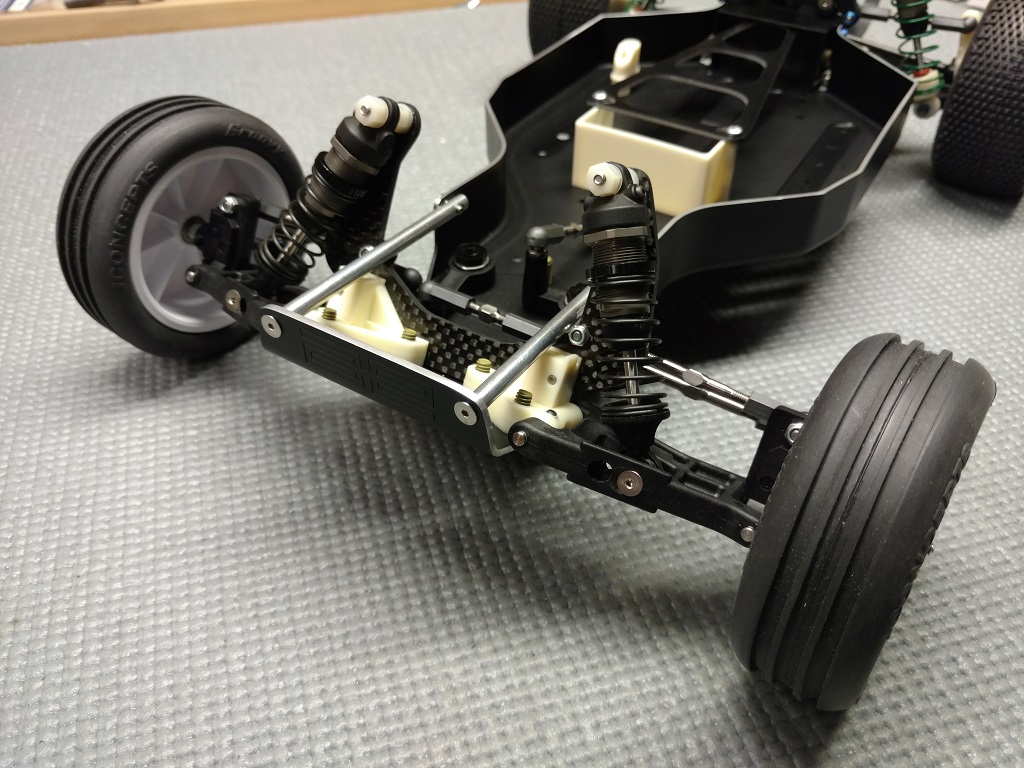

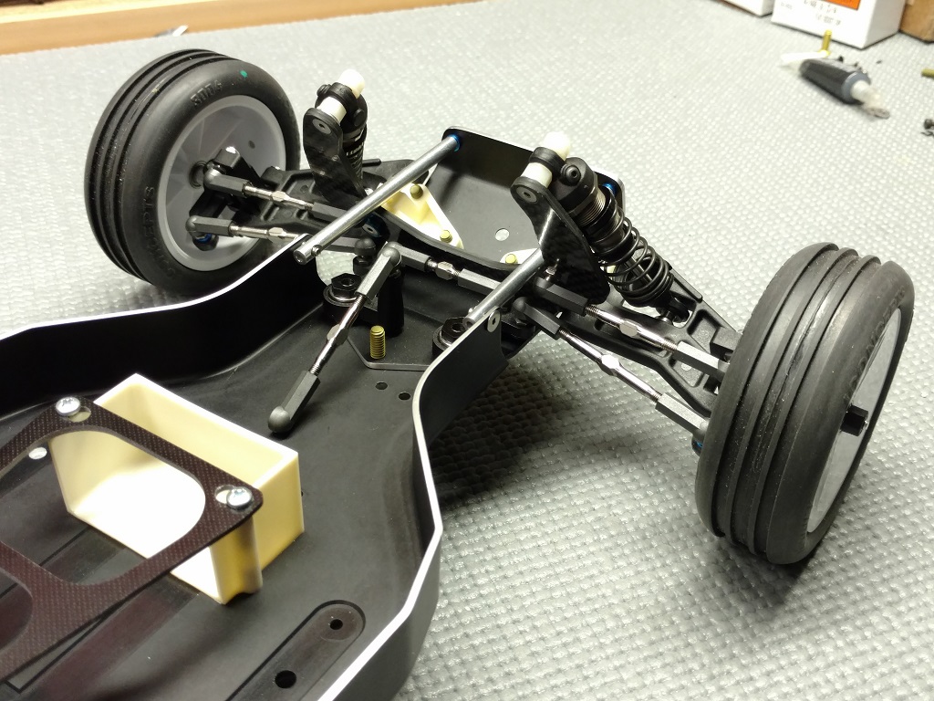

Here it is as a roller. Tires are temporary, I'm still trying to figure out what i want to put on it. Doing a hypothetical....... If Kinwald was back at the '93 Worlds..... same car, same track..... but had access to modern day tires, what would be his go to tire? I've talked with Jason Ruona and Brad Reelfs about it to get their thoughts. And, sent Brian a message on FB to see what he thinks. Haven't heard back from him yet though.
Ughh.............. still with the pic issues.
Well, here's what would actually load.
