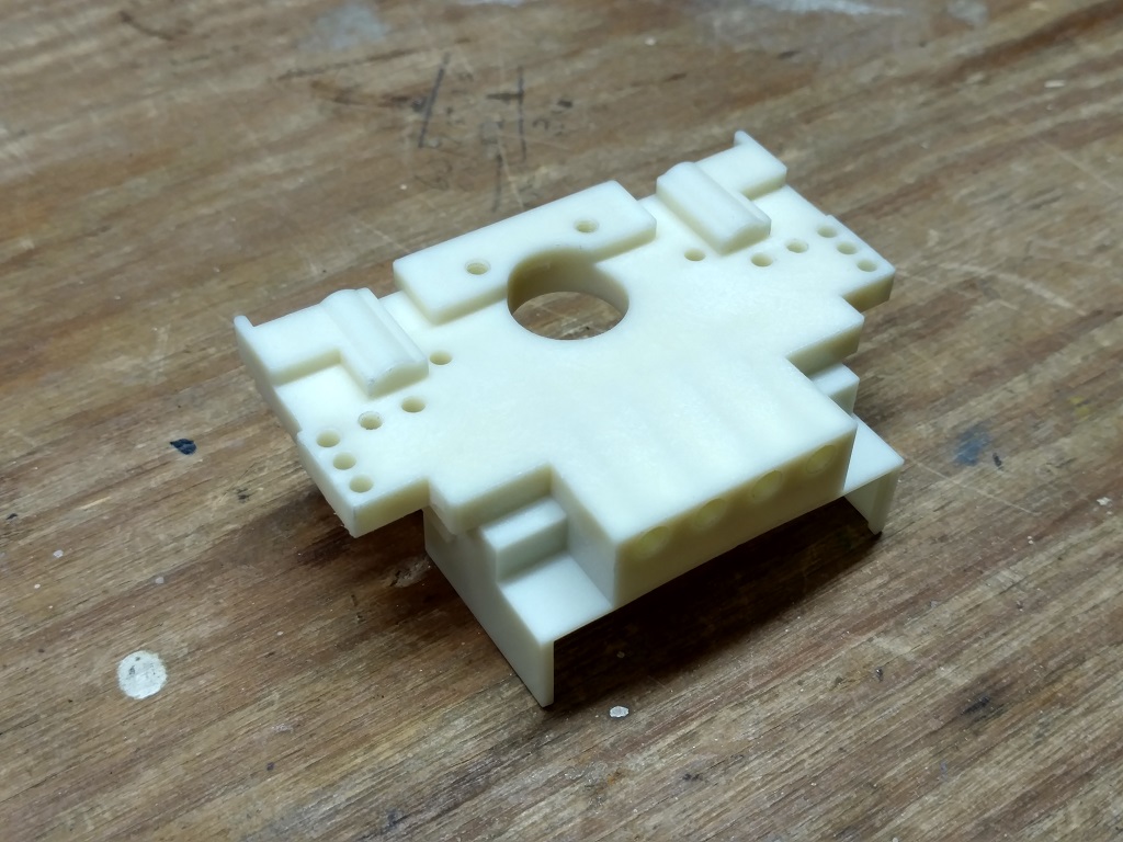

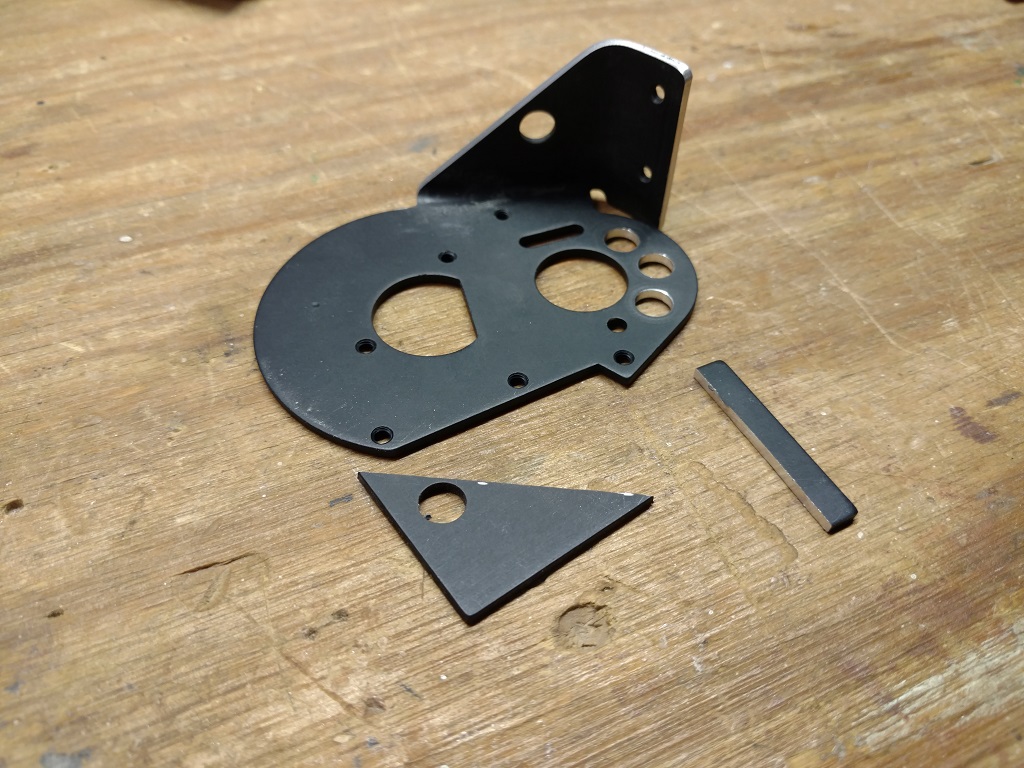

First on the agenda was to grid out the motor plate quick to give Joe an idea of what I'm looking for.

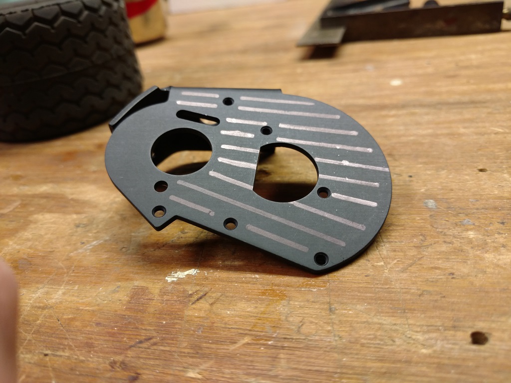

I also altered the bulkhead to match the old Worlds style, including the camber hole.

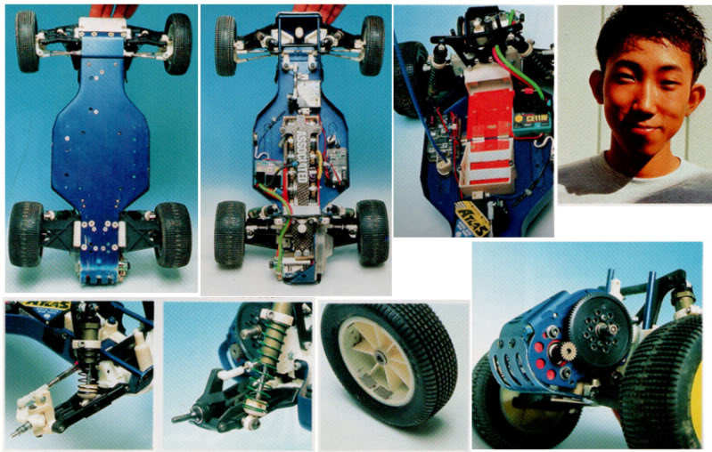

One, possible two, more pic(s) from Maezumi's car:

Jirka wrote:Remember to put tire balancing weights to same places were Satoshi had them :wink: .
I still have a roll of it. :wink:
I'm up in the air with what I want to do about wheels. He used white wheels with yellow wheel dots. If the yoke and reedy wheels dots weren't so expensive that's what I would do. I may just get a sheet of yellow vinyl and make them myself. I plan on running the standard rc10 axles with widebody b3 wheels since i have a stack of them, and I'm going to run the 2.2 Traxxas 7171 hex wheels in the rear. They're white, but have a nice flat face to put the wheel dots on and I won't have to worry about them flying off. They also slightly wider than the rere kit wheels so the tires don't balloon as much.
http://www3.towerhobbies.com/cgi-bin/wti0001p?&I=LXZRJ7&P=FR&gclid=CKKhyqPd5NACFQ6BswodXtcO8Q
But it would be much easier to just run yellow wheels. :lol:

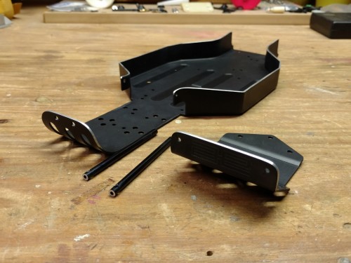

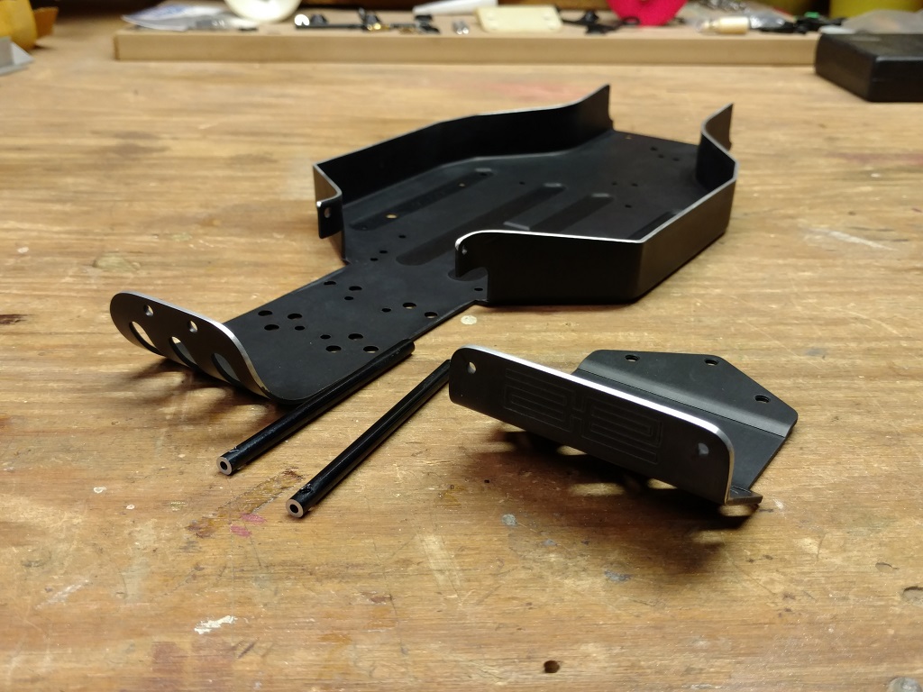

Got a little more work done to it tonight. Rounded the corners on the nose plate and rear chassis kick-up, cut the sides down a little bit, and shortened the nose brace tubes.

Wow, nice hand-fab on the chassis!
