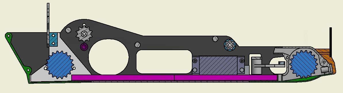

Where is the lower part of the chain going to run? It looks like the pink parts are obstructing.

The pink part is a radiant style chain guard/cover and lower brace. It's hollow inside and the lower plate encloses the chain.

Correct. Here's a cross section view through the center of the guide:

Ah! Cool!

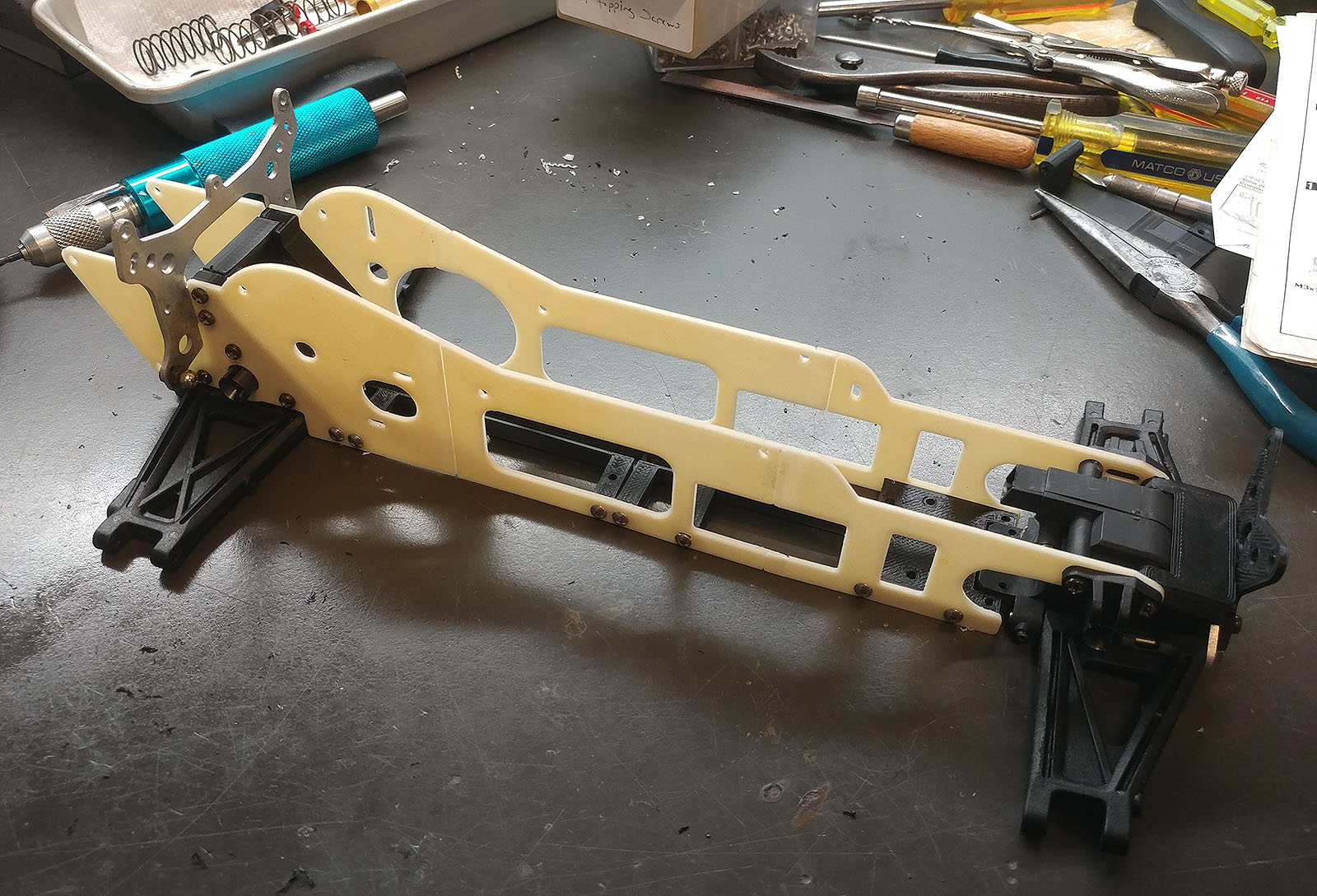

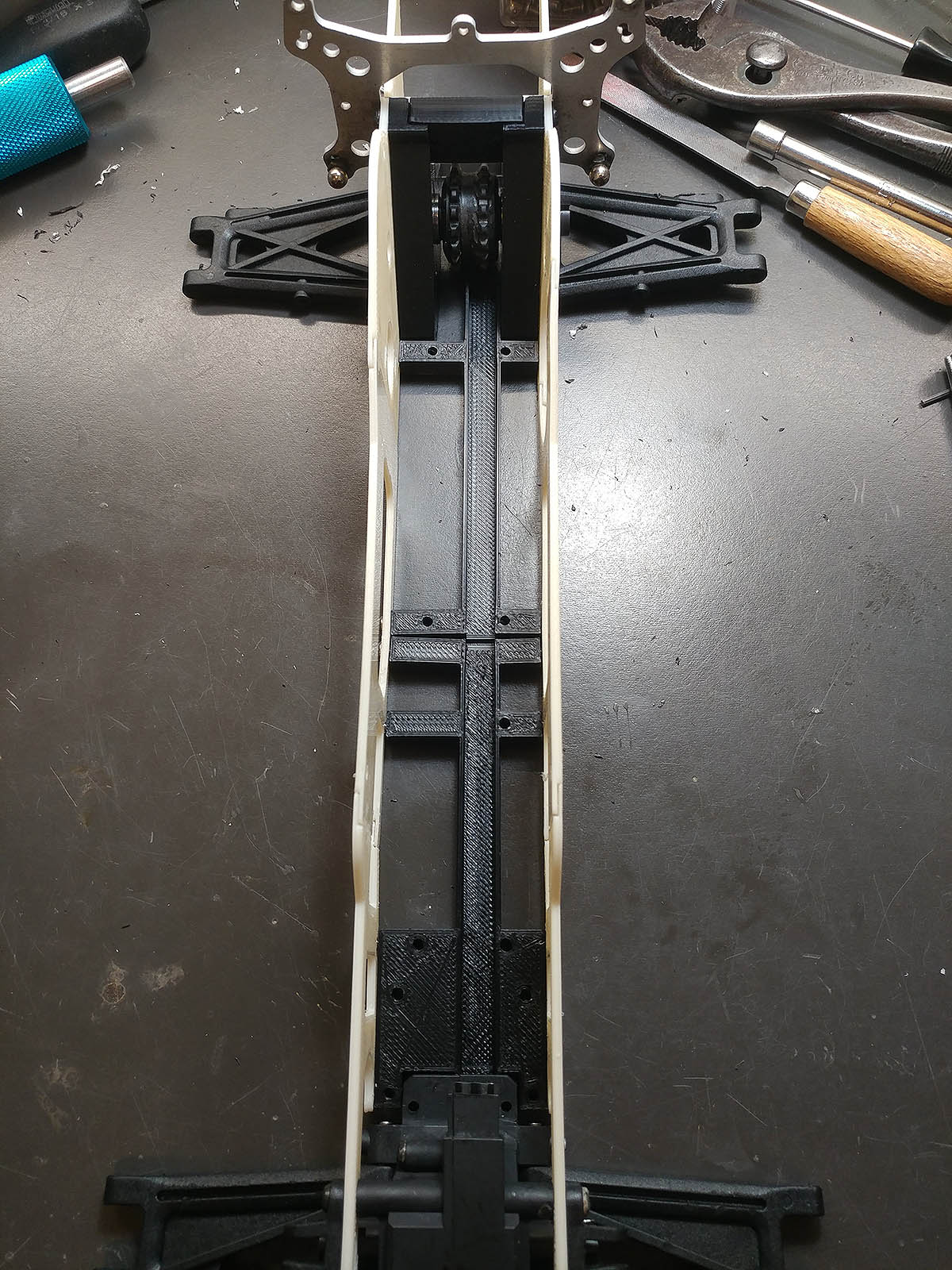

An update. I've had printed parts, and a donor Turbo Optima, sitting around for months. But, I've finally had some time over the holiday break to break the donor car down and do a trial assembly. It's coming along well and I've already seen a few things that can be improved. The chassis side pieces are 3D printed for now; I'll go with fiberglass, carbon fiber or aluminum for the final build. Or I may try printing a carbon fiber nylon. And I have a name for the car: The Turbo Pro Optiant :D .

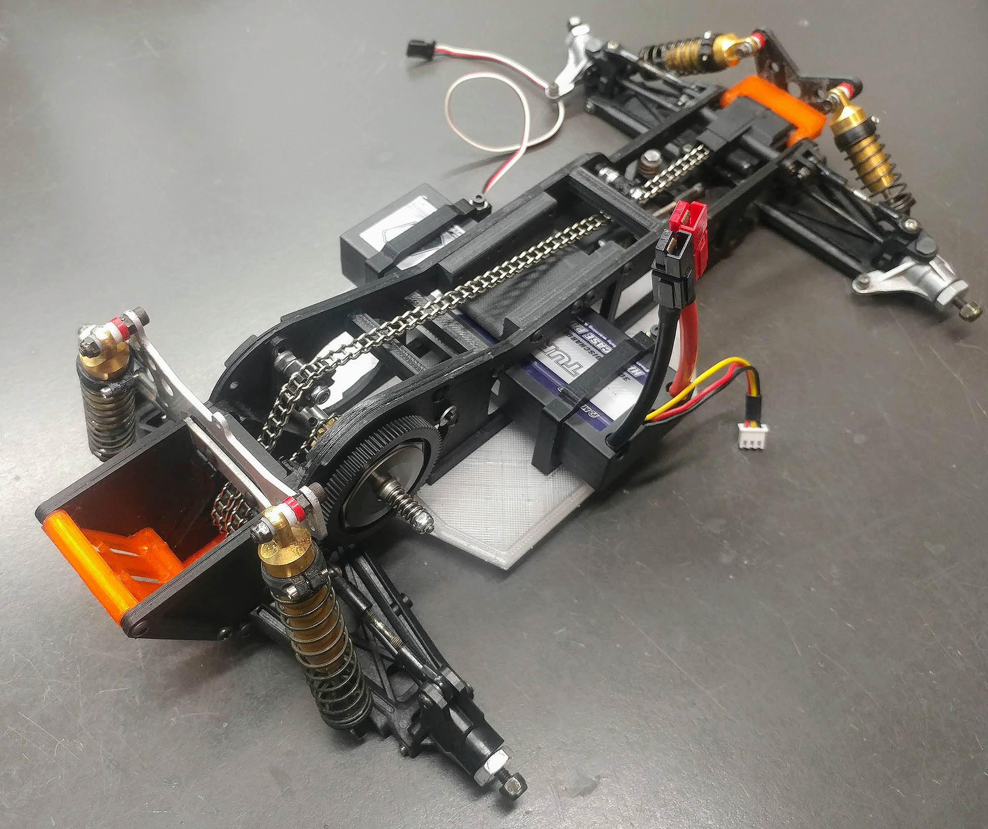

Post by ROH73 »
Slowly getting there. Should be the final version of all the printed/fabricated parts...until I run it and something falls apart in the first minute :D .

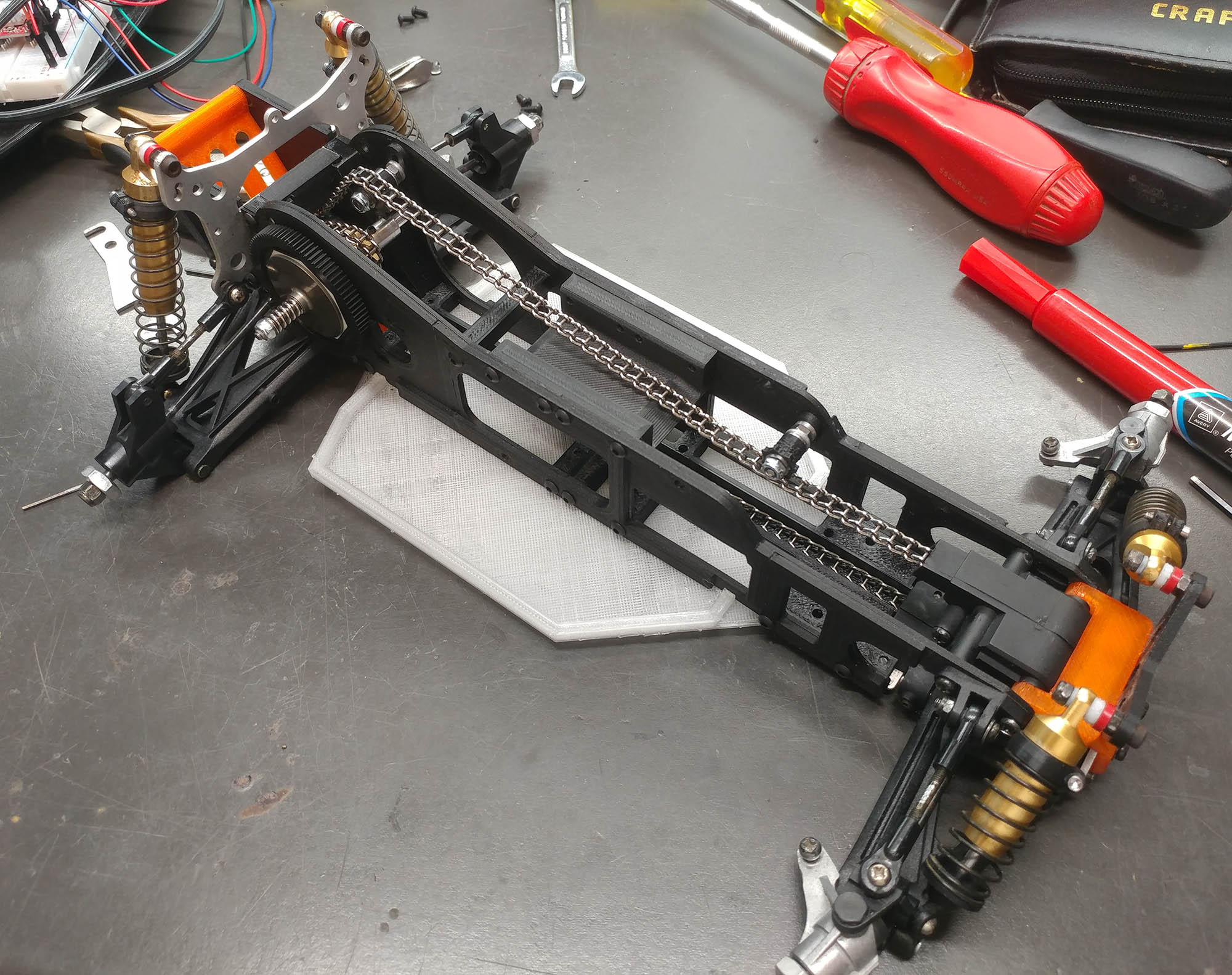

Post by ROH73 »
Made some more progress today. Got the steering servo in, battery mounts installed and an additional chassis stiffener behind the spur gear. At this pace, I may actually get to test run it (sans body) this weekend! :shock:
