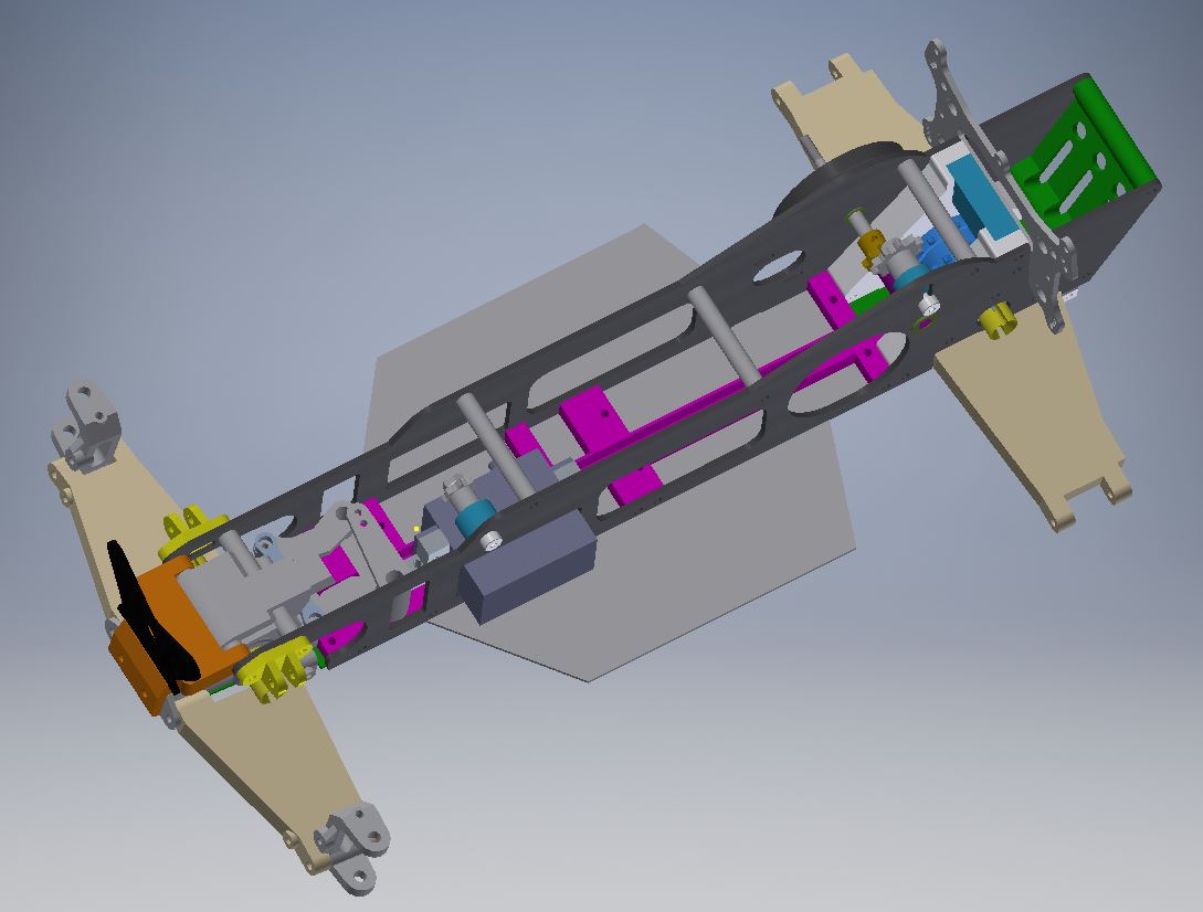

I'm finally getting some time to work on a project that I've wanted to do since about 1989. I actually got started on it in 2011, but life got in the way. Six years later, I'm back at it. The delay is probably a good thing, as the project is more feasible now, with the ability to easily 3D print. The CAD work is about 50% done, so below is an early image.
I will call it the Turbo Pro Optiant :D
I hope to be cutting material and printing within the next few weeks to a month. So, probably in the Fall. :lol: In any case, I think it's a good start and should be fun.

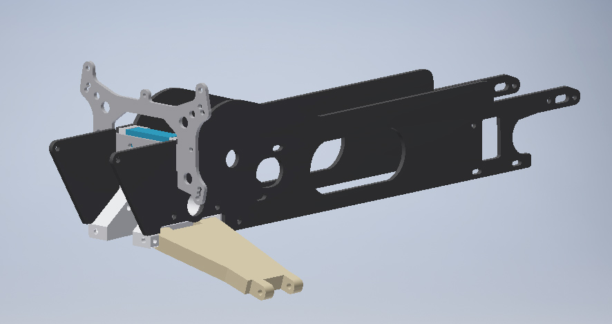

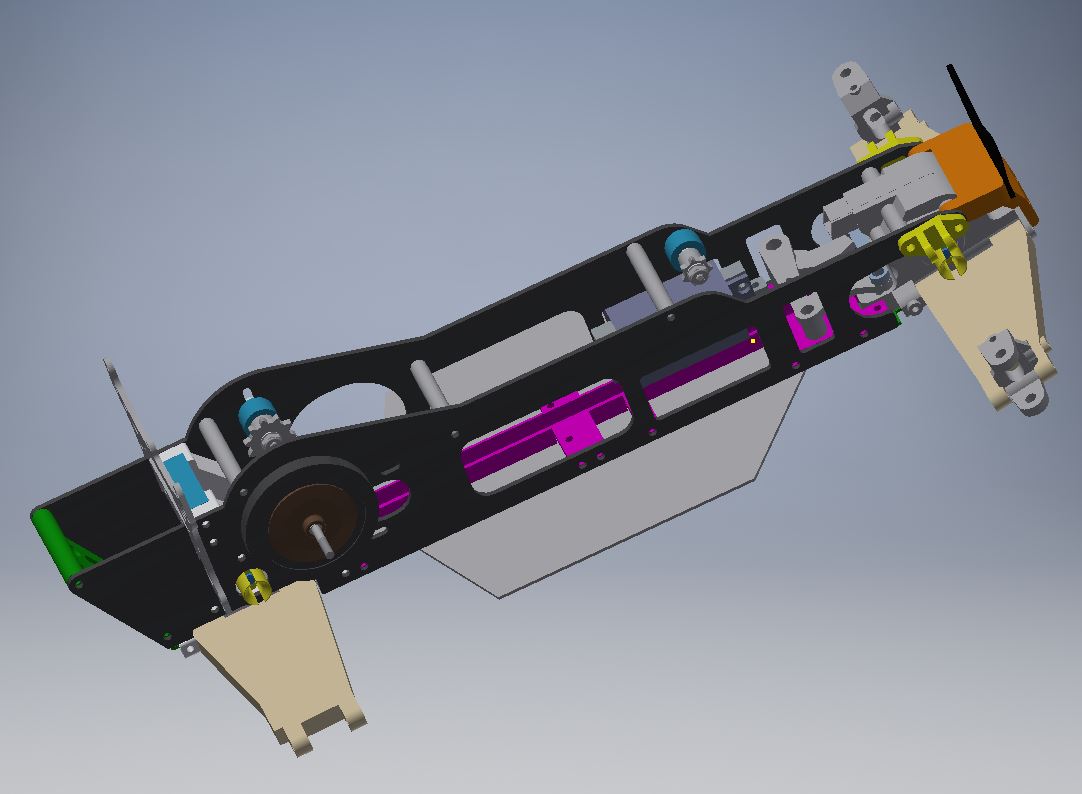

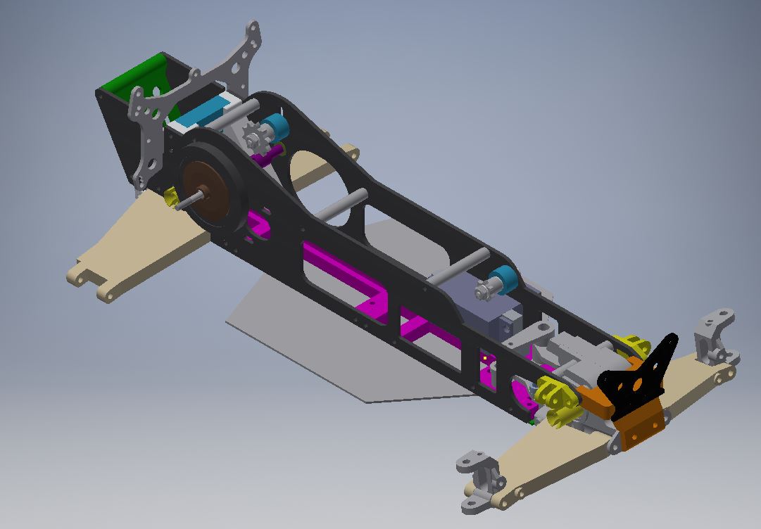

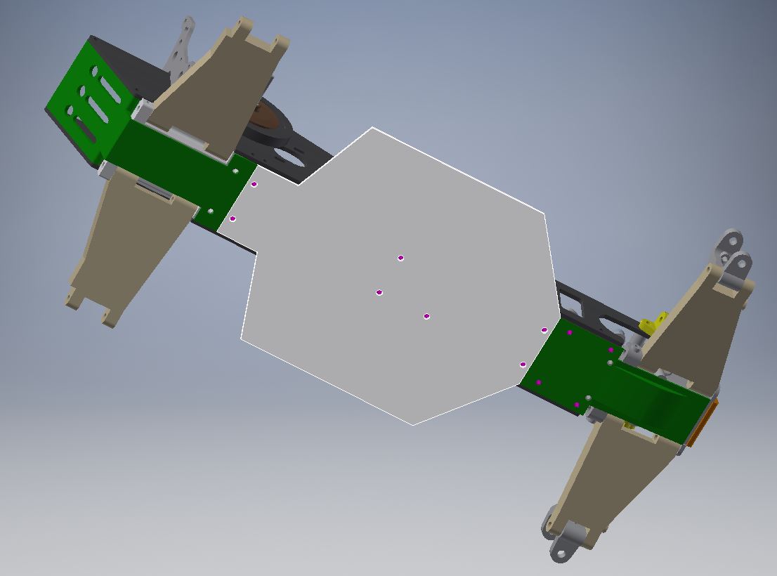

It's been a while, but I'm still working on this...
I'm getting much closer to the build, however. I'm ready to fire up the 3D printer! :shock:
I decided to make the front end look more Pro Radiant-like, with a new shock tower mount and slightly altered shock mounting geometry (shock bottom will attach to the A-arm instead of the hub carrier). The stock Turbo Optima tower and geometry could still work just fine, though.
No Optima parts need to be modified, other than lengthening the front-back chain and making a short drive chain.
I still need to design battery mounts.
So far...
New carbon fiber, fiberglass or aluminum parts are: left and right side chassis plates, bottom chassis plate, front Pro Radiant style shock tower
New printed parts: rear differential housing, rear shock tower mount, rear guard, front shock tower mount, lower chain guides, tension sprocket, front guide sprocket, steering servo mounts
New machined parts: B4 top shaft adapter, sprocket spacers
Pics:
(Crazy colors are to make it easier to see the various parts)
(A-arms look odd, but are/will be stock Turbo Optima; I just didn't want to take the time to fully model them)
