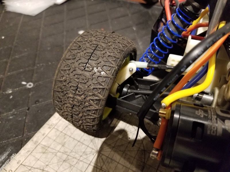

Tried out a clay track today. First time I've been on clay in a long time and I remember how finnicky it is. When the traction was right it's great but constantly changing. Started out wet from watering night before, a couple hours into morning there was a sweet spot. I was using no sauce and it was perfect, just enough grip to allow some slide but not too much. Then it started to dry out and it was getting slippery but I had to head home.
Managed a few batteries worth of running on an empty track with one other guy who had a new 22 4.0. Speed wise I was fine but that thing is just so dialed in turns. Mid engine is tough to hang with, I feel like it hurt our chances a bit with these vintage rigs. That said the car was doing really well. When I could be consistent we were battling, had his car been in the hands of top guy no way though.

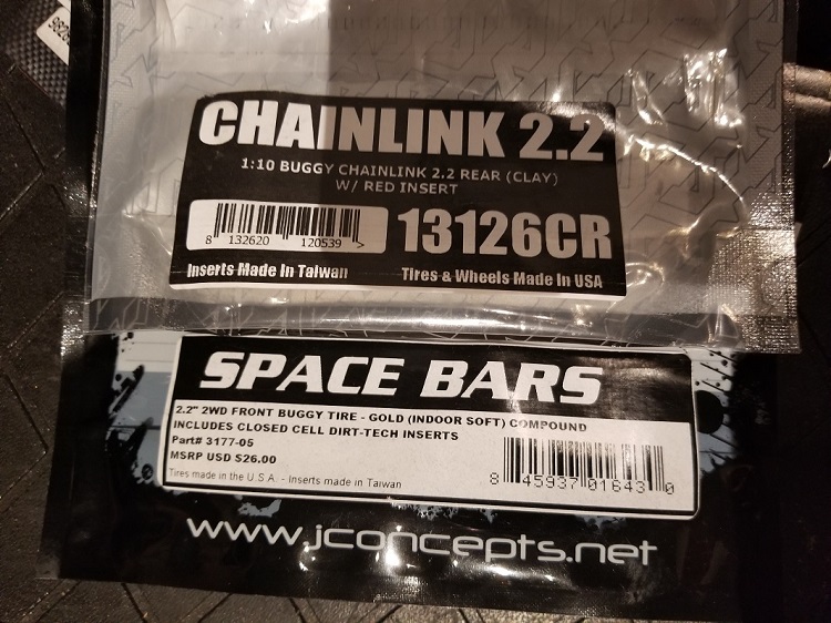

My set up change from turf was to use the tires the track recommended. I was there like 5 years ago and said I used Barcodes, he said, "no one uses those anymore". The ones he gave me look so similar I find it hard to believe there is a huge difference but who knows. I know the clay racers travel with a suitcase of tires it seems.
Blue stiffer rear springs to try and get more front bite. Seemed to help when I went from the silver to blue springs in back. Managed to finally break rear hub. And I am going to switch axle on CVA to ASC9911 for the extra 2mm in length. I found a thread here about it. I did manage to pop the axle twice! Oddly it had never done it once on the turf, but this track had bigger air which I think was the real culprit, much harder landings.
