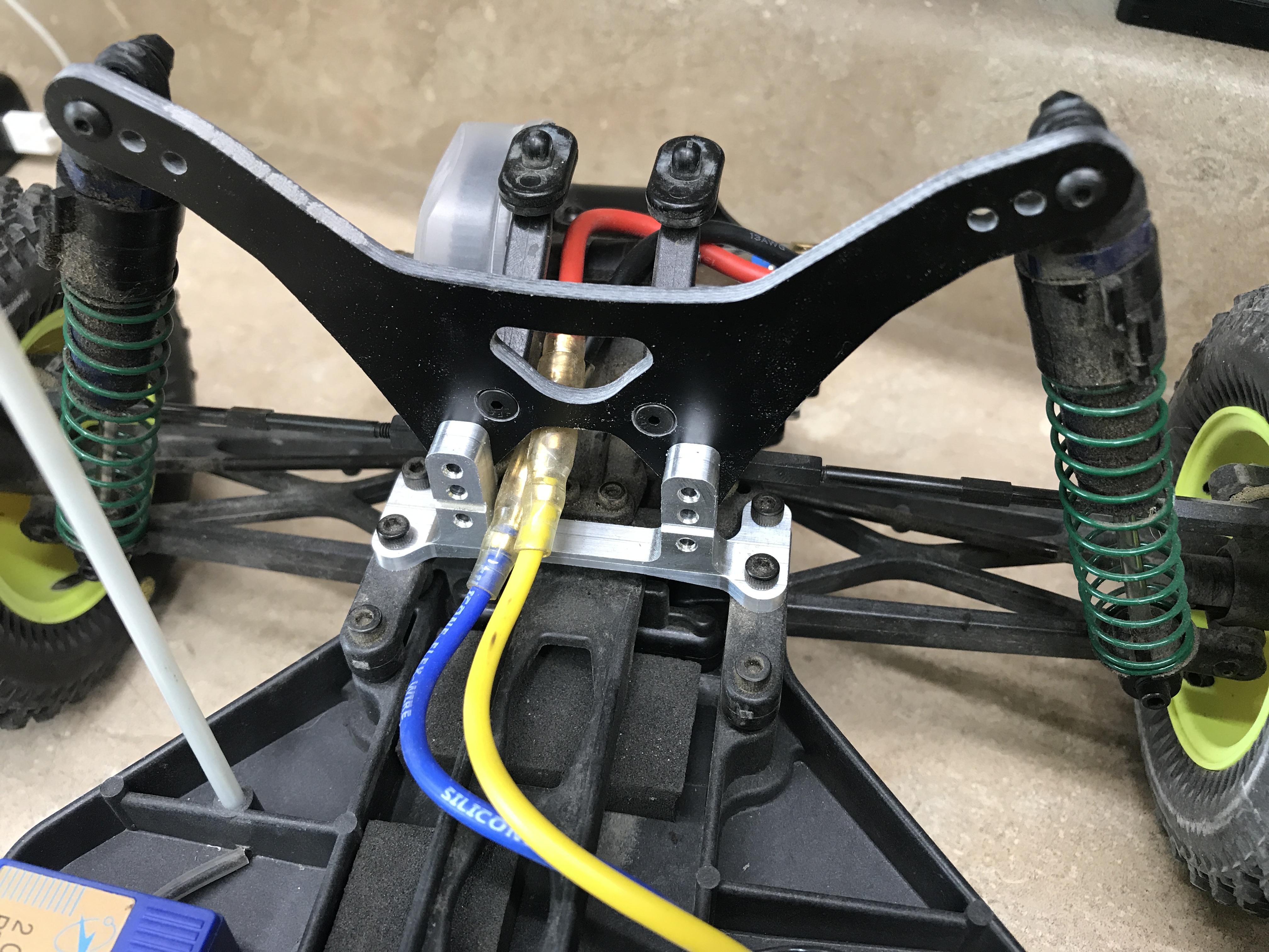

So, it looks like the reason no bodies fit this truck is because the factory team version uses this wide short front shock tower from the sc10. I could swap out the shock tower for a standard 4.2 tower, but then I would also have to change the front "gullwing" arms over to the regular flat ones or the shocks would be too short. That seems like going backwards. I really don't want to turn a factory team truck into a standard 4.2. Ideally, I would like to find the JConcepts body for this truck (also discontinued) but so far I'm coming up dry. I ordered up some spare arms and the body that's on it is new (just don't like the paint), so as soon as my motor shows up in the mailbox, I can start running some practice laps. The funny part to this whole thing is that I decided to set up a 10T as a backup practice truck. I dug through some parts bins in my hobby room, ordered some gears and small misc. parts online and rebuilt the whole truck from scratch. It took me About 4 hours total, with the biggest issue being a lack of pinion gears for the 5mm shaft of the brushless motor I installed, to build a 25 year old truck of the same type and brand as the 4.2. I knew AE wasn't what they used to be, but I never experienced it until now.

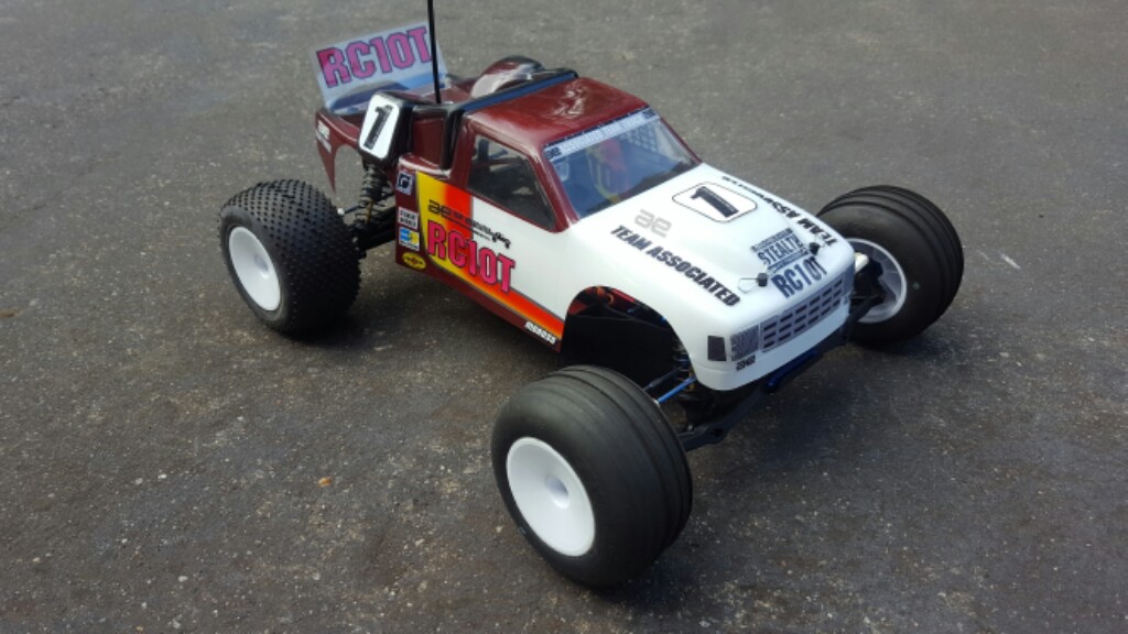

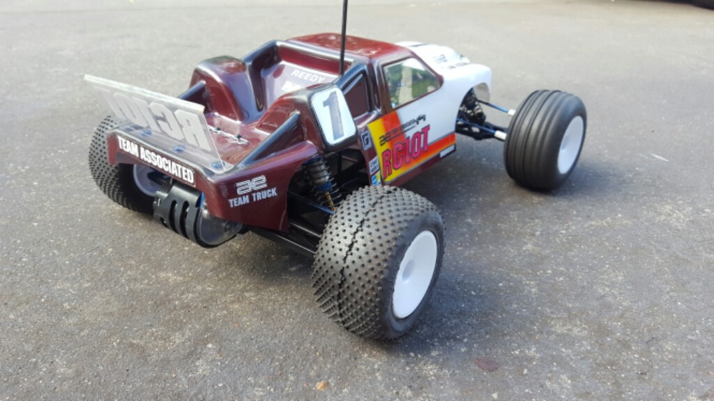

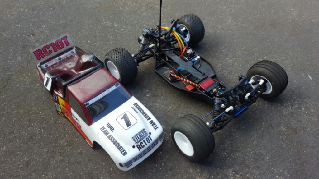

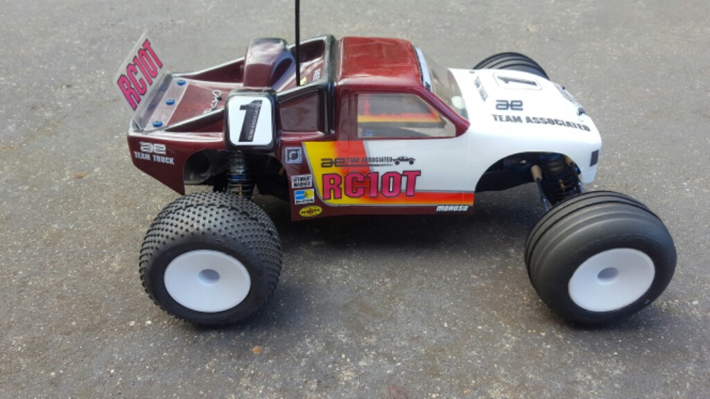

No body is going to fit the T4.2's front shock tower except the hideous cab forward bodies. Sorry to picture bomb your thread but it's to show how the bodies fit. I just tape up the inside where it rests on the front shock tower and where the rear rubs. Admittedly the fit isn't perfect but it works for me and I'm happy with the result.

Your truck looks great! I was down at my lhs/racetrack today. The guy there seems very knowledgeable about the associated trucks. He pointed out the the front arms for our trucks are the exact same as the ones for the SC10B. He had them for $6. I bought them, brought them home to check for myself and sure enough, they are identical. He was running normal type bodies on his and he made room for the shock towers by cutting reliefs in the hood. Didn't look bad at all.

Well, I definitely got the body figured out. A small cutout for the tip of the shock tower on each side of the hood is all that's necessary to run 10T bodies all the way down to a perfect fit with the stock front body mounts. The old body I used for trial and error is shredded so when I get the new body in, I'll post some pics of the relief cutouts before I paint it.

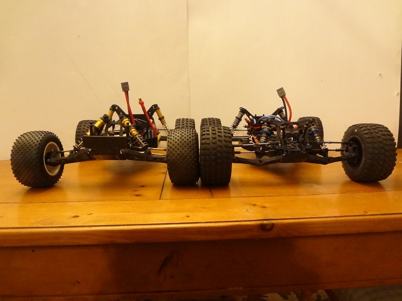

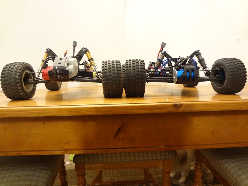

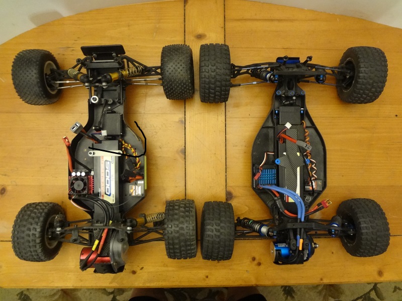

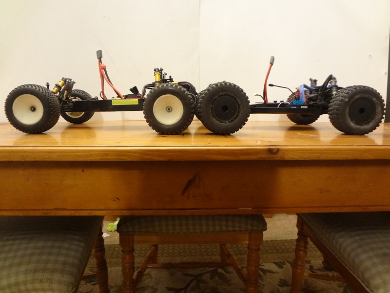

As you can see in these "before" pics, there are a few obvious differences. the ride height is higher on the 10T with a tail high rake. The 4.2 has more rear toe-in and less front toe-in than the 10T. Then of course there is the front end which is where these two trucks separate completely into different worlds. The tires on both of these trucks are my street bashing tires, but since they are the same rear tires on both, I figured they are pretty even in traction and dimensions. The 4.2 has a static sag to 37mm. When compressed, the suspension pushes back up to a ride height of 34 mm. The 10T has no rear sag and sits at 47 mm off the ground out back, while the front sags just a bit and settles to 42 mm off the ground. When compressed, it returns fully to its ride height unassisted.
All of this gives me a starting point to make some changes on my 10T setup. I'll keep you posted on my progress and performance gains.
