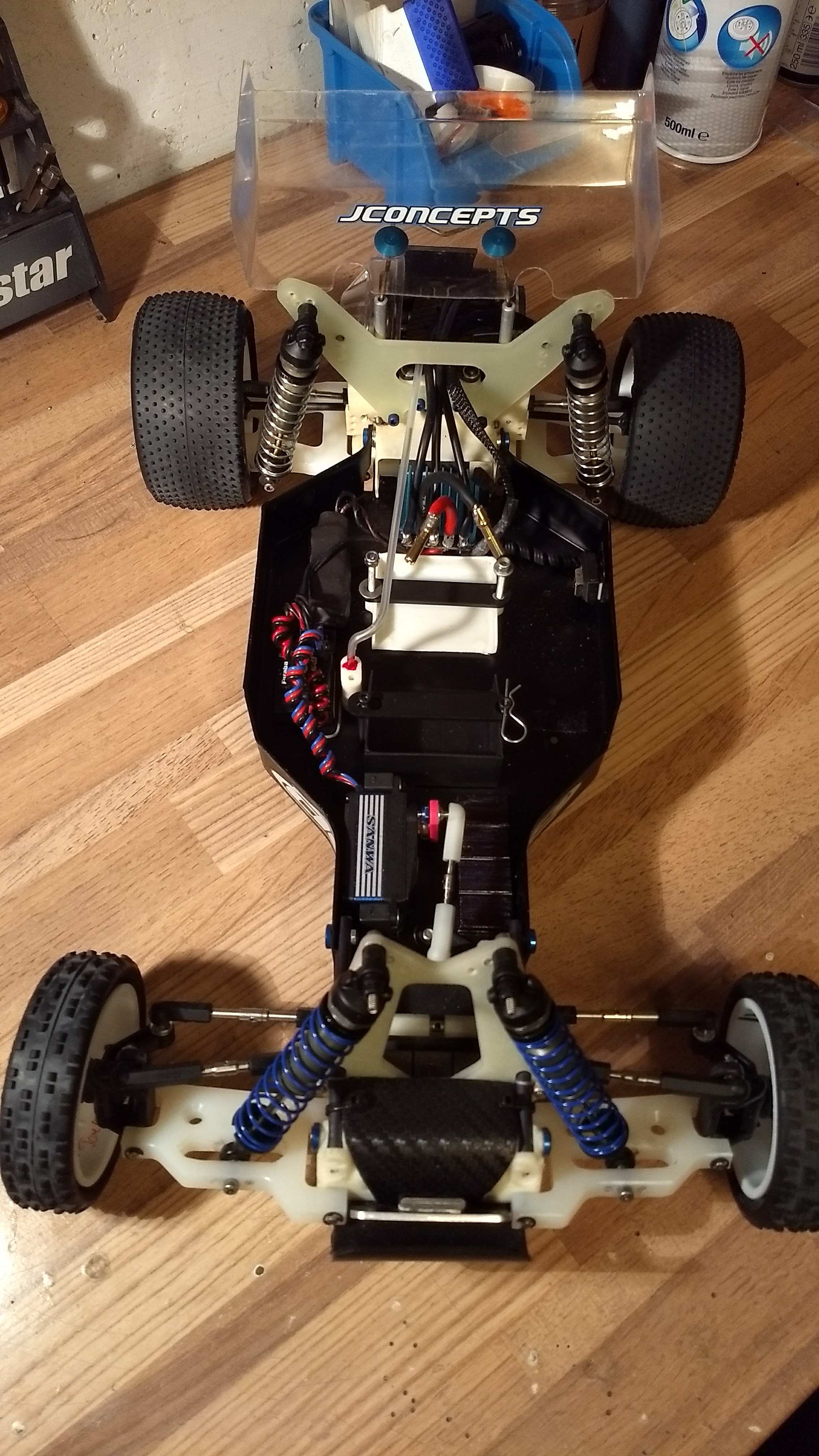

Nice build Paul! What is the carbon-patterned thing behind the bumper? A piece of lexan to cover the half pound of lead you had to add?

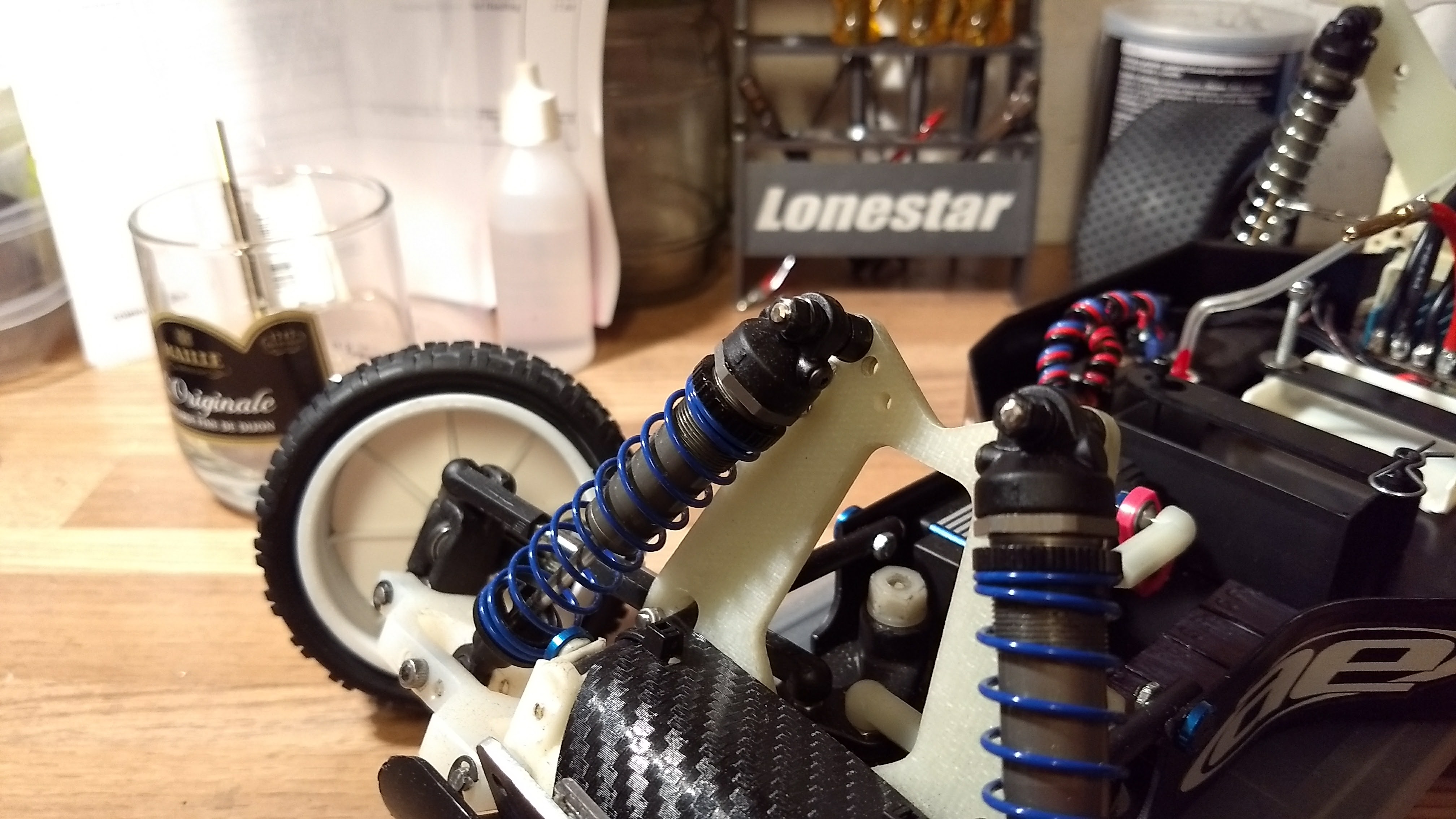

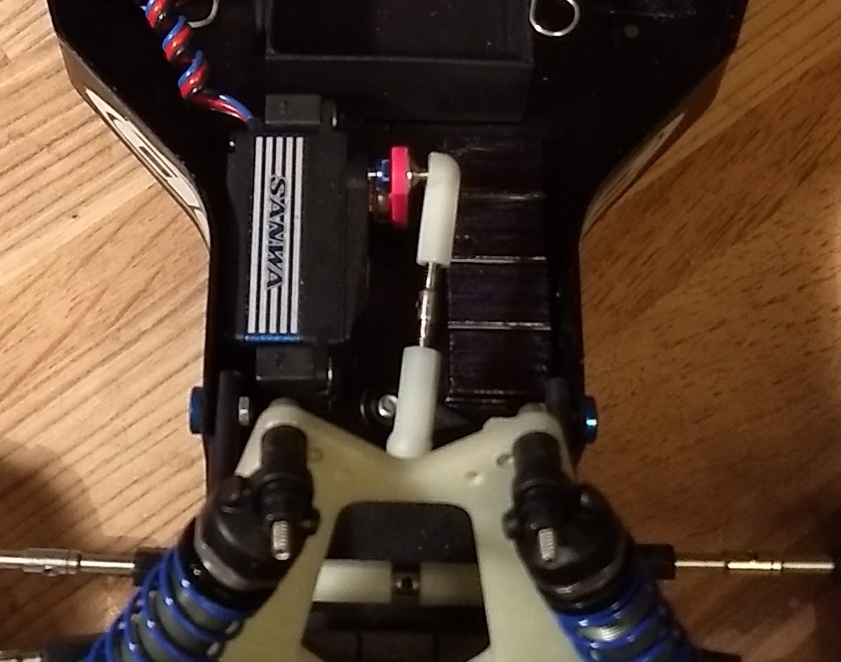

Let's talk shock absorbers now... not many photos from then on as I was in a rush to finish the car before raceday
My belief is, when you get the suspension freed up properly and not too goofy angles, and your diff/slipper comber is, then all it takes getting ok is the shocks to get a 2wd at 95% of its potential
So shocks were next...
As usual with most non-racer-cars, the shock bodies were full of crud, the oil was all murky, full disassembly totally mandatory, and lots of time, paper tissues and brake cleaner to clean up the inside of the bodies, especially at the bottom.New green-slime drenched MIP seals all over are a must, as well as coating the spacers in green slime too ("t's a little tribological miracle" - those in the know will get it
) is a must.
For smoother shock action, you can file the thick spacer between the o-rings so it becomes about 0.1mm to 0.15mm thinner, o-rings will be squeezed a lot less and there will be less shaft friction. It looks like as years passed by, these parts got thicker. I remember reading/viewing a tip article/video with Richard "The King" Saxton mentionning this, too.
The issue with this overall OIN setup is, there aren't that many setups available around. The suspension cinematics are not that well documented, it's never been properly "developed" as a racecar, so you're alone in the dark if you want to make it perform. I figured out it'd be closer to a B4 than a Worlds Car cinematics-wise, so I pulled out an old B4 "carpet setup guide" from the UK from my archive, and I settled on #2 pistons on both ends, silver buggy springs in the back and blue truck springs in the front .
I am not sure which version of the front shocks I have, I am thinking front 10T shock length. In any case, it took a few mock up assemblies to figure out how many spacers inside the shock would be needed - remember we're talking indoor carpet racing here, so you don't want too much droop. You still want to land the jumps properly and don't want too "lively" a car on the whoops so some droop is still neeeded. I figured out 3 thin shims inside each F/R shock would cut the mustard as a starting point.
To please a painful but correct racing buddy, I cut then rounded the edges of the upper mounts to nut cut through the carpet when not on all fours:
Oil-wise, I have honestly lost track of how many front/rear combos I've tried... but frankly the best I could get to was so-so, I never was happy about static performance on the bench. Statically, when it'd feel ok when pushing the car suspension down, it'd be okayish (so oil is right-ish) but the chassis would slap the ground when dropped from 1 to 1.5ft heights, so the piston/oil/droop combo wasn't that right, never. I think I ended up with 50WT up front and 45WT at the rear, knowing it was at best very sub-optimal. I was tired of messing around and figured out I'd set it up at the track on d-day between runs, and play on the shock mount hole on the A-arm too at the track - because there is only so much you can diagnose on the workbench!
Lastly: we're looking at a rear-motor 2wd. Absolutely NO-ONE races this configuration seriously by now on carpet or high-grip surfaces: we've all finally admitted Mid-motor is superior in these conditions. On my car, the shorty is mounted inline for visual reasons (looks good!) but really the front end is stupid light compared to a MM car. Time to pull out the lead stickies. As Heretic pointed out above, there is one leftover of the old cwf-vinyl'ed body tied up to the nose tubes on the front of the shock tower. There is no lead below there, but the previous owner mounted a 7g weight on the nose itself, and already 41g behind the shock tower here:

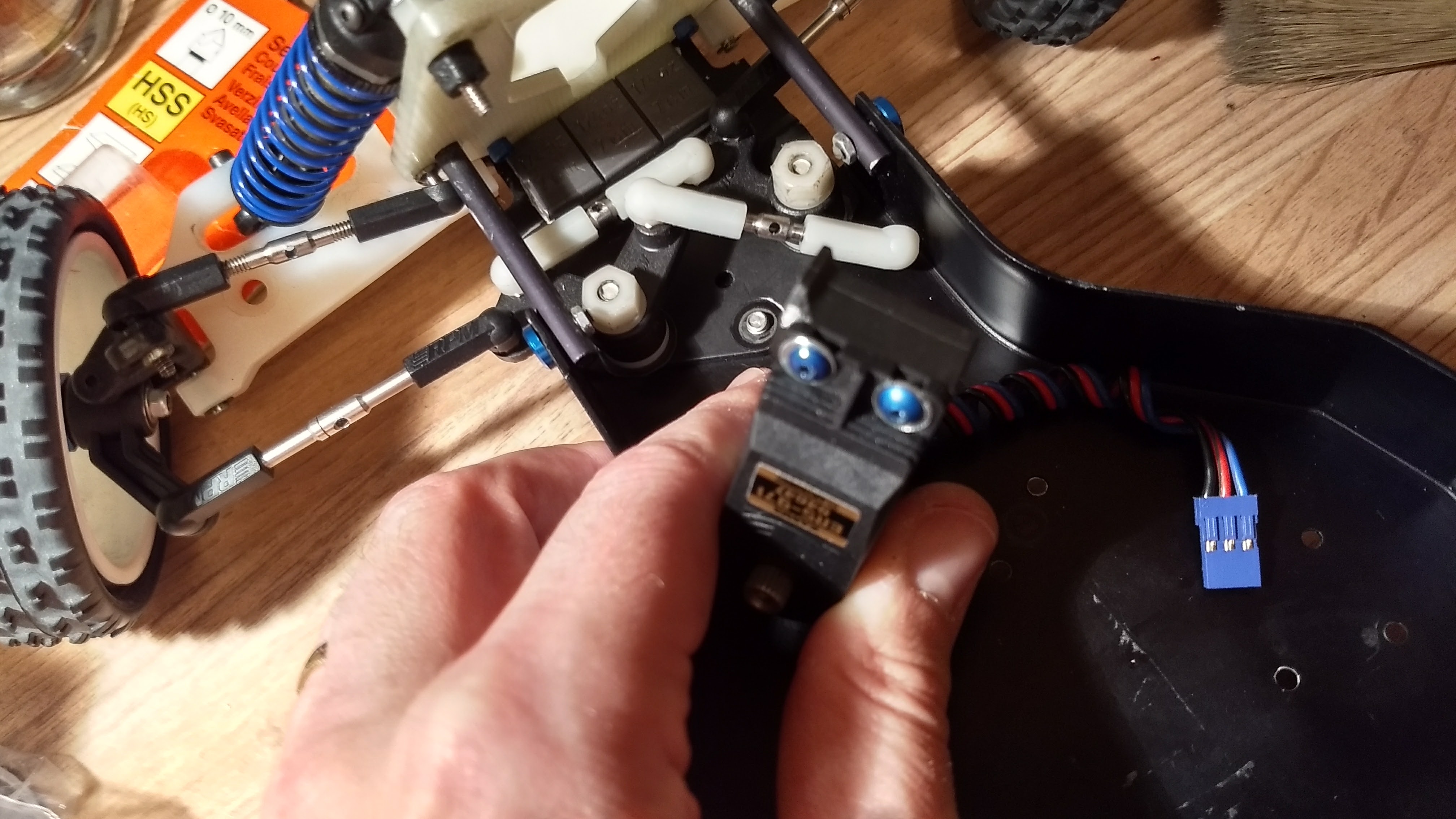

I also added 40-ish grams of lead (sharpie'd black for stealth looks!) next to the lo-profile servo, to both add weight up front as well as "rebalance" the L/R mass (servo is on the right only now).
Net, the car already has about 90g of ballast at the front.
This is not totally senseless given the low-profile (lighter) servo, the (lighter) shorty, and the stupid-light front end

Hey Paul, nice job on the car and good luck with racing. I was never really happy with the suspension geometry of my OIN either. It has to do with the unusual combo of parts and the fact that shocks are too vertical, especially in the back. The fact you can't use the outer shock mount hole on the rear doesn't help either.
For a carpet race, I would redesign the shock towers and put the shocks more at an angle to stiffen it up and make it more progressive.
One question: why don't you reverse the mounting point of the camber ball studs on the front c-hubs. It puzzles me a lot

Asso_man! wrote: ↑Mon Dec 11, 2017 4:33 am Hey Paul, nice job on the car and good luck with racing. I was never really happy with the suspension geometry of my OIN either. It has to do with the unusual combo of parts and the fact that shocks are too vertical, especially in the back. The fact you can't use the outer shock mount hole on the rear doesn't help either.
One question: why don't you reverse the mounting point of the camber ball studs on the front c-hubs. It puzzles me a lot![]()

The other thing Paul that will very much help your handling is to move to buggy shock towers. Since you are still running the truck towers, your geometry is going to be all wonky at best. the old is new is really similar to a B4 arm length and spacing, so if you can get the shock angles closer to B4, you will be that much closer. You can redrill the truck tower to make it the same as a buggy tower, it just ends up with some 'wings' hanging out. the front end will improve having the shock a little more upright as well.

just a regular rear shock tower for any rc10 b1 will give you tons better rear shock geometry.
up front, the rpm worlds tower is a starting point, especially since you have the 1.02" shocks, but Jeff(GomachV) has probably 10 different front towers that guys have sent him to route out, to stand the front shocks more upright.
all things considered, if a person could measure out a b4's geometry, and apply it to a 'OIN' build, I'm sure the performance would be extremely similar.

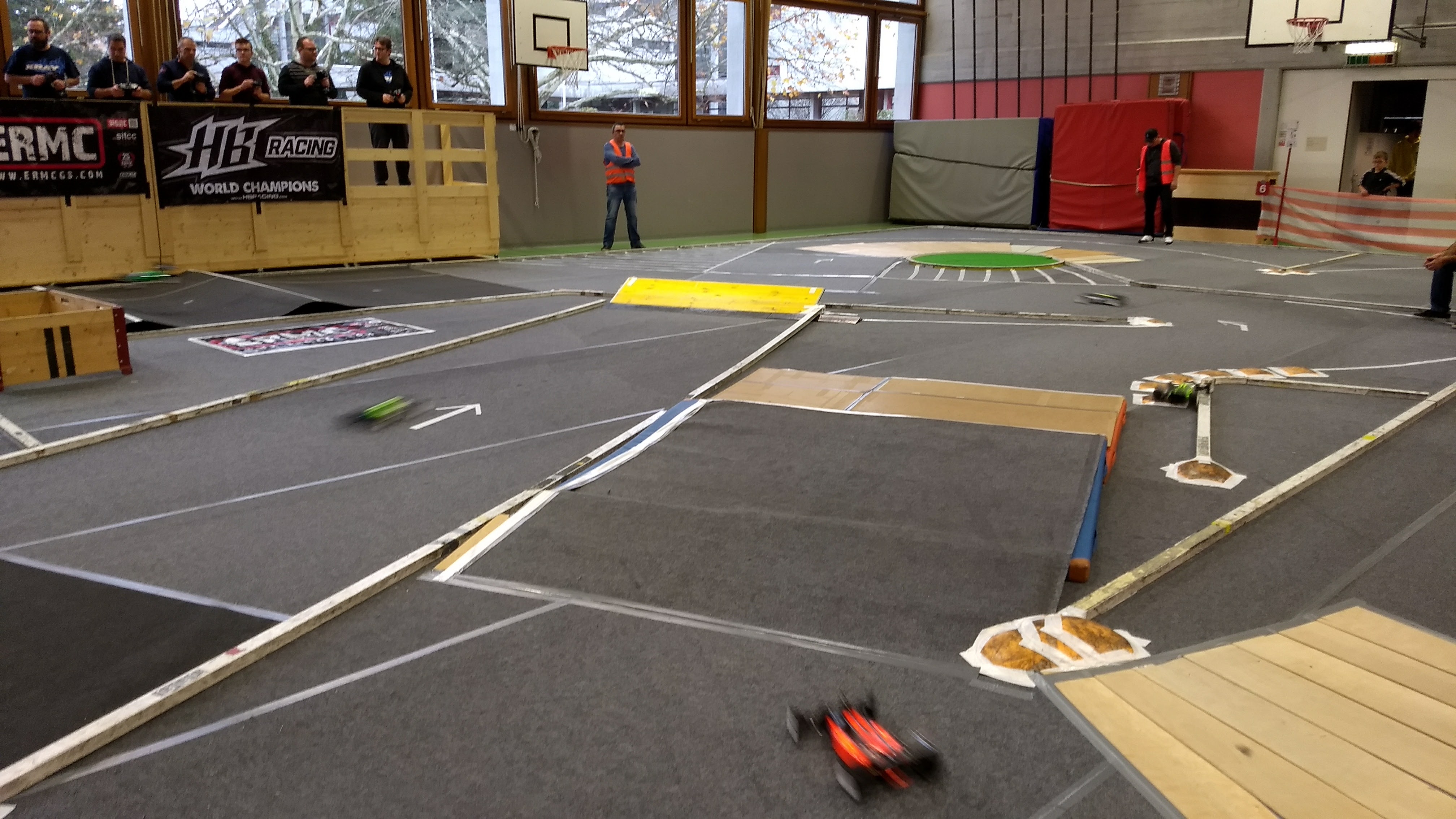

Here's a pic of the track:

Net, about 40 racers. Time to go for controlled practice on a track that no one had ran on so far. Due to my ok performance from the previous years, I started in the fast heat... They should have known better
First impressions are so-so, namely because of poor hydraulics (what a surprise). The rear bottoms out at most landings, which unsettles the car considerably and prevents to lay down the power as soon as needed. Additionnally, the front end washes away in all the tight turns - while the car is surprisingly good in the sweeper with the (mild) whoops. Overall, I spent my whole 5mn opening the door to the top dogs
This doesn't account for the fact that I was marshalled by the wing once, and you can guess what happened: the philistine marshall had never seen piano-wire-mounted wings
so I had to walk down the rostrum to fix the car myself during the heat
At the end of controlled practice, based on the three consecutive best laps, the reseeding puts me in 17th spot, so that's #1 in the C. My laps times are all over the place, but my best lap is in the mid 16's while the TQ-worthy guys are in the mid 14's. The good news is, I had zero expectations
