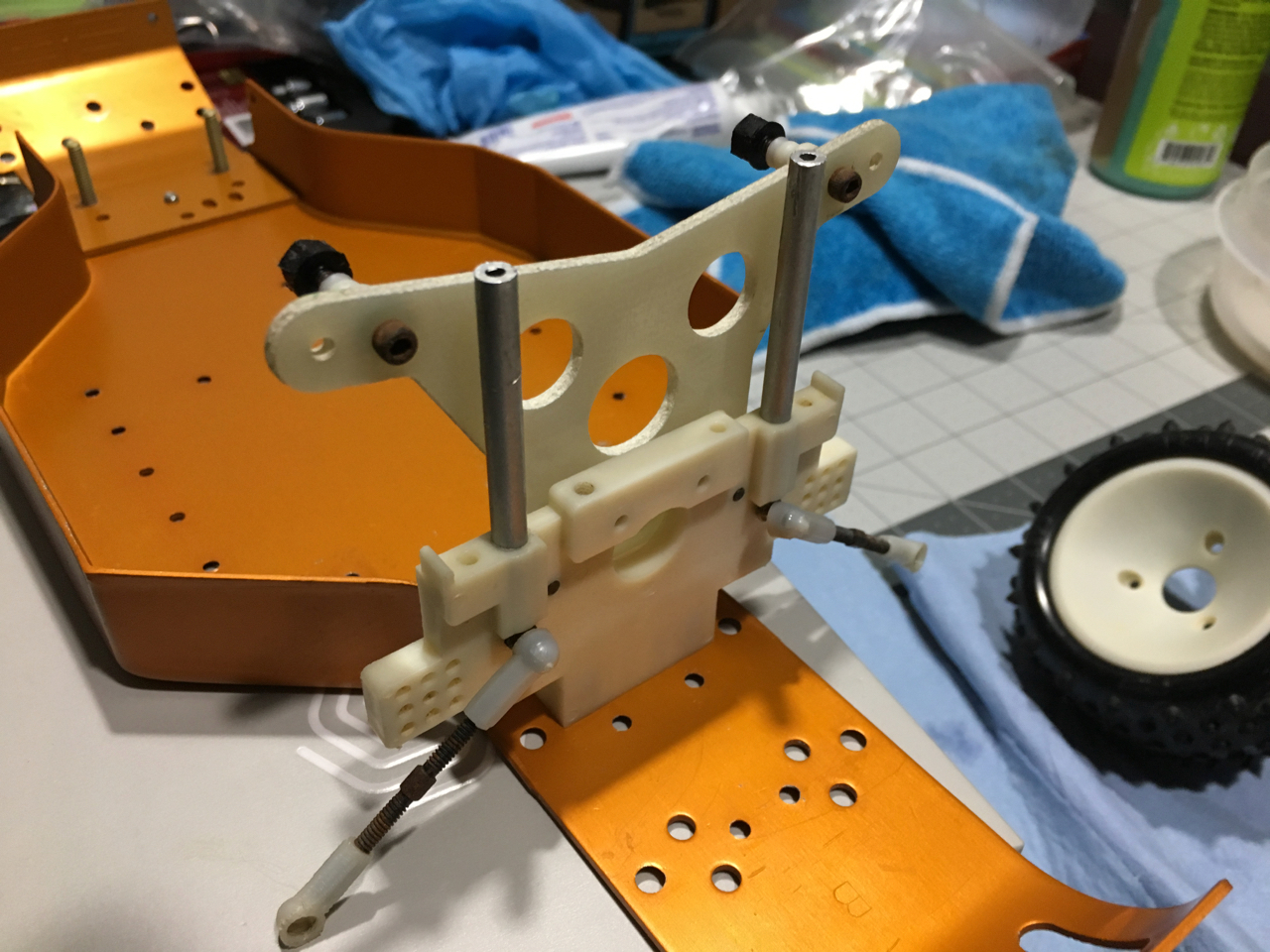

Some progress from yesterday...

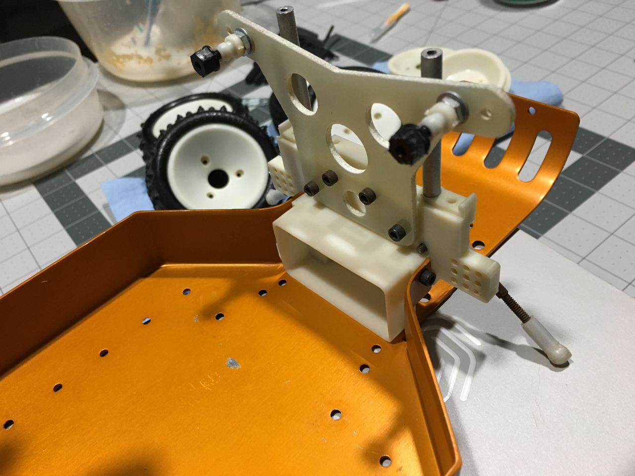

I started reassembling the rear suspension.
Do you folks typically run the arms in the short or long wheelbase configuration?

emmARRpee wrote: Tue Jul 17, 2018 7:35 pm I started reassembling the rear suspension.
The CE was typically assembled in the short wheelbase configuration.
You have it right.
Something clever goes here...
XLR8
Posts: 3307
Has thanked: 1659 times
Been thanked: 1170 times
Re: RC10 CE Restoration
Post by XLR8 »
I like to run short wheelbase for two reasons:
Increases rear weight bias and adds a little more understeer. I run on an old school type loose dirt track so rear traction can be a problem if it hasn't rained in a while.
SWB configuration causes the dogbones to be in-line with the transmission outdrives which reduces friction and wear. Axles, dogbones and outdrives will last longer.

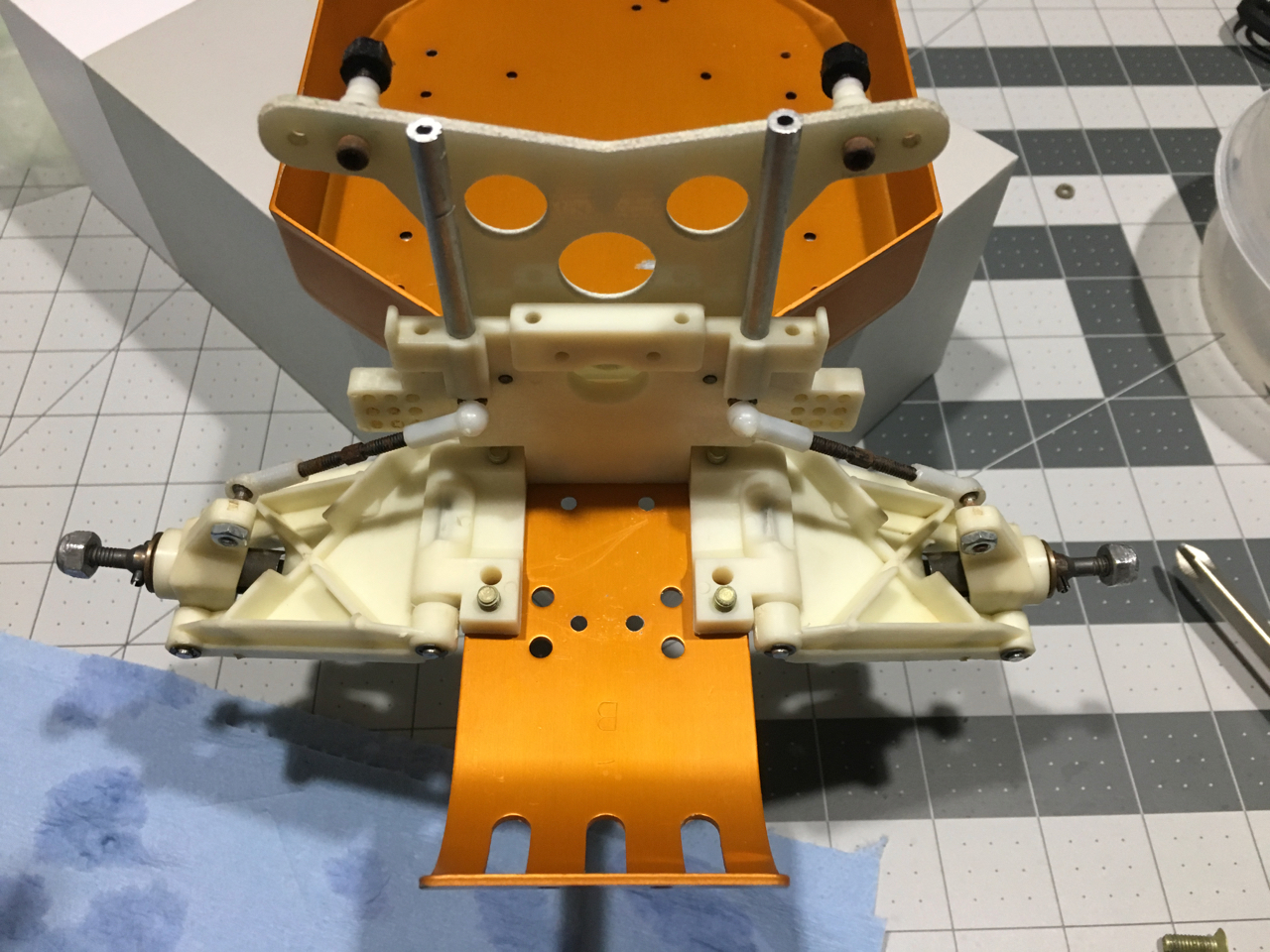

I got the front arms and shock tower cleaned up and installed.

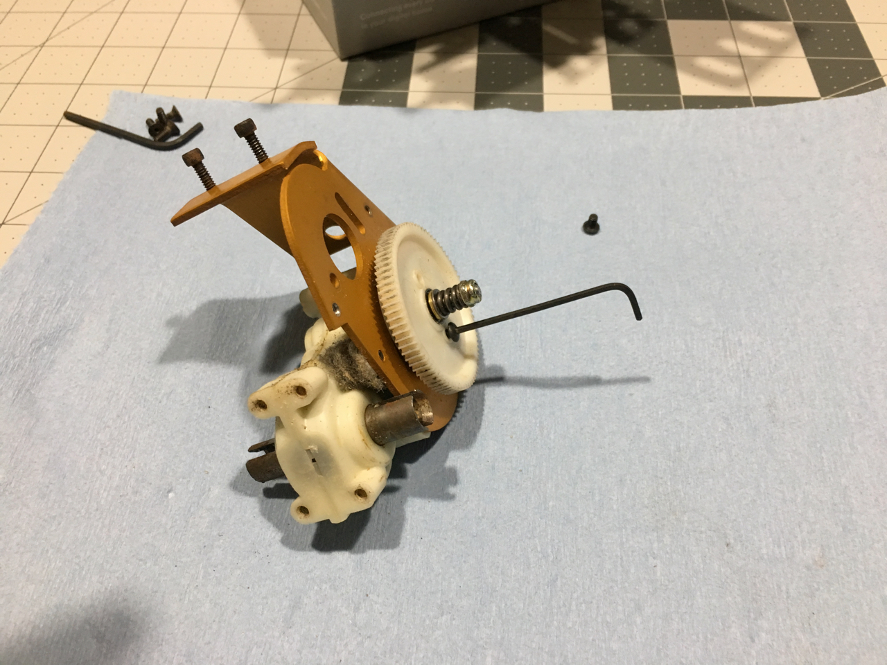

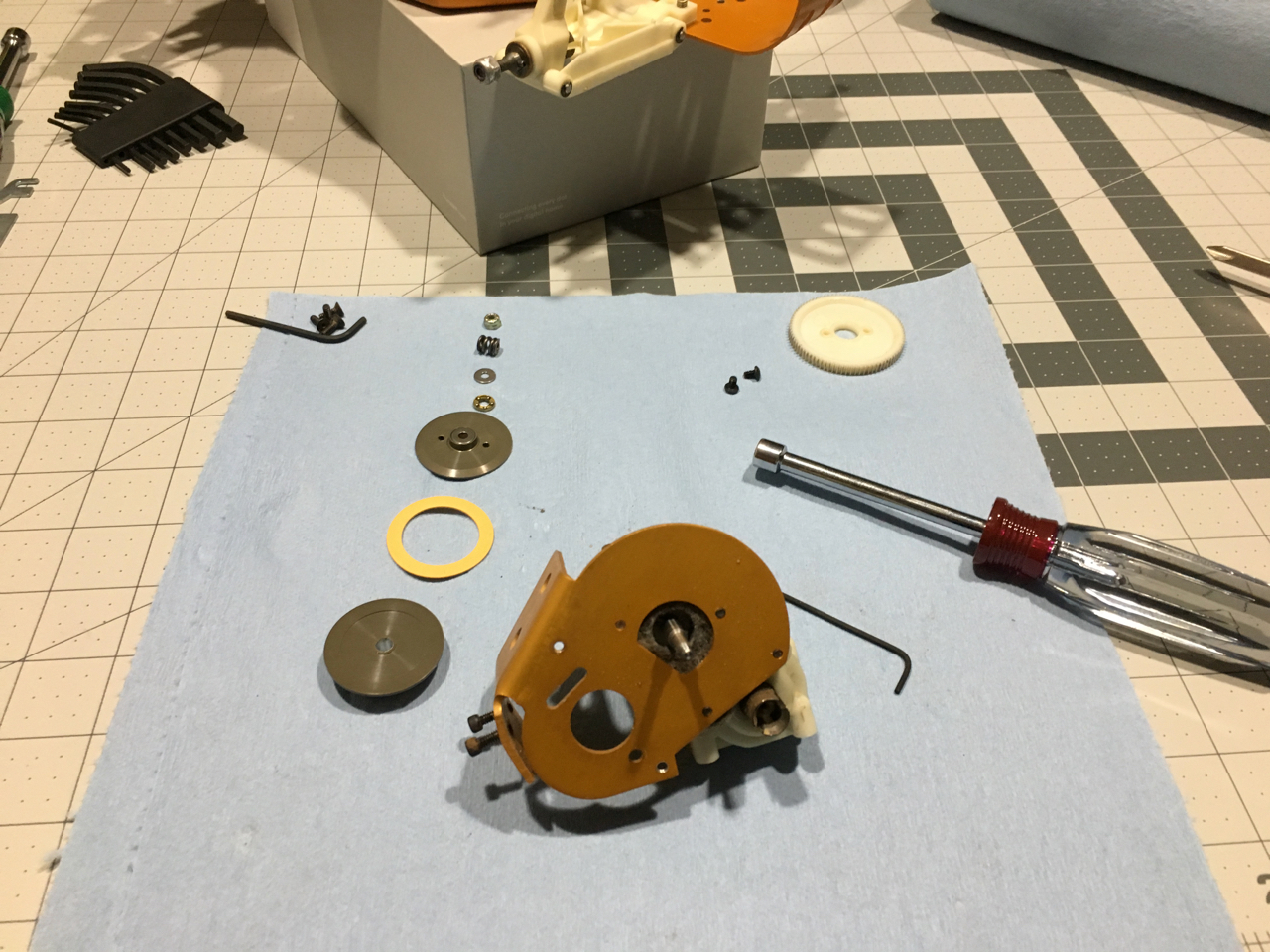

Hey Folks-
So I started taking apart the transmission tonight and it looks like I need to get some bearings to replace all the bushings.
I need a new felt gasket too- the existing one started disintegrating while I was taking if off. The manual describes this part as #6566 felt dust shield. I can't seem to find them available anywhere. I did see one on eBay that is made out of foam.
Also- could someone help by recommending where to get a full set of bearings for this car including the transmission? It seems like most of the sets I have seen refer to the RC10 Classic or RC10 Worlds. Would the bearing sets for the Worlds car include bearings for the Stealth transmission? Or did those cars already have those included with the kit?
Thanks!

For Stealth transmission bearings your best bet, and price is to get them from AVID. They don't have a "kit", you'll have to buy them individually.
