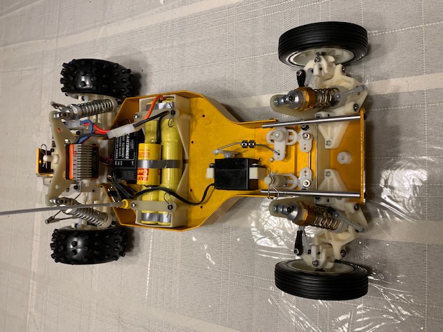

Started to make some corrections and finish some of the assembly and wiring.

Wanted to double check futaba to airtronic plug conversion. It’s been a while, and I’m also not 100% positive on the plug orientation in the receiver.
1) Swap the Ground/Black and Positive/Red wires
2) insert plug with the white signal wire facing outward on the receiver (matches airtronics grey wire)
Thanks limestang
