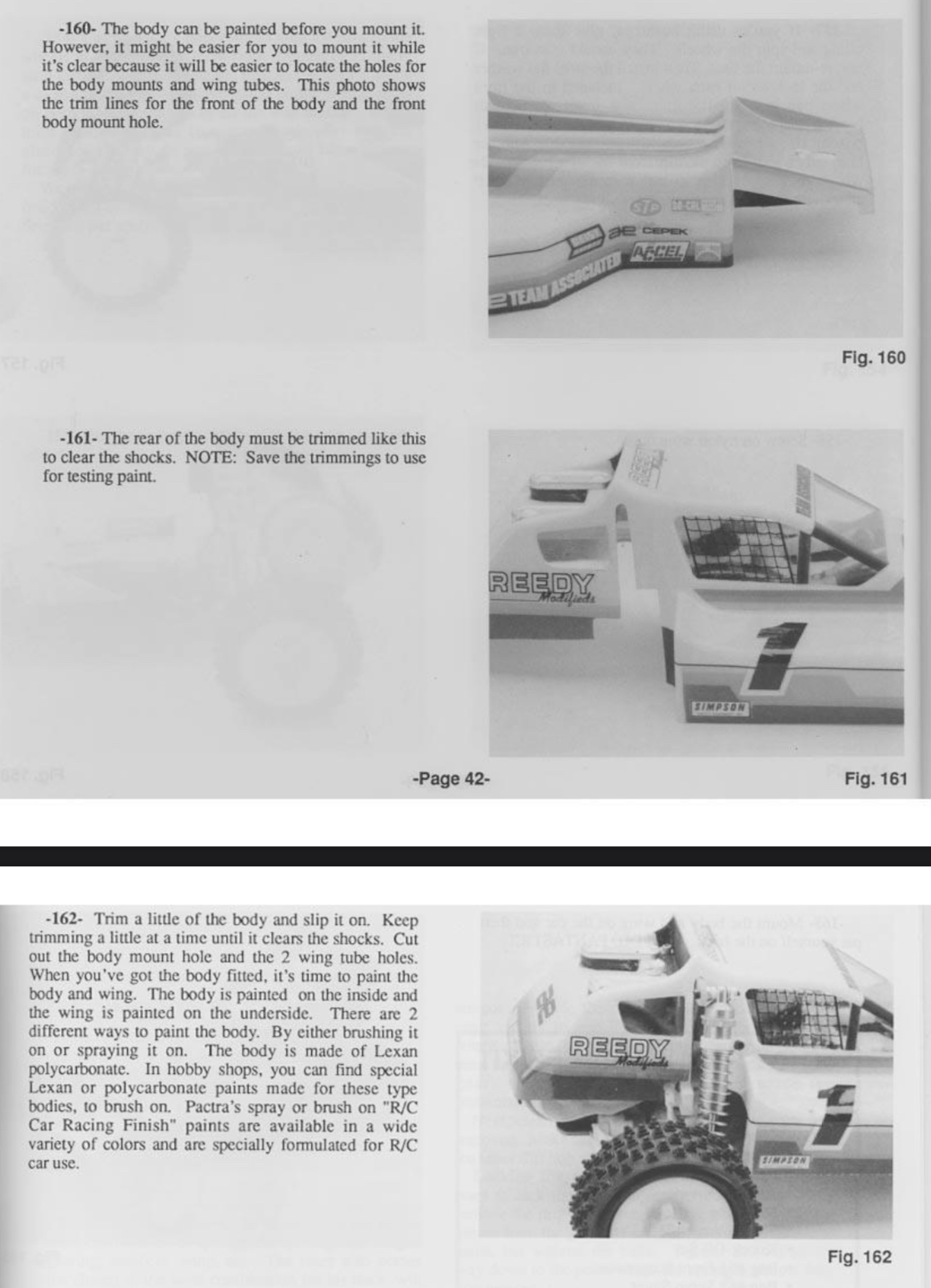

So years ago I bought another body to redo it as I didnt do a good job on the orig body. It has been lost for a while as my wife moved it. Well found it today. it is a Associated Sidewinder #6161 body. Could I get some info about the body and would anyone have good pictures of one of these bodies finished? I would like to see where to trim it. Now I need to try to find a wing for this body anyone know someone who might have one for sale?

The sidewinder body came with the Horizon TQ-10, a commissioned RC10. They cover some tips in the manual but this is about all I have seen as far as trimming reference
In case the pics are blurry, you can find the manual here:
https://img2.associatedelectrics.com/pdf/manual_TC10.pdf
