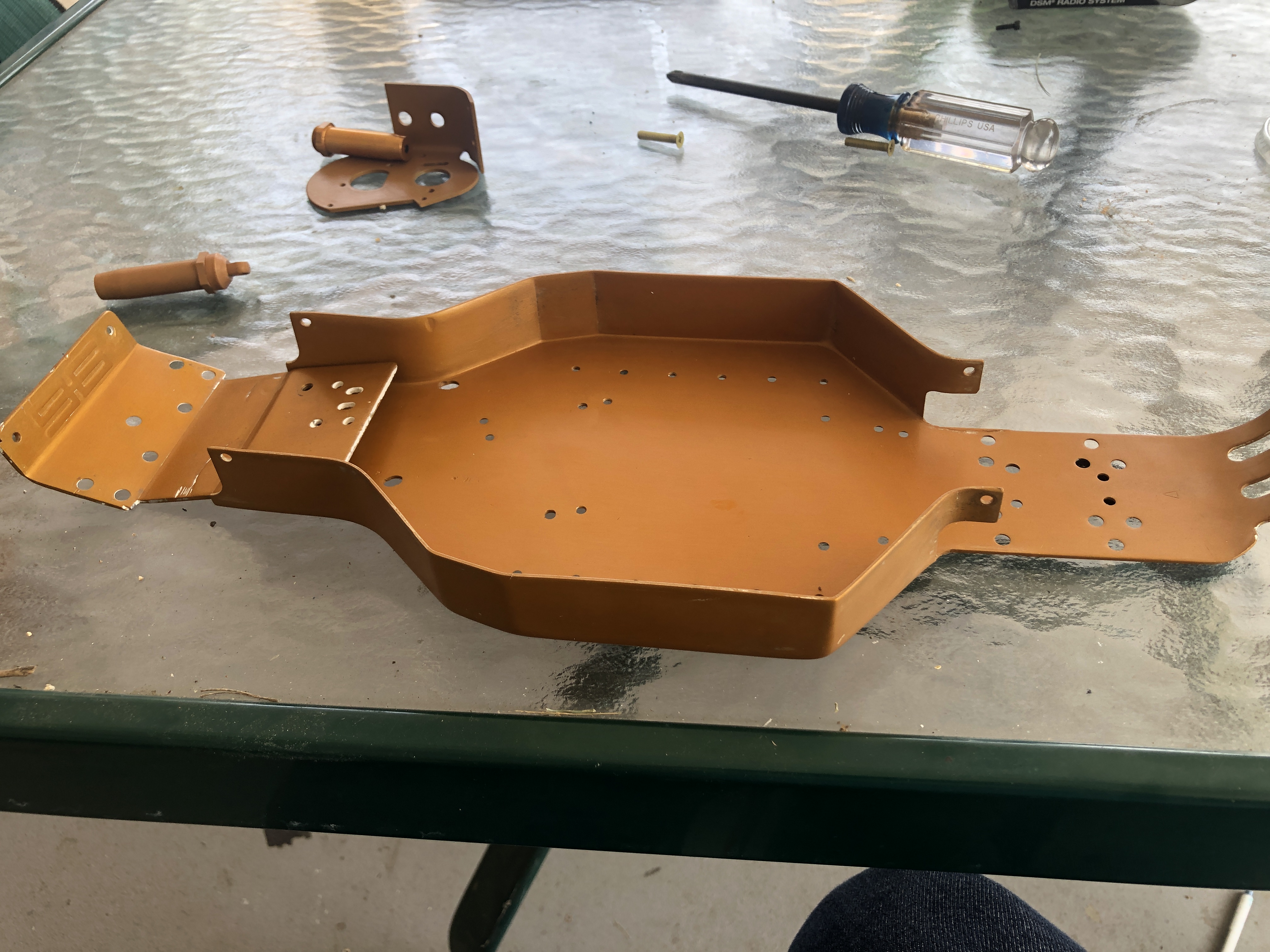

That is weird. Maybe Grease Lightning works differently in your house than it does in mine. Any pictures of the damage that it caused? What happened that was "highly reactive?"
- Posts: 1874
- Has thanked: 1243 times
- Been thanked: 639 times
Re: The cheapest tub pan on eBay
I probably should have said highly 'active'. This is actually working well. Bare aluminum foams nearly instantly like dropping baking soda into vinegar. It's not as active on the anodized parts so it make so all of the scratches pop with foam. That is what I was referring to. This is a reaction is striping aluminum oxide so it has to be a bit strong. There is no damage and this is doing what I was hoping for.
I am liking this method better than the oven cleaner which after 20 minutes did leave clear, but small, pitting on the aluminum, while not clearing off all of the anodizing.

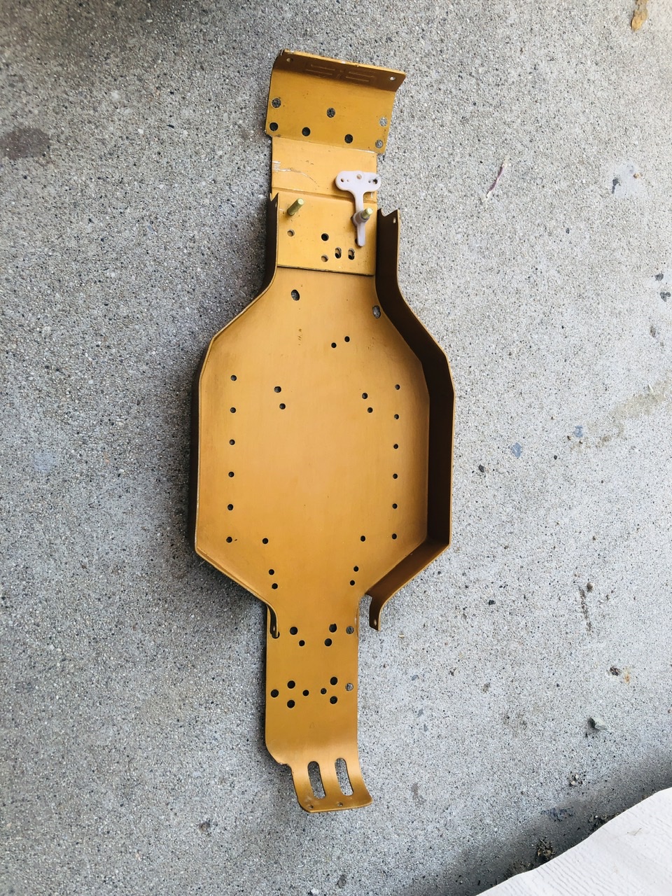

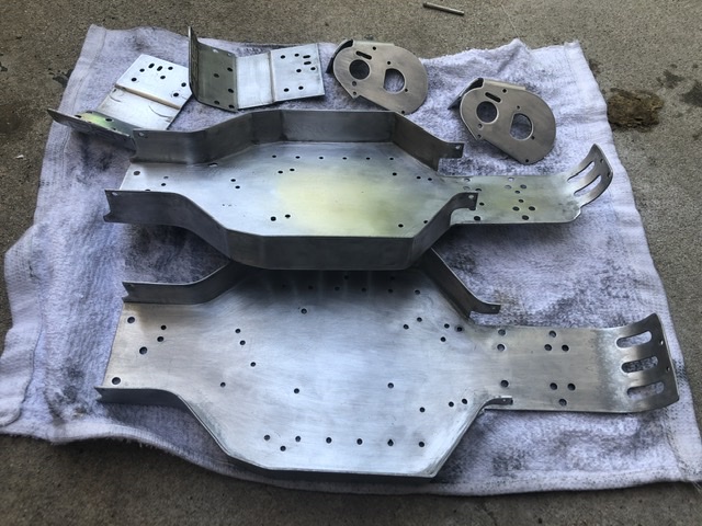

Thanks to your tip I finally have enough parts cleaned up to send off. I switched from a metal container to a plastic one and it worked awesome.
Did your parts come out as clean as you showed?
I had my pieces covered with a black layer. It cleaned up easy enough with some light sanding.

looks good! Like I mentioned earlier, now is the time to improve the finish of the chassis, sand out any deep scratches if you want, and try and get a uniform finish on them before sending them out.
something like a good new scotchbrite pad works great, just remember to only 'sand' in one direction and you will get that brushed finished. if you decided to polish the surfaces (a lot of work) the anodizing ends up kinda like a clear coat/candy.
you could do just a nice wet sand around 800-1000 grit to give it a nice matte surface.

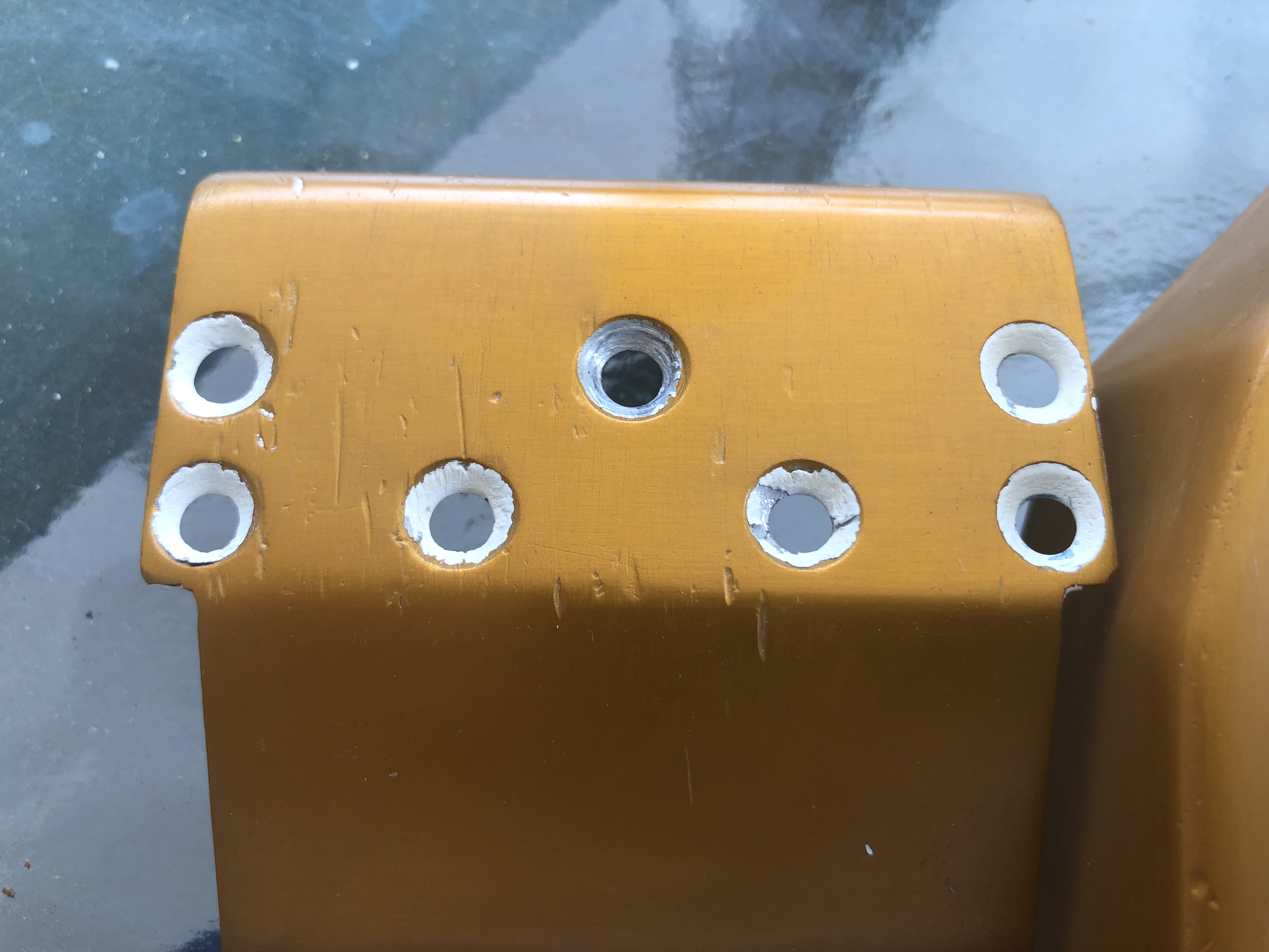

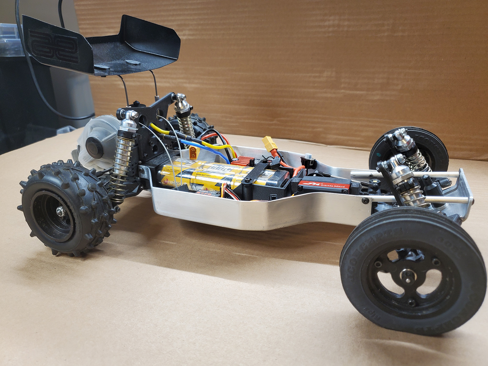

I just got my parts back from anodizing and I am not excited about the color.
I have to say that the pan featured here looks much nicer than it did.
The color is more brown than gold and there are some white crusts around details in the parts that have no dye underneath.
This was my test run on the process for me to learn and I still have more to learn. I am going to work with the processor to better understand how to get better future results.
Based on this result I’ve got more to learn before I try again.

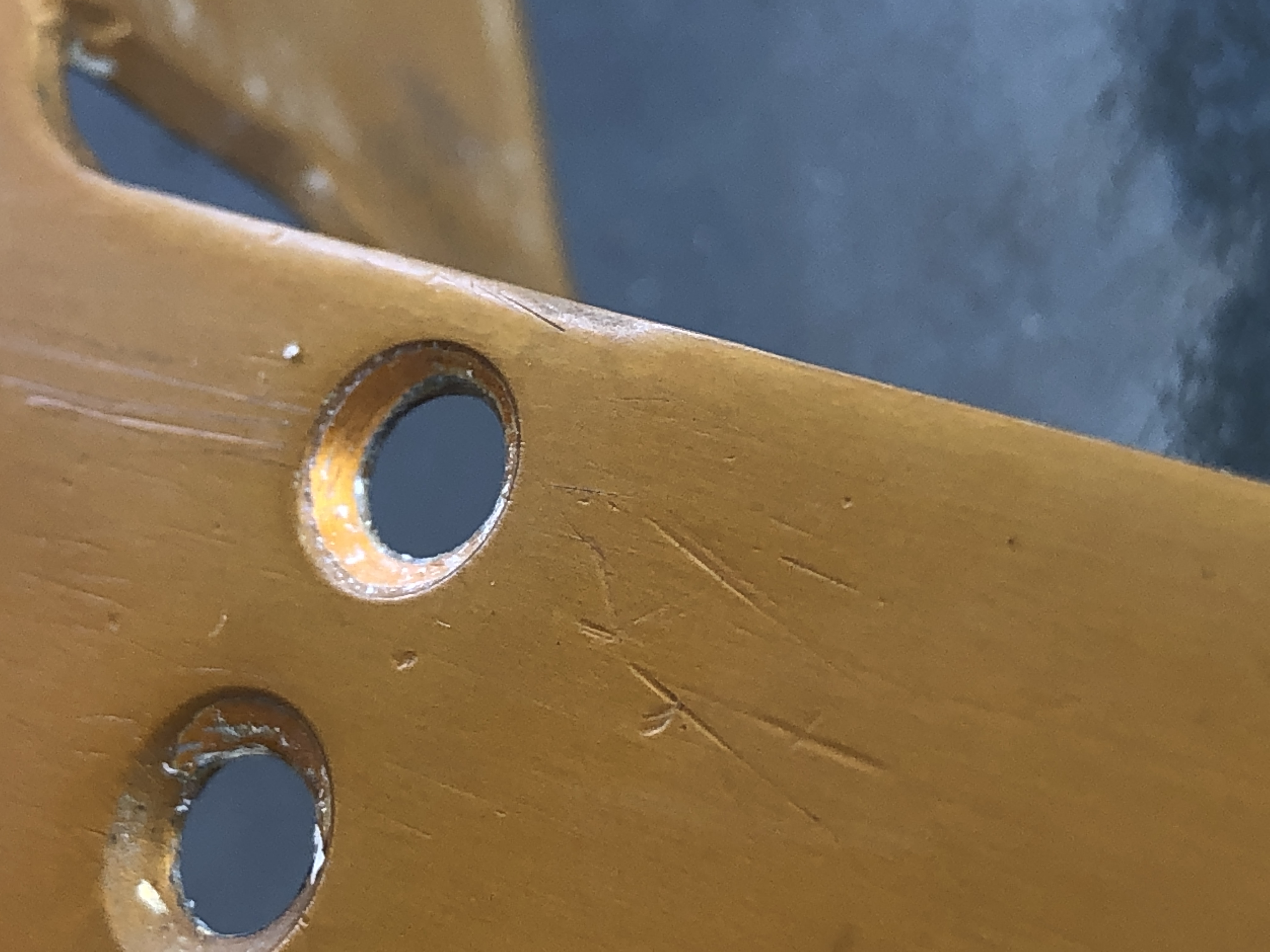

So what I did notice is that on some of the white blisters, underneath is the right color gold.
Now I was pretty sure that I chemically stripped everything before I sent this out, so it’s not likely left over anodizing from the factory.-

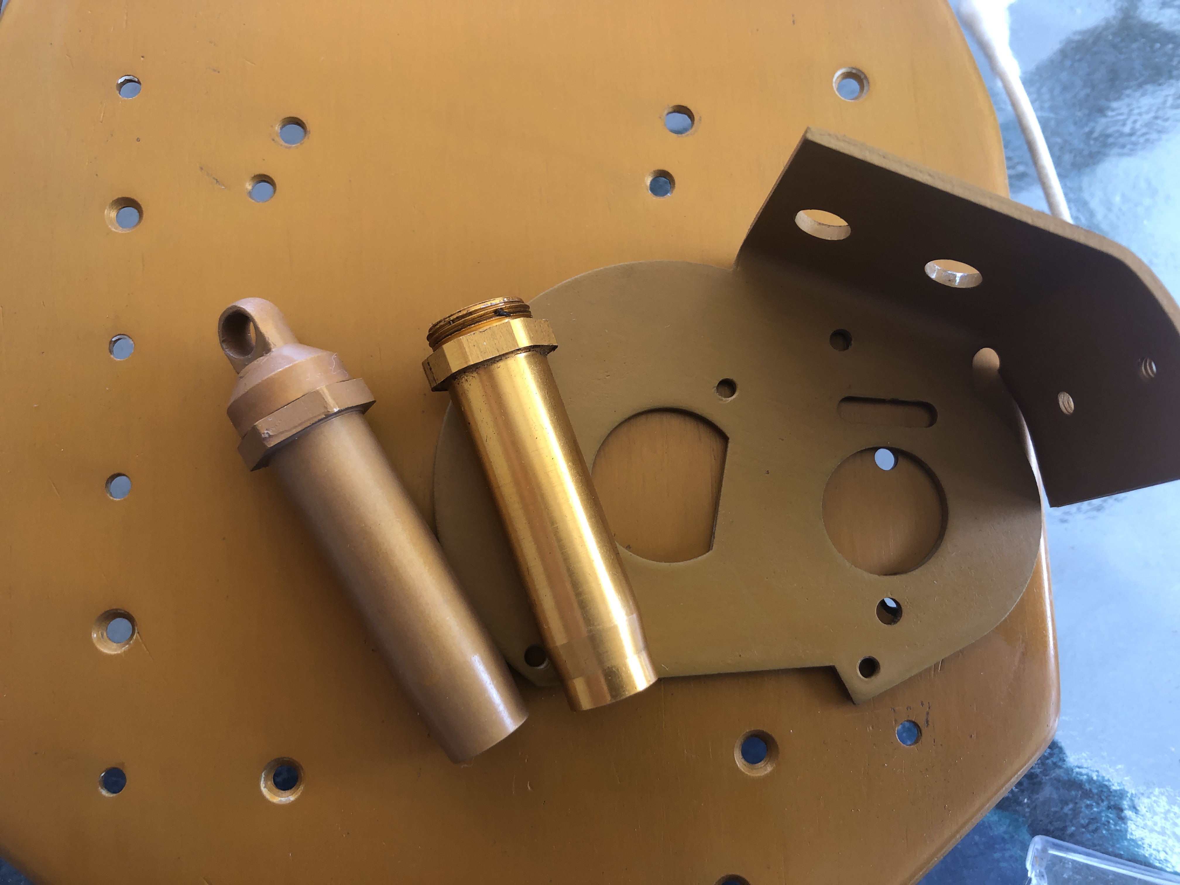

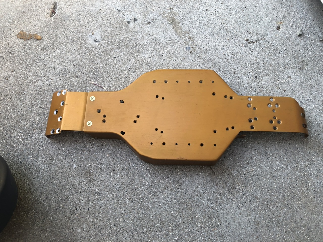

So here are the full results.
These have grown on me as I started building them up
. Going back and looking at where these started I am really happy with the fit and fishes of the pieces even if the color isn’t right. The parts feel new when you touch them. Even though some scratches are visible having them anodized makes them seem not as notable.
I am super glad I had all of the pieces run at the same time. Original color pieces will contract on this. All in all the process, stripping and shipping as well, was $100 for 2 full cars of parts and I could have added another for the same price.
I think I would do this again if I had 2-3 cars to work on. It certainly can take a trashed looking piece and make it respectable looking.
