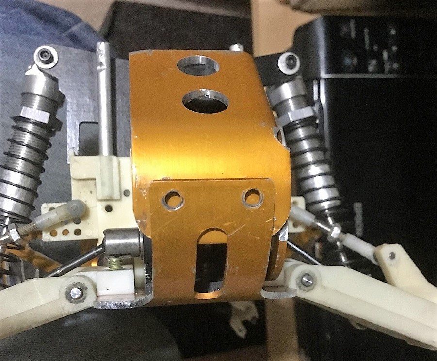

Re: UK Lightweight Racer
Motor plate next, then on to the nose plateMarkyDents wrote: ↑Sun May 15, 2022 3:51 pm Very nice, still wondering what you may do with that big ol’ noseplate….![]()
Awesome

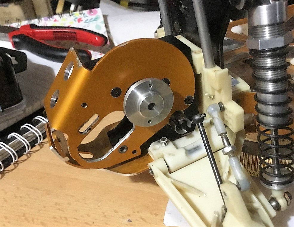

Little bit of rough n ready motor plate lightening to match the overall theme of the rest of the car... It is a bit scuffed up but as it was the original plate which came with the chassis and already had the elongated motor slot I was really keen to retain and use it. All that has been done is the normal pair of holes on the rear facing flat plate have been opened up, the lower corners have been rounded off and the side-bottom profile has had a curve machined into it to miss the gearbox outdrive. Small differences but I am really happy with the result and so now the focus switches to the nose plate....
Nicely done touch

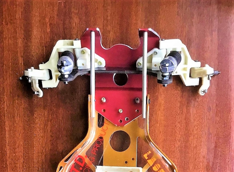

Quick look lightened front-end mock-up just for MarkyDents....
I like it aesthetically (a lot) but it's going to funnel dirt into the car .
Don't worry, i already have that covered
Well your no idiot
Dude !! Way more then I assumed you’d have done !
Your a beast !!
Looks killer and definitely ties it in with the rest…
NICE
