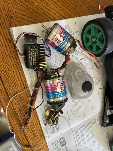

motoromo
Posts: 15
Joined: Mon Jan 02, 2023 9:16 pm
Has thanked: 15 times
Re: Project RC10 graphite…team car?
Post by motoromo »
I found some of the extra parts that came with the car. The round indentations behind the Tekin is a dead giveaway.
Best things I see are the ESC and cover. Motors look beat.
