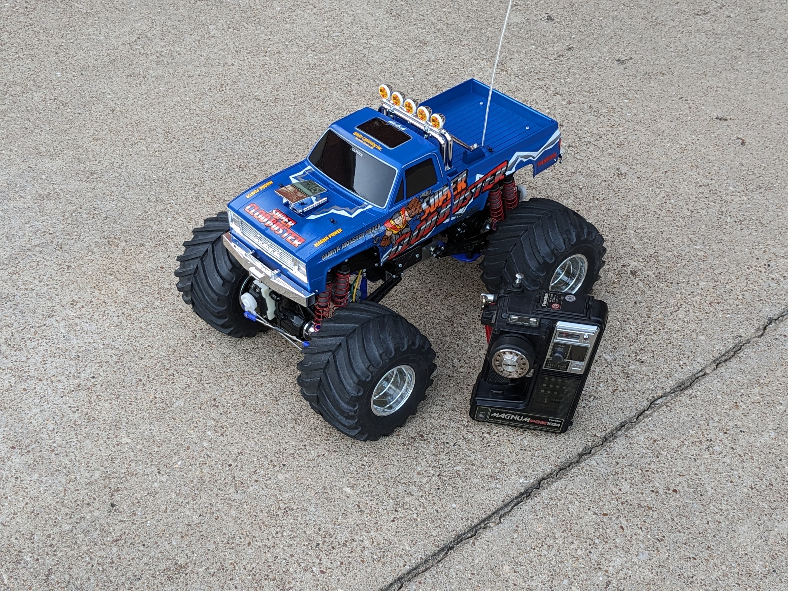

Dang painting! My final coat orange peeled! Aargh! I should have left this thing the molded white.
- TRX-1-3
- Posts: 2070
- Has thanked: 2066 times
- Been thanked: 992 times
Re: Super Clod build with a few mods
Any areas that didn't orange peel? Wet sand with 1 billion grit and some rubbing compound to even it out/shine it up. Watch the high spots/raised details. Or there's the oven cleaner strip and start over. I can feel your disappointment from here. Any success I've had with smooth paint on styrene/ABS has been luck. Too heavy, it runs, too light, it's grainy, somewhere in between, it's orange peely. I've had some favorable results with a low/low hairdryer setting to help the final coat "lay down". All my mediocre paint experience comes from rattle cans on 1/25 and 24th scale static muscle cars though. Anyway, chin up, good luck.Frankentruck wrote: ↑Tue Mar 26, 2024 12:35 pm Dang painting! My final coat orange peeled! Aargh! I should have left this thing the molded white.

Got the paint good enough to put stickers over. Finally done. Take a pic, go run it, flip it, and scuff it up!
Really, I should have left it all white plastic. It will have plenty of white scrapes soon enough.
The rear steer definitely addes to the maneuverability.
